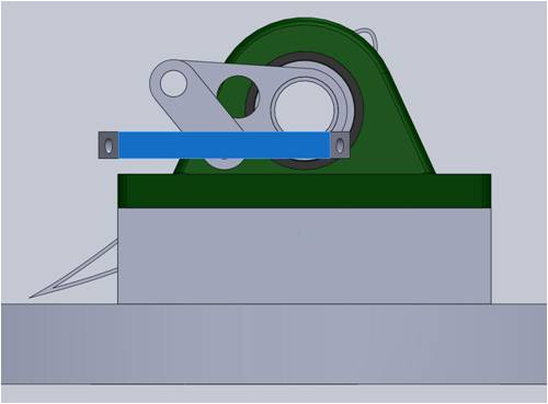

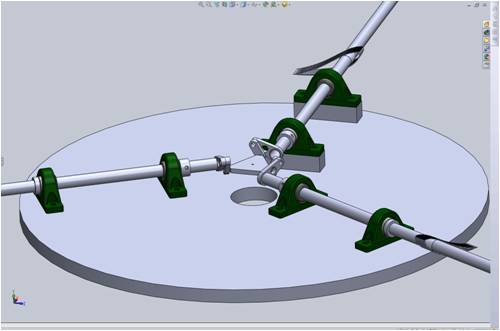

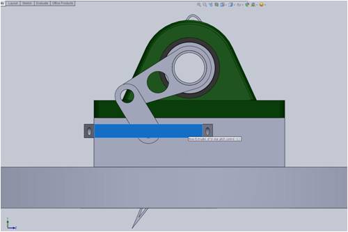

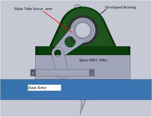

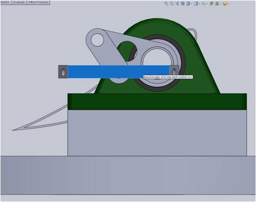

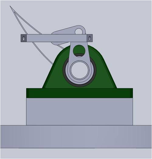

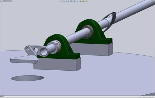

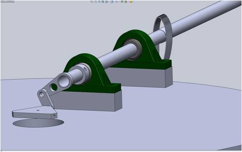

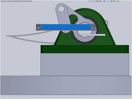

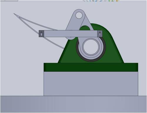

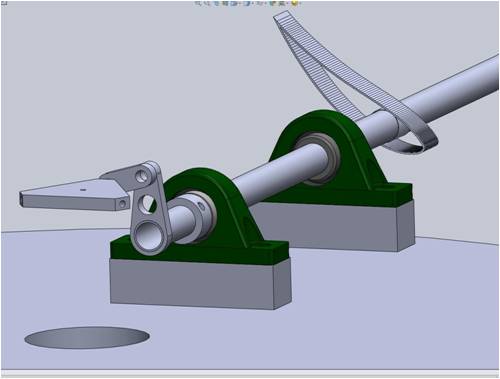

udsn
Joined: 15/12/2010
Location: Jordan
Posts: 9
Posted: 01:04pm 27 Feb 2011
Dear All , thank you - Rastus & Oscar4u
Dear Fillm where did you get the industrial fan hub -head?
As some one has advised me to start a thread just for 5 to 10 Kwatt windmill system I will.
But for now I will share pics of a feathering system since this thread is about blade angles general idea, welcome notes.
I hope its ok to post so many pics
Best regards

udsn
Joined: 15/12/2010
Location: Jordan
Posts: 9
Posted: 03:36pm 27 Feb 2011
Well thank you all again.
I preferred the horizontal system as you have noticed because
1- I won’t have to worry about wiring going into and out of the Rotor/hub.
2- One thrust bearing at the tip of the controlling rod that goes through the inside of the main Axel Tube to control the Main blade pitch controller micro hub , I can put any system I want electrical or mechanical to push pull the control rod.
3- Also seen this very nice pitch control system which I thought is fast. And I can sense it if I wanted. And I don’t have to do the calculations of centrifugal forces,also if the RPM goes too high micro controler stops the main rotor , ues i do intend to put a braking system, not to mention the small extra weight of teh balls, also one can do an optimal angle verses RPM control along side wind speed via the controller chip via algorithms.
windmill blade pitch control
Even though Rutus or Oscar pointed out for me that mechanical is NOT high maintenance as electrical or stepper motor control. What do you all think?
I tend to agree with them both.
My first intention is small electrical motor just like the video, which some one nice has donated three hand held Drills that are geared and clutched and work on 18Votls.
All I need is an enclosed sensor/potentiometer (we dont have them here) and some one nice or crazy enough to do the PIC for me for FREE.
That doesn’t mean I will not use pure mechanical I keep my options open.
Hope to hear from you all.

Oscar4u
Joined: 23/02/2011
Posts: 42
Posted: 07:55am 28 Feb 2011
Hello Everybody
if one puts stops on the mechanical govenor it should make it easier to get it right.
I think that design of UDSN needs a slide because the linkages will jam I suspect.
In the last week through reading this site I learnt about self furling tails. If I do mine like that it will have a rope or lever to pull it square to the blades.
Someone was mentioning a 19m tower. My waterpumping mill is a 6m high A frame tower. The top of it has a bit of 50mm pipe on it vertical in which I slip a 40mm pipe with a bend. From this I hang a rope four to one block so that I can pull the head and blades up. Works really well. Cheers Oscar

udsn
Joined: 15/12/2010
Location: Jordan
Posts: 9
Posted: 08:38am 01 Mar 2011
Dear all thank you for the reply.
I truly appreciate the input.
Oscar I think that design of UDSN needs a slide because the linkages will jam I suspect
I will draw the slid to see if we are talking about the same thing slide wise.
Rastus With your limited resources its only logical to use as much as you have
readily available.
Well I want to make the windmill any where from 5 to 10 kwatts if I can ,
The gen set is around 300 US dollars.(they tell me) and it’s a normal gasoline gen set - to take apart.
The inverters is around 2k dollars for 5 kwatts and arroun 4 to 5 k dollars for a 10kwatts. if not more.
So the price for the PIC is nothing including the programmers work compared to those numbers.
Rastus Sadly though a mechanical governor could prove cheaper and more reliable in
your application.
I agree, totally. The problem I face with governor is I don’t know how to make it, (will draw from Oscars pics and psot ) and most importantly how to calculate it especially that I am un able to estate the wind speed or the final RPM of the windmill rotor. so no way to even get a ball park figur if the size or the length of the rods for the governer.
Rastus I'm not familiar with large storm events in Jordan.
There are none, maybe some very rare occasions mostly sunny.
Rasus Do you experience more thunder/flood storms, dryer/dust storms or mainly Gail force winds? Knowing this will influence replies to be more specific to your needs.
I would say mostly calm slow rarely Gail winds.
I would consider building the gen set with magnets and stuff , but not enough numbers and i dont think the magnets are sold here.
I just want to get rid off those blades invested a lot of money for something that is not selling.
I will tray to post the pics of governer and the slding arm .
have to get back to work
hope to hear from you soon
