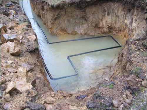

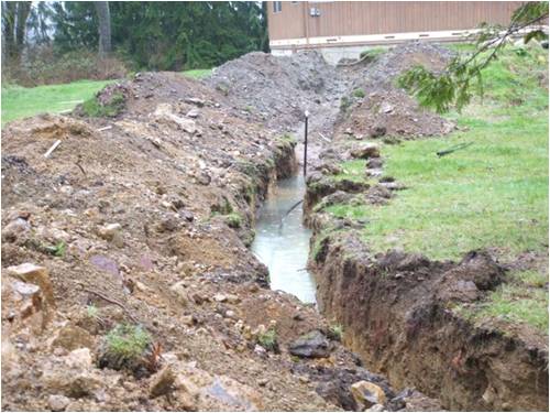

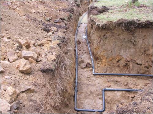

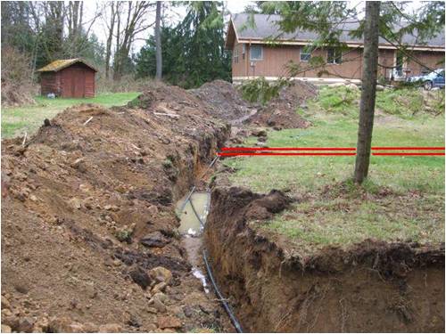

  Greenbelt said   RossW---Impressive- !
I don't know what size your finished house will be but for sure it doesn't matter, you have enough system installed for a School House. great looking work also.
BTW your building site is not to shabby either. (Thinking out loud)
With 5250 ft. of pipe you have between 6.5 to 7.5 tons of heat exchanger here.
That's 72,600-84,600- BTU. 21.3 - 24.8 kilowatts Equivalent. I'm Gona be Sick!
Thank you for sharing this. Keep us up to date.
Regards, Roe

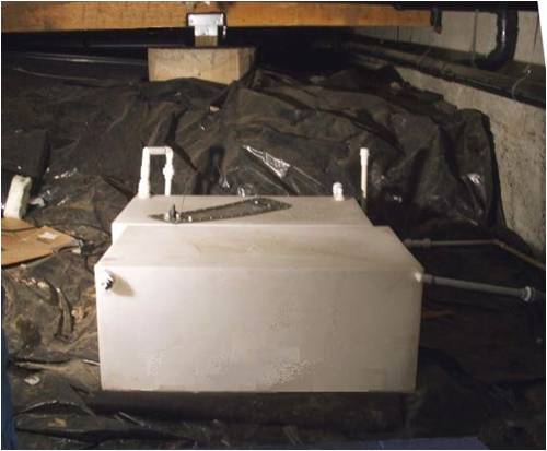

Thanks. The place is moderately large at around 8,800 sq ft (88 squares). The photos above were taken during construction back in 2004 - we've been living here for 5 years now :)
There are/were some technical issues with approvals and permits and plumbing compliance etc - typical inept government types and regulations without knowledge etc. Because the two 2000 litre hot-water storage tanks were "uncontrolled heat source", nobody would touch the heatpump or solar input side, and if I did it myself I couldn't get the compliance paperwork required in order to occupy the place. The cost of the heatpump units was another major shock - a ordinary, mass-produced airconditioner with inverter-driven compressor was around $1100. Similar sized water-to-water heatpump units, without the nice inverter-drive were ten times that price, plus freight!! Talk about "price gouging"! So, I've resolved to wait until either (a) there are enough people wanting them to drive production up and prices down, or (b) I get enough time/interest to make one myself.
My latest plans for world domination, are to make a heatpump unit, and to use the outside loops for heat in winter, and a second "heat exchanger" in the ceiling for summer - suck heat out of the house, condense water to reduce humidity, and create the hot water we need for showers, washing etc. Its all just time and money really. Pity I have little of either.

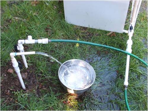

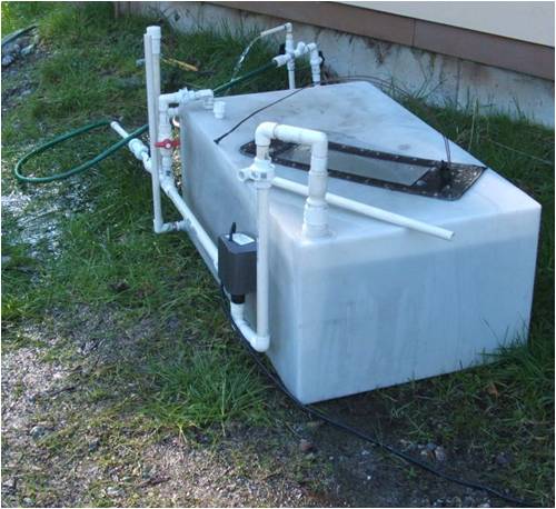

Pump Test,
The circulating pump for my Ground Loop Was in My eyes, and others,a bit anemic for the job, I was hoping to use it because of the low power requirement (110 Watts), It's
also a magnetic drive which means that the water impeller is isolated from the motor and is driven by magnetic coupling through a sealed wall. No seals to leak water into the motor. this pump should have a very long service life. the motor side is also oil filled. I paid $50,oo for it, a new one of this size is well over $200.oo .
Another feature is that the motor can run against a high head without heating, Its magnetic clutch effect just slips allowing the motor to run at full speed while the impeller runs at the rated head, in this case, 14 Ft. 4M. Kind of low which was the cause of concern for suitability.
It appears to be OK as the measured flow through the system was 2.3 US Gallons,8.7 liters. per minute.
A couple Pic's of the test.

  Greenbelt said   Pump Test,
The magnetic-coupled pumps are great. I love 'em for this sort of application.
As for the power requirement - it seems a lot of people don't quite understand the concept of a circulating pump. In a closed loop, with no air, you can pump water 100 metres straight up with just a sniff of power.
.... as long as it comes back down again! And if it's a circulating pump, it has to come back down in order to circulate right??
Pumping water 200m down a hole, then back UP doesn't require a decent pump as long as it's all a closed loop. All the circulating pump need overcome is the friction losses, and that's a function of length of pipe, it's diameter, its internal surface, and the flow rate. If you have 3/4" pipe (looks roughly what you have in those pics, perhaps 1"), a 100W pump will move plenty of water over a few hundred metres.
My circulating pump for my genset pushes water 80 metres, at up to 60 litres/minute, with a pump that takes around 60 watts. (around 13 gallons/minute)

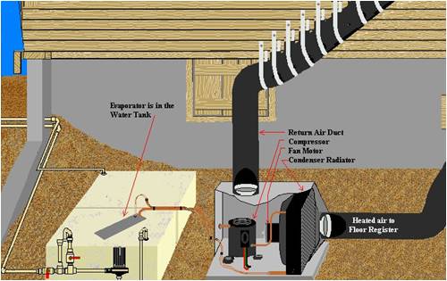

Experimenting with Refrigerant Machinery is a technical business, many times we see the pressure- temperature chart and wonder what is the meaning of this?
It is clear that this is an important part of designing a refrigeration system but it becomes a fog of confusion with all the mathematics used to arrive at the solution.
When the Designer has finished all the math and presents it on the page with a comment, "This shows that R-717 is best suited for this application" ???. well
perhaps it does., couldn't prove it by Me.
Sometimes a concept that is difficult to grasp can be explained in simple terms making the mystery disappear and a understanding of what is needed to carry on.
I will try to do this here for those who are interested in working with this equipment. There are many here like myself who do not have college math to work out the formulas. We are forced to make it work first, then tune it up.

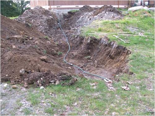

I have worked some on the project, got the Tanks connected and located in the crawl space, Have the water pipes passing through the Foundation Wall 2 feet under ground. Ran the pump for 2 hours, and lost about 30 gallons of water. the Whole Pipe system holds less than 20 gallons.
This Pic will show what I'm doing now. The leak is not in the lead in ditch as I had hoped it would be. O well,
I will build in an air filter( not shown )
May have to Buy new Pipe and make new Ditches, Summer's Coming soon. Cheers! Roe

Here's what I've done between rain showers,
Weatherman says 4 more days of steady sprinkles and showers.

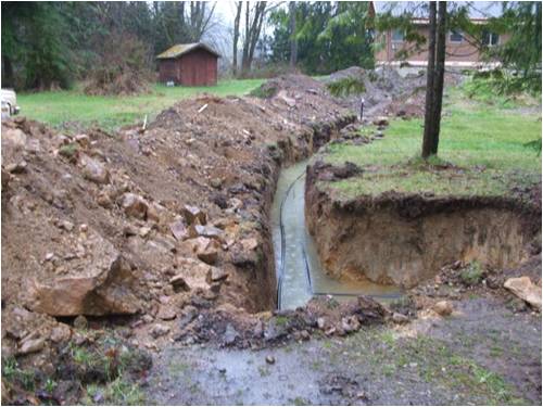

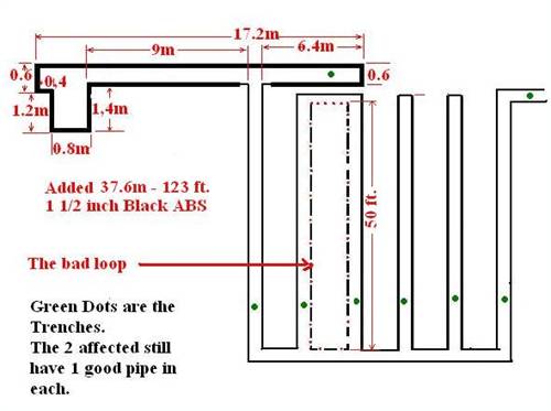

I had some ABS pipe laying around that was intended to be a part of my septic Tank
system drain field (County Building Codes Require a pressure system for liquid distribution).
I bought the ABS for this but County said Code specifies PVC.
So now it becomes a part of my system, I realize the wall thickness will hinder the conduction of heat but it has the advantage of a large surface area.
I figured the extra water (11 Gallons US.) more than the original system 91.3 pounds can store 1640 usable BTU. When the heat is turned down at night. this assumes that 18 degrees fht. of cooling is possible before freezing.
My Ground Temperature is 50 Deg.fht.
I have not tried to make it pretty, I'm more interested in bedding the pipe for protection from all the sharp edge rocks that will be piled on top of them.

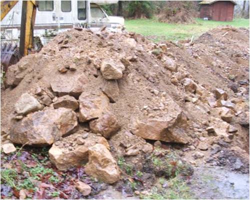

A couple of pic's to show the Mess I have made.
The area to the left in the pic's is my drain field area so no digging here.
I have been breaking bedrock to get the 100 feet I needed, lucky it is fractured even though I pulled several 300 pounders out, it was getting too tough to go further, I cut a little side wing to get a few more feet. Note The Pipe angled across the puddle is a support for my glue joint while it is drying,
More Later...Roe

Posted: 05:45pm 01 Apr 2011
Yea Bob, That would be a Samson only possibility.
I doubt that a SUMO could toss one these rocks out of a five foot ditch not to mention getting it loose from the other jigsaw pieces of the bed rock.
The second pic is my work area where occupational activities have been put on hold until the structure returns to solid ground. The water is 9 inches deep and more.
Pic 3 is a vertical pipe with shut off valve to purge air from the system, this is the high point of the loop (on solid bed rock). The other high point is the holding Tank. I can purge that side by reversing the flow through the loop. when the trench is filled I will locate the valve beneath the surface in a large pipe with cover plate to prevent damage and freezing. over time this stand pipe will collect more air and will be easy to remove.
This black pipe is lighter than water. and still partially floats when full. can't keep it on the ground!. The only place its under water is where it connects to the original loop pipes.
I have the pump connected and system is filled, I run the pump for 2 hours, there was no water loss that I can detect, If it has a leak it is very small. Yes It's Still raining!!
Cheers...Roe

Hi greenbelt
Looking at the composition of your soil/ rock mixture it might pay to lay the pipe in a sand bed to avoid contact with shards of rock that can wear through the plastic pipe in time due to slight movements in the pipe due to expansion and contraction with different temperatures, it is a monumental job to do again if that happens, the other thing I have used in the past is a mat thats used in landscaping to prevent weed growth, a layer of it under the pipe and over the top would help. It will reduce the thermal conductivity slightly but I don't feel it would be enough to worry.
All the best
