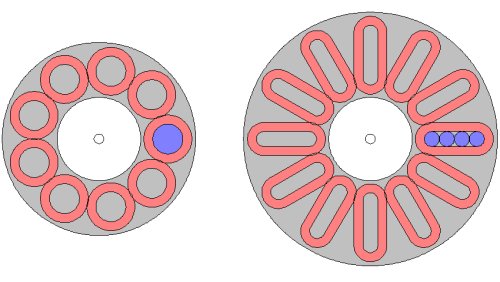

Just been thinking about ferrite magnets. I had a look at some of the suppliers magnets shapes and sizes in ferrite, and some of the shapes have potential in a axial flux alternator. I found one that was a cylinder 25mm diameter and 22mm long. Its length gave it a bit more strength over the 10 to 12mm thick cylinders.
I was thinking they could be placed side by side to give a better magnet shape. See the pic below, to the left is a common layout using 50mm Neo magnets, 12 magnets per side on a 9 coil stator, 3 phase. To the right is 4 of the ferrite magnets in a row ( all poles facing same way of course ) to give a 100mm by 25mm magnet. This overall magnet shape lends itself to a better coil shape. The coil is narrower, meaning you can fit more coils around the stator, with the same inside diameter as the Neo magnet stator. We get 12 coils, and would use 16 sets of magnets per side. This also means a higher AC frequency for a given RPM. We also have more of the coil under magnet, the ends are shorter compared to the round coils.
So by going to ferrite we loose magnet strength, but we do gain frequency, and a better coil shape. These gains would still not give us the power of the Neo magnet alternator, but we could definitely get a alternator with respectable power.
There are other advantages I can see too, like the magnet plates wont need to be as thick ( heavy and expensive to cut ), 4mm steel could be used instead of 10mm, at a guess. And the stator is bigger, so will dissipate more heat.
Just thinking out loud.
