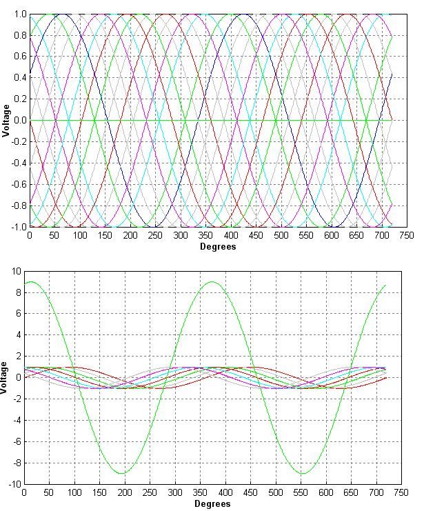

OK, OK, the aim of this exercise was originally to reduce cogging.
I think everyone agrees that cogging will likely be reduced by reducing the number of poles that are in line at one time, the ultimate being reducing this to just two poles by configuring for 21 phases.
Unfortunately the individual coils on the stators we have produce a fairly low voltage and when a phase has just two coils there is hardly enough volts to be of any use especially when rectification losses are taken into account.
Highlander I am eagerly waiting to hear when you have your 44 magnet rotor just how much cogging remains.
Now just suppose it is all good news I have drawn some more diagrams today:
This is not 21 phase! I have pretty much gone off that idea and been looking at alternatives.
The first diagram is what I think the voltage waveforms would be in the 14 coils of one phase of an unmodified stator with a 44 pole rotor. These voltages are not in phase with each other and the total is zero! As shown by the green line.
The second diagram, however, is the same 14 waveforms but in this case I have reversed the polarity of the second 7 coils. The green trace shows the total of these 14 waveforms (incidently, you only see 7 waveforms because each trace is actually two identical traces).
This looks much better dont you think? However the summed voltage only peaks at 9 volts whereas it would be 14 volts with an unmodified rotor. I guess that is the price of a low cog system.
But Wait!    The wiring modifications must be the easiest ever: Connect all the 6 ends of the standard stator together, thats the three phase terminals connected to the star terminal. Now find the point between coils number 21 and 22, there are three wires there and all thats needed to be done is to scrape the insulation off these three and connect the new phase wires to them, do not cut the wires.
You can use these three phases in any of the usual ways, connect in star for about 9 volts** or delta for a bit over 12 volts**
**Note that these voltages are at the RPM that produces 1 volt on each coil and is pretty slow.
I think thats about my dash on this subject.

RE wiring "Now find the point between coils number 21 and 22,"
I need a reference point to start counting from. If your looking at the stator from the back where the star and phase plugs are, which one are you calling number 1?

Find the point between the three star lugs and the 3 phase lugs then count 21 coils from there (either direction) to find the directly opposite, which is the centre of the three phases.

"You can use these three phases in any of the usual ways, connect in star for about 9 volts** or delta for a bit over 12 volts** "
Your explanation is for star but how do you wire for delta?
