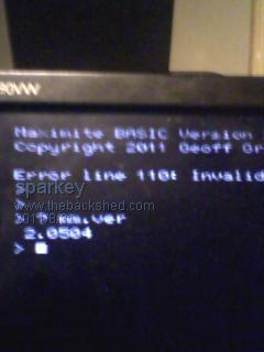

:also the led started flashing once the firm had finished the up date thoug was not on whilst the programming was going on sorry i did not note this earlier regards ....Edited by sparkey 2011-09-01

OK, I fixed the two bugs. A new version (2.5D) is available from:
http://geoffg.net/Downloads/Maximite/Maximite_Update_V2.5D.z ip
Thanks very much sparkey and Bob. The hardest part of fixing a bug is finding it in the first place! Much appreciated.
Wiz, I reworked the USB timing and it might have fixed your issue also.
Geoff

thank`s geoff well its running on my altronics thanks for the bug fix so i spose thats ok fo me and bob who replied ....i usully try your hex code when you post it regards sparkey ....
:: mm.ver "2.0504"Edited by sparkey 2011-09-01

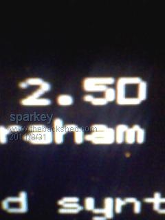

this is after geoff modded the "hex' on an origanal altronics maxi-m...
:: regards sparkey......Edited by sparkey 2011-09-01
