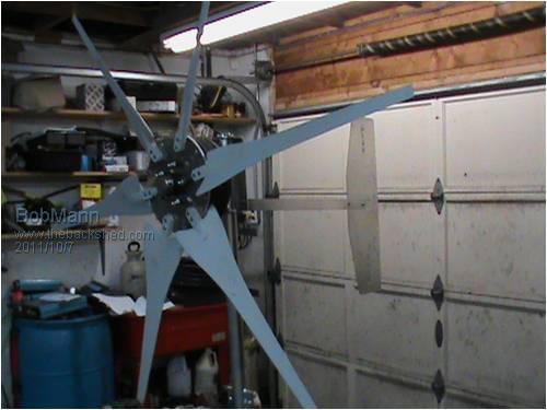

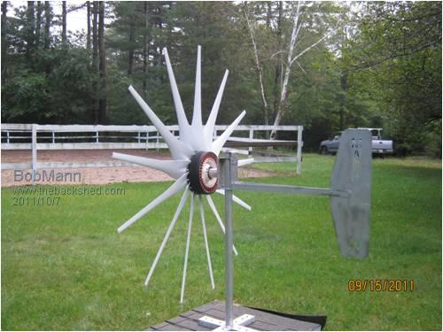

Hello I am testing at both sites we are working on the HAWT plate form today.
so we can test the Mann Smart Drive at the water tower with the HAWT unit.
The Tree Top one is shielded by the back trees I am waiting for some one to top all of them.
I will test with 9 blades first this is a old pic I have add some upgrades to it.

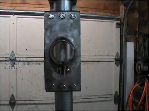

Thank you on that I do have a volt low and high adjustble limiter going to a dump on the AC 3 phase side I just need to test it and then install it .

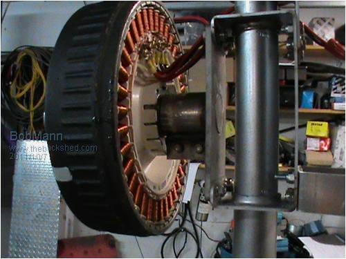

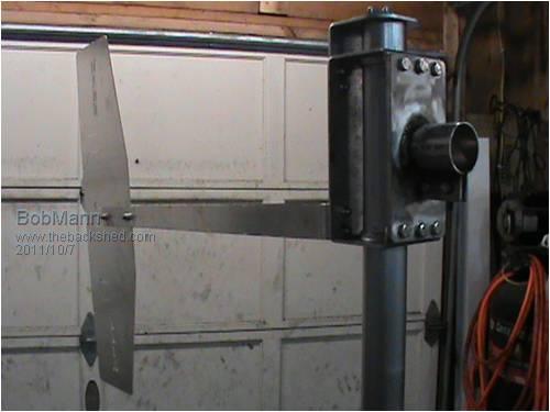

Here are some new pic of the upgrades it do has a sweep of 65 inchs
Here is the adapter to bolt on my Smart Drive to a MWS unit.
Here it is with the three bolt hole setup you can offset it
to the left or right.
Here is the Smart drive installed and locked down
Here it is with the 6 blades I hope to install tomorrow
at the 110 ft plateform.
See I still have to pull it up by hand and assemble it by myself on a
16 inch beam. We still have 6 more blades if need to test.

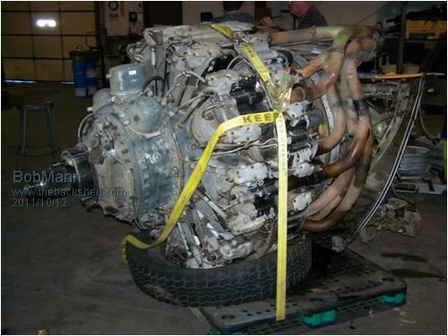

There are places in the world that dream of just one night light to read with just trying to make that happen.
He says he is using a 6 ft long bar with 30 LB of fource.
Bob picture shows 9 100 watts lights bulbs also turned 15 100 wattt light bulbs yesterday

Posted: 11:16pm 09 Oct 2011
Yeah I dont think they are 100 watt bulbs. That would be 900 watts, and the camera would close its aperture so nothing would be visible in the background. It would be near impossible to look at. Besides, a normal man is good for 100 to 150 watts for short durations. A athlete is good for 300 watts. To drive 900 watts you will need a horse. Not that it couldn't be done, but it would still take a horse to make that much power.

  Gizmo said   Yeah I dont think they are 100 watt bulbs. That would be 900 watts, and the camera would close its aperture so nothing would be visible in the background. It would be near impossible to look at. Besides, a normal man is good for 100 to 150 watts for short durations. A athlete is good for 300 watts. To drive 900 watts you will need a horse. Not that it couldn't be done, but it would still take a horse to make that much power.
This is what the guy sent me after recived one of my Mann Smart Drives. He says he has a patten on the drive system.
I still think a bad step child should be used to move it.

I think Lance Armstrong or a good marathon rider is good for 700w bursts , mabe it's a picture of Usain Bolt training in his back yard.
Every time I read what BoB is trying to FLOG here on the forum it doesn't add up , we seem to be getting treated like Ebay Customers. Its almost degrading to the forum as well as I hear you are doing the same on multipul forums .
You constantly get asked to give real data about your MANN SMART DRIVE , but fail to do so and instead show a Bridgeport Mill driving it into a grid tie inverter that would probably need the power curve set into it to load correctly, will it do the same in real conditions " SHOW US "
And do you really expect poeple to believe that a the Guy has a Patent on what appeares to be a car rim supported by a couple of pieces of timber. Do you know the costs involved in Patent.

Posted: 11:13am 10 Oct 2011
Hi Bob.
I think what Phill is trying to say is you need to listen to the people on this and other forums that are trying to point you in the right direction. There is some real expertise here and you are ignoring it.
What you have built is a robust alternator that would suit a windmill of up to 500 watts, provided its coupled with a matching turbine. A set of blades 2.5 to 3 meters in diameter would work.
The blades you have used above are famous for their noise and poor performance, too small and only good for 300 watts. Adding more blades wont help the peak power, it just gives better power in low winds, we're talking about under the 100 watt range of wind speeds.
The peak power you achieved is very good, but not practical for several reasons as the forum members have pointed out. The RPM is too high to direct drive from a turbine big enough to drive it, so you need to use gearing. And you do need to take Naill's advise, the voltage is dangerously high and the windmill will be uncontrollable if there is a grid failure.
Daves comments about the system losses are also being ignored. The fact is the person driving that device is only good for 100 watts continous duty, therefore YOU CAN NEVER GET ANY MORE THAN 100 WATTS OUT! NEVER. If he tells you he is getting 900 watts, with his patented system, he is lying to you.
As I've said before, nothing personal, your workmanship is good, but you are lacking some basic scientific understanding. Listen to the forum members, they are only trying to help you.

so now you have appropriated the fisher&paykel motor as an alternator and given it your name.
what ever.
personaly i think that by replacing the ceramic mags with neo's your just saturating the iron,increasing the start up torque required to break it free and increasing the cogging but that's

My unit was a test to see if some one could build a low cost high powered ALT that would last a life time and use unskilled workers to assemble any were in the world.
I will brake down my cost here for a basic unit.
60 Stator $65 USD
Drum kit $60 USD
axle shaft $25 USD
mounting $20 USD
plate for
shaft to
hold stator
38 Neo
Magnets $75 USD
cost of
parts $245 USD
Time 3 HR
to assemble
We all know I will need big wings to get up to the full power of the Mann Smart Drive.
I just assembled the 8 ft lenx setup on my tree for testing

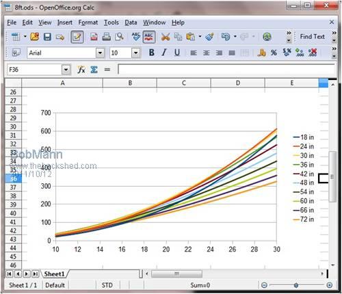

Here are our chart for a 8 ft at 36 inch Lenx blade with this ALT by the way my blades make no noise.
I feel the fix is a DU06_W_200 Lift at 8 ft 60 inchs
Here is a power chart for the new blade I had to add the overlay.
These charts were done by Steve at www.vawts.net
His math is as close to real world as you can get.

The F&P alternator peaking at 1150 watts is like a highly modified Chev running a big cam, ported heads, injection hat, that can pump out a dyno proven 800hp on methanol. Great with the old blades.
Or
run this my brother and I were hired to convert this to run on CNG to power a
1MEG WATT genarator some were in the world.
I allways say go big or go home.
