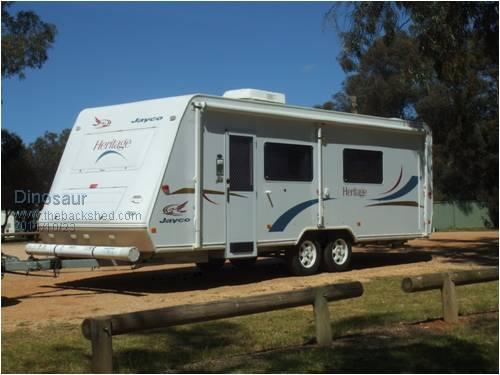

Hi All
Yahoo , many thanks for that detailed analyses.
By, the way, a Dinosaur needs a much bigger van.
I have room for 4 x 200 Watt panels, or I saw an add for 250 Watt panels.
So, 600 Watt is the next best. Additionally, the Laptop will be a usage that
probably will reduce after the first few weeks.When the novalty of bragging wears off.
Hoping to limit the use of the Generator to once a week when the washing machine
is run.
I agree with the 60 Amp MPPT.
We are leaving the purchase of the solar system till about Febr /May when we will only have a few months left before we sell the house.
However, the brief is, we must be self sufficient, so if more panels / batteries are needed, so be it.
So, after all the very helpfull posts, I think :
3 x 200 Watt PV's
2 x 100 AH Batteries.
1 x 60 Amp MPPT regulator.
1 x 2KVA Generator. (would have liked Diesel , but they are noisier)
Hervey Bay Qld.

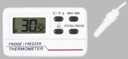

If you are looking for ways to spend the hard earned $
$15 each, very good value
only downside, it is possible to bump the buttons and be looking at the daily minimum or the room temp and not know unless you have a close look at the screen

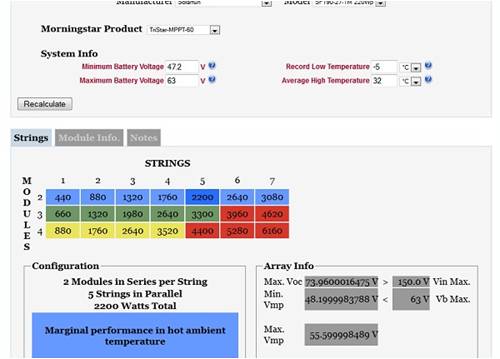

will be fascinated to hear what panels you use and how they will be wired to meet the 40 volt minimum criteria.edit (for the scc-2)
Morningstar Corp
morningstar string calculator
this is a mockup for a 48 Volt system, yellow is over volt, blue is under volt and red is over current.
Yahoo ,I had to re-read that brochure before I finally found that statement, but I wonder if the 40v is for the 48 version. Will email them and ask the question.
I have not used the calculator before, but wonder if the aim is to achieve a Green line. Have to read and try it.
