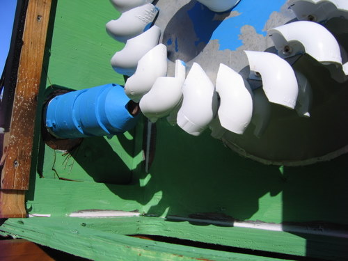

Hey Don,
The reason I put the notches in the buckets was because that is the way Don Harris fabricates his "Harris Pelton Wheel" and that is the way EcoInnovation fabrics their pelton wheel. Both Harris and Eco use a single nozzle, although they do use more than one nozzle when the conditions dictate. I have wondered why not use a single bucket with a single stream of water, but I have not thought of using a twin nozzle with a twin bucket. Sounds reasonable to me. OK, if I fabricate a twin nozzle, do you think that I should refabricate the buckets without the notch? It seems to me that the notch would allow some of the water to escape the buckets without releasing all it's eneregy. As you suggested, I have some plans to be able to tweak the direction of flow to get the most energy from the water. By the way, it's raining right now, which is a good thing for my little creek (Bill's Branch). I really do appreciate your help.

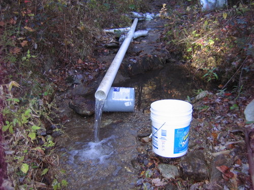

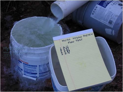

Flow at minimum flow: 50 gpm (same as original).
I took 5 measurments that gave an average of 51.64 gal/min =3.26 liter/sec.
Note: The flow increases with a rain to well over 500 gal/min but returns to the 50gpm over a period of about 1 week.

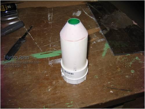

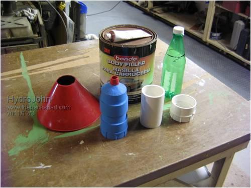

Next I began working on improving the efficiency of my nozzles. I tried to fabricate a twin nozzle as Don suggested, but without much success. I was able to make a nozzle using different size funnels and coke bottles that did quite well.
Then I worked out a way to adjust the direction of the nozzle spray.

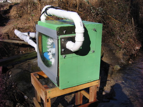

I used the lid from the washing machine for a door to the pelton wheel.
New nozzles with 21mm opening(coke bottle)
After tweaking the new nozzles I was able to get 110 to 120 watts (much better than the previous 39 watts). This was very encouraging to say the least. Next I needed to get the power to my house. I looked around my scrap piles and found some salvaged 12 part phone line (about 600') that had been discarded by the phone company. Used 4 lines for each phase and ran it to my basement. I hooked up my light bulbs and had lights powered by my creek inside my house. I have a voltage loss of about 1.5 to 2 volts. I am now working on the intake structure to stop leaves from clogging up the nozzles. This will also increase the head by a couple feet. Once that is done I'll have to figure out what to do with the wild AC that is now inside my house. I know that I have lots more learning to do and I hope you will be willing to continue your help and suggestions. Any response to this post will be appreciated.
