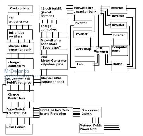

  fillm said
nowhere in your block picture of your system does it show 2760W of solar comming in.
Hello Phill M;
Here is the updated block diagram showing the solar side with auto circuit between the solar and the system that separates the solar. When the batteries are charged the solar dumps all it's output into the power grid through six(6) grid-tied inverters. I don't rely on the solar that much it's not reliable during cloudy or rainy days or snow cover, plus the trees have grown and shadow the arch of the sun at certain times during the day.
I stated in the beginning I used solar and found it was not reliable.
Regards Bob

Hi Bob,
It would be interesting to know the total power consumption of your house as well as the total grid export/import, also a breakdown as to where the power was being supplied from eg- Total Solar & Total Wind , Other?
This would then give everybody a good picture of your systems workings and its efficiency.

  Quote  I have found no lost power at conversion only increase's in amp's and watt's.
This cant happen, its one of the laws of thermodynamics. Every time you convert energy from one form to another you loose, no exceptions. No process is 100% efficient, there will always be some loss. If the meters say you are gaining watts, then there has to be a incorrect measurement made somewhere.
Interesting set up Mr Delanco, but I do agree with other forum members, its does seam overly complicated. I wonder if the net output would be higher is you took out a few steps.

Hello Glenn;
What conversion are you comparing thermodynamics too?
There is only one conversion of Ac to Dc and that is the rectifiers after the 1st. Alt-Generator. The rest of the system generates and continuously stores DC building a stronger storage base of usable power.
Do you understand Ultra-capacitors of this size?
Bob.

Hi Bob,
I hear you on the use of recycled parts. That can be fun and informational. I sure hope that ford isn't sucking in too much dirt without it's air cleaner lid and you kids don't have unrideable bikes...
I believe all the conversion steps are what is being described above by Glenn are;
Wind kinetic energy --> rotor kinetic energy
rotor kinetic --> generator electrical
generator electrical AC --> gen DC
Electrical energy --> chemical energy in the cap (I think)
Ultracap chemical potential energy --> electrical current
electrical current --> chemical potential energy in the batteries
chemical potential energy in the batteries --> electrical energy
electrical energy to mechanical energy then back to electrical energy in the flywheel
and on and on and on.
There has to be energy lost in each of these steps. If you put 100 watt-hrs into a batter you don't get 100 watt-hr out.
Those are all conversion steps that thermodynamically will never be %100 and will always cost you efficiency/energy.
I think we can all agree that there are only 2 things creating energy in your system, the turbine and all that solar. All the other items are conversion items that cost you energy. I think that is why everyone is saying that either an appropriately sized flywheel or battery bank (caps helping for other reasons) would be more efficient.
But for use of used parts and recycling, you get an A.
Perry

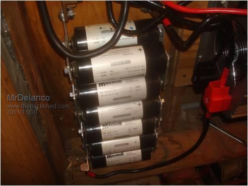

Bob.

Question: What is an ultracapacitor?
An ultracapacitor, or "super-capacitor", stores energy electrostatically by polarizing an electrolytic solution. Though it is an electrochemical device (also known as an electrochemical double-layer capacitor) there are no chemical reactions involved in its energy storage mechanism. This mechanism is highly reversible, allowing the ultracapacitor to be charged and discharged hundreds of thousands of times.
An ultracapacitor can be viewed as two non-reactive porous plates suspended within an electrolyte, with a voltage applied across the plates. The applied potential on the positive plate attracts the negative ions in the electrolyte, while the potential on the negative plate attracts the positive ions. This effectively creates two layers of capacitive storage, one where the charges are separated at the positive plate, and another at the negative plate.
Maxwell Technologies Knowledge Base
Cheers Bob.

An ultracapacitor is different than a battery, and depending on the application, may be a better solution. Often, a combination of the two is the best approach, combining the excellent power performance of the ultracapacitor with the greater energy storage of a battery.
An ultracapacitor can be charged to any voltage within its voltage rating, and can be stored totally discharged. Proper system sizing includes accounting for a capacitor's voltage change as it is charged and discharged. A battery operates within a very narrow voltage range, determined by its chemical reactions, and can be permanently damaged if over-discharged.
State of charge of an ultracapacitor is simply a function of voltage. State of charge of a battery involves multiple dynamic calculations.
An ultracapacitor stores much more energy than a conventional capacitor of similar size. A battery will store much more energy than the same size ultracapacitor. In applications where power determines the size of the energy storage device, an ultracapacitor may be a better solution.
The ultracapacitor is able to deliver frequent pulses of energy without any detrimental effects. Many batteries experience reduced life if exposed to frequent high power pulses.
An ultracapacitor can be charged extremely quickly. Many batteries are damaged by fast charging.
An ultracapacitor can be cycled hundreds of thousands of times. Batteries are capable of only a few hundred cycles.

Ultracapacitors from Maxwell are rated at 2.5V each. They can be charged to higher voltages, but it should be noted this would effect the useful life of the product. Maxwell Technologies does not recommend the operation of the ultracapacitors above 2.7V.
By applying a low charge into my ultra-cap array I am able to build on the charge to a higher voltage. The charge equalization circuit, balance circuit is a standard design available from several sources, I customized a circuit design to meet my needs. As the cap charges to 2.5 vdc the extra is passed to the next to allow that cap to full charge and so on. By cascading this allows the array to build not only a higher voltage but also increase's in amp's and watt's.
Food for thought; Conventional flow from positive to negative is thought, but the actual flow of an electron is from negative to positive.
Individual cells are rated to 2.5V each. There is no limit on the number of cells that can be placed in series to attain higher voltages.Edited by MrDelanco 2011-11-25

Ultra-Cap on one of the inverters.
Battery Storage
