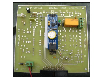

I was mainly trying to see what I could use for other projects from this one like schematics for sensor input and the LCD display method. Is that hooked to the VGA or composite? Are most of these LCD composite or VGA?
Michael

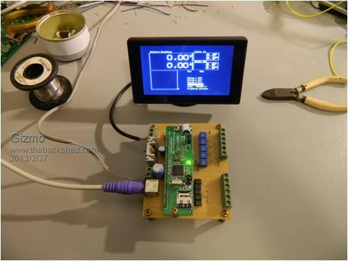

Thats cool Michael. I've been caught before where I published a circuit built from my collection of junk parts, only to find people have trouble sourcing the same parts and send me emails asking ( sometimes demanding ) for substitutes or if I could redesign the circuit to suit their needs! I dont work that way, this is a hobby, and I will always assume the reader can modify the circuits to suit their own needs or available parts.
The little screen is composite video input.

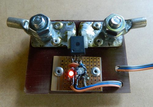

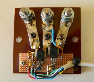

Here's a picture of the Alegro current sensor I've mounted ready for use. This one is a 50amp bi-directional type. I've added a 22uF electrolytic ( tantalum would be better ) cap and 10k resistor to smooth out the output, these things have a fast sample speed which is a bit un-desirable for my application. Also added a LED for some "bling".
I'm putting together an article on using these Alegro current sensors, with a few tips from other forum members, will put up a post when its done.

[quote]these things have a fast sample speed which is a bit un-desirable for my application.[/quote]
Change the 22uf cap to 100uf or greater and it will slow down the average of sample rate, this will also give greater stability to the readings to.
Althouh i like the sample rate as high as i can get it and prefer to do several readings and add them together.
Pete.

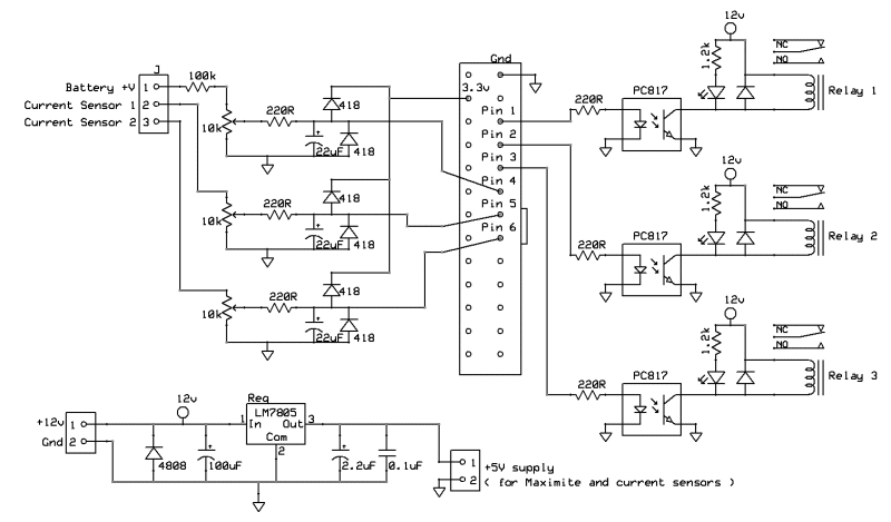

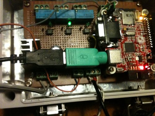

OK, another update on the RE controller. Its still a long was off from finished, but I though I would post the circuit and code as it is now. The code is a mess, needs to be properly commented and cleaned up. Its not an example of good programming . Also the logging routines are not in this copy. But it does run, and should display some figures from the floating input pins. If you are interesting in building this thing, better wait until I have finished it.
When running, key 0 will bring up the menu screen. From there you can calibrate the readings, set relay voltages, etc. From the main screen you can also press 1,2 or 3 to change the running graph to display readings for every second, minute or hour. The graph is just bling. The main feature of this program is watt hour tracking, so you can see how much power has gone into and out of your battery bank, which it the best way to track its state of charge. Plus the program will control 3 relays to switch in dump loads, etc.
The circuit is not showing the battery bank, source, current sensors etc, that will come.
The program needs a file called Config.txt, see below.

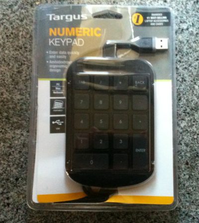

Today I went looking for a numeric keyboard. The RE controller will be mounted on a wall, and I didn't want to mount a full sized keyboard on the wall with it, so I planned to use a little numeric keyboard. I've written the software to only need the number keys and ENTER key for all menu operations.
I figured any keyboards I find will have a USB connector, so I dug up a green USB to PS2 adapter and tested it on the Duniomite at the heart of my controller, works fine. One thing I did notice, when I plugged in the USB keyboard, the Duinomite reset itself. I'm guessing the USB keyboard and USB to PS2 adapter drew a bit of power when plugged in and this spike in load caused the controller to reset, fair enough. After the reset, it worked perfectly.
I went for a drive and found this Targus numeric keyboard at a local office supplies store. It cost $32 plus $40 for the bloody parking ticket! Frig me, I was only in there for a couple of minutes!
Anyway, moving on. Once home I plugged it into the Duinomite with the green adapter. I doesn't work, dead as a door nail
So I'll take it back tomorrow and see if I can get my money back. I'll park somewhere else this time. ( $40 for a parking ticket! Thats a joke! It takes a special type of person to be a parking inspector )
I'll have to keep an eye out for a PS2 numeric keyboard, dont want to risk the USB interface not working again. If they dont take this one back, I might hack it open and wire it up to a USB keyboard controller that I've tested, I have a few USB keyboards.

Glenn:
Your adapter might do little more than convert from PS/2 to USB connectors - there are likely just wires inside.
If you plug in a USB (only) device, it will not work. The keyboard that you plugged in has a USB plug, but it can auto-detect PS/2 signals and works with the adapter. The keyboard is smart enough to start talking PS/2 (on its own USB lines) when it detects that signalling. The green adapter is nothing more than wires, then.
Posts: 5198
Posted: 12:56pm 06 Jan 2012
Ah, yeah, also just read the post by Don where he cut one up.
Is there a PS2 to USB adapter that is actually what it's supposed to be? It wold be nice to keep this little keyboard.
CircuitGizmos
Joined: 08/09/2011
Posts: 1427
Posted: 03:35pm 06 Jan 2012
Not that I am aware of. The adapter would have to act as a USB host. It takes more silicon and effort to do this. USB is asymmetric - hosts do a lot of work, devices much less. Hosts are expected to have the resources to do this.
(The opposite, yes. That would be a device that accepts PS/2 keyboard and is itself a little USB device. Much simpler to implement. I've used those.)

Hi Glenn
Inspired by your application for the MM, I decided to make an expansion board using your idea for the analogue inputs as well as for the 3 relays except I drive them with a transistor.
There are two temp sensor inputs top left digital inputs or out on the top row and a real time clock down the center
It is a double sided board but I have to solder jumpers through the board.
Other than measure the temperature and tell the time and drive the relay I havent done much with it yet.
cliff

Built the current sensor board today. Using a couple of Alegro sensors, one for current in and the other for current out.
I'm chasing a fault at the moment, only just discoved it and wont get a chance to look into it until later tomorrow. I appear to have some stray voltage on 2 of the input pins. Pin 4 and 5, even with a 5k to ground, measure over 1 volt in both the Maximite software and with a multimeter, when set as analogue inputs. But like I said, I need to look further into it in case I'm doing something really stupid.

I've re-started the RE controller from scratch. The Duino-mite based controller is basically finished and works well, but I'm not happy with my interface circuit, so instead of making a new circuit board, I'll keep it to control a windmill at a later time. So its put aside for now.
RE Controller version 2. This time I decided to use a CGMMSTICK1, just for fun. The first RE controller used relays on its output, but since then I found a heavy duty N Channel MOSFET output stage from a old UPS, and have decided to drive that directly from the Maximite, via some opto couplers. I only need 3 of each, but I've configured 5 inputs and 5 outputs, for future additions.
I also decided to use a current transducer instead of the Alegro current sensor to measure the battery output current.
Will post more as it comes together.

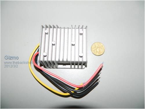

Posts: 5198
Posted: 11:28pm 01 Mar 2012
Yesterday the 48V to 12V converter arrived.
Got no excuses not to finish this thing now.
