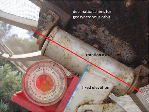

the elevation for Melbourne would be 52 degrees.
The plus and minus 23.5 degrees adjuster goes where the shims are placed on this old dish.

I just located a sun chart for Melbourne.
According to that, solar noon right now reaches a peak elevation of about 72 degrees.
The axis of rotation of my mirror will need to be ninety degrees to that, or at 18 degrees of elevation, so it "looks upward" at 72 degrees as it rotates through noon.
The same sun chart says solar noon is about 1:20pm local daylight saving time in Melbourne.
Anyhow, if the sun decides to show itself tomorrow, we shall see if the theory works, or I have screwed up.

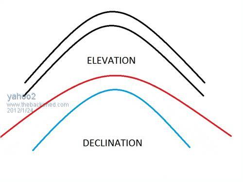

What you are seeing at the moment is a flattened arc you are only matching the suns elevation at two points during the day, it will track perfectly at the equinox, I didn't believe tilting the mirror above the axis would work to change the arc shape when I first seen it. As you scale up the problem gets worse, parabolic dishes over 3 metres are a nightmare to point, even the weight of the dish will flex it enough to throw the accuracy out, as it tracks a moving object across the sky.
