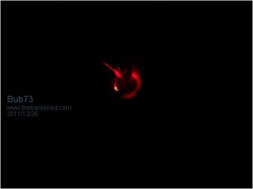

Posted: 04:17am 13 Jan 2012
Here is a servo in Michigan winter with the deicer's on using up some of the extra amps!!
Piggweed be careful when you put that motor in the lathe those WILL BE LETHAL VOLTAGES and it may want to spin the whole thing when you put the load to it be safe!
Be careful welding on pipe as some is galvanized and can make you sick and the weld also causes a stress point and cause cracks .
THIS IS PIGGWEEDS first project let's help him work it out.!!
