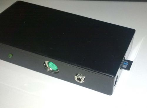

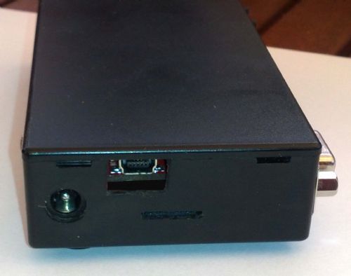

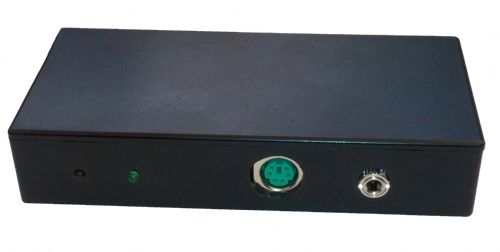

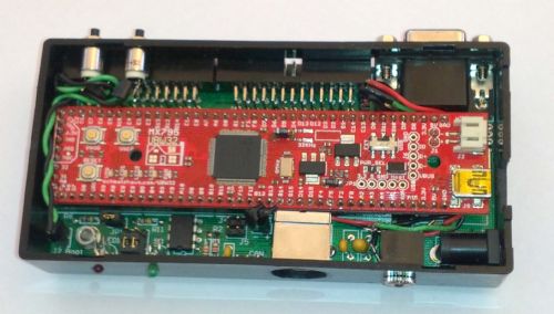

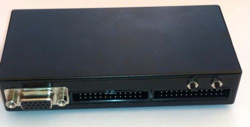

I have finally been able to get time from my work committments to put the UBW-CMM into its case.
In my efforts to keep the size as small as possible I didnt realise that it would be as tight as it ended up being.
All that being said it still does fit (with a the help of a crow-bar and large hammer )
Due to space constraints my `usual' stock standard mini push button switch would not fit so I was forced to buy these little beauties from RS Components (RS Stock No. 119-3507) which were $2.80 each..
RS Components Mini Switch
All things considered I am really happy with the way that it has turned out.
Here are some pictures using the case I suggested.

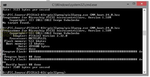

I loaded the Maximite bootloader with a PicKit2 using Pic32prog.exe
This makes for real simple bootloader programming and I am sure there
are a lot of Pickit2's out there
This avoided the pin 1 issue I had previously
Hmm.... That looks almost too easy... will it work with the PicKit3 or is it a PK2 specific program?

Posted: 04:31am 04 Nov 2012
Just build the UBW32 Color Maximite and it works perfectly.
The MCC board is great.
No difficulty soldering the components.
Have put in the Maximite bootloader with Pikit 3 and it is now fully compatible with the CMM.

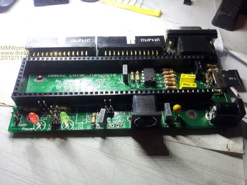

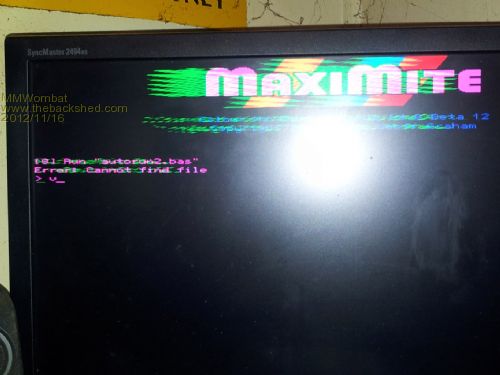

Just finished building the UBW32-MCC board and all seems to be working fine, except for some green lines I have moving across my monitor. If I save of a screen shot, they are not in the resultant bitmap file.... Any ideas on source of interference...
Otherwise an excellent product, MicroSD card accesses ok...
Only thing I didn't add was the MCP2551 Can chip....
Regards Dennis
Keep plugging away, it is fun learning
But can be expensive (if you keep blowing things up).

  MM_Wombat said   except for some green lines I have moving across my monitor. If I save of a screen shot, they are not in the resultant bitmap file.... Any ideas on source of interference...
Hi Dennis,
The MC2551 Chip shouldn't make any difference.
Things I would look at are:
1. R4 for Correct value and as it is very close to the uSD socket make sure that there isn't any solder splash that might be touching the uSD socket.
2. D5 for correct type (1N4148 or 1N914) and polarity (black line towards the edge of the PCB)
3. Power supply source... is your USB cable a decent `fat' cable and not too long so that you can supply enough volts/current to the UBW32?. If you are using the Power jack make sure you have at least 8Vdc input and that C1 is the correct polarity.
4. Spray the PIC chip with some freeze spray (Or heat with a hair dryer) to see if there is any affect, maybe you are suffering some problems that others have experienced with `jitter'.
5. Remove the uSD chip and see if that improves things, if so maybe try a different chip and/or place a wire link across R12 (2R2 resistor)
6. Try a different VGA monitor if you can.
7. Check for a dry joint on Pin 2 of the VGA socket (Green pin) and wiggle the lead going to your monitor to see if its a loose connection or wire in the VGA lead.
I will think on this overnight and respond in the morning if I can think of anything else.
EDIT***
Is it possible to attach a photo of the screen so I can have a better guide as to what is actually happening?
Is it the same with a blank screen as it is with say the Colour Demos?
Edited by bigmik 2012-11-16

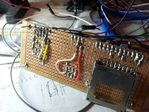

4. Don't have any freeze spray, but all worked ok when I had the ubw32 wired to my makeshift board for vga, ps2 and sd card... A picture of my messy effort (that worked flawlessly) of my vga, ps2 and sd card connectors..
5. Remove the MicroSD card and nothing changed... haven't tried the wire link on R12 yet..
6. Don't have a different vga monitor to try, but plugged the mono maximite in and all displayed ok on my monitor and existing vga cable...
7. Re-wet all the vga connectors pins last night, with still no change..
The pics you requested of the screen, and one of my UBW32-CMM..
One thing I did not mention, and IS most likely the cause, is, the C2,C14,C15 and C16 caps don't look the same as your pic... The guy at altronics said it should still work the same , even though they are not polarity specific..??? When I went to get some, he had very small blue ones..?? <edit>Before I soldered in the ones he had supplied firstly..<edit>
Regards Dennis

  MM_Wombat said   A picture of my messy effort (that worked flawlessly) of my vga, ps2 and sd card connectors..
Wow!!! That is sure some interference..
Firstly... Try powering with the USB cable instead of the external PSU... If the problem persists then it looks to me like there is something shorting to the GREEN output..
I have looked closely at the track layout associated with the GREEN output and there are only a few things that might generate that affect as far as I can see.
D5 Reversed or faulty
D5 Not GNDed at the Cathode
A short (or semi short associated with tracking nearby) with R4 or D5 and VGA pin 2
Another thought is to make sure that these pins on the UBW32 are all shorted together
D2, D9, D14 and G9 and linked to VGA pin 13.
Also make sure A4 goes to VGA Pin 14.
Apart from that I can offer to check it out for you if you wish to drop in to my place (Melb Nth West Subs) or you wish to post it to me...
PM me if that is what you wish to do.
