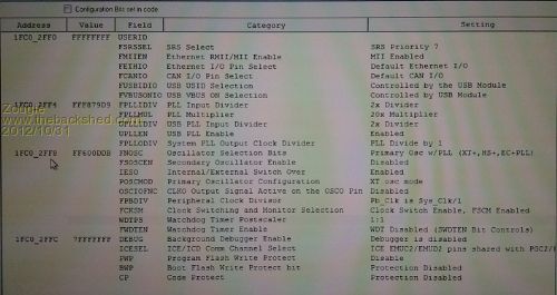

Zougie
Joined: 04/10/2012
Posts: 18
Posted: 02:56pm 30 Oct 2012
Finally success!!!!! Spent a couple of hours last night trying various things to breath life into the UBW32 MCC including a benchtop power supply and V4.0 software with bootloader. Initially, I had little success. The PIC programmed successfully but was not responsive once reset. Current draw from the power supply was tyically 20ma....not much at all. I then loaded the native UBW32 bootloader and it loaded and instantly came to life. Current draw jumped to 120ma and USB activity was detected at the PC end. I decided to dig deeper and look at the configuration bits. The Maximite configuration I had was somewhat different to the UBW configuration. I became even more curious when I was just how different the clock/oscillator configuration bits were. If these are not configured correctly, the PIC will have nowhere to go. I made the changes to the Maximite V4.0 file configuration bits and tried reprogramming the PIC. This time it came to life and drew the correct 120ma. Also, all of the A/D pins were accessable and the unit has performed as expected.
Attched are the settings I used:
So it looks like MPLAB configuration bits got me....and am curious how no one else has seen this before.....or have they?
Thanks again everyone for all of your support!!!
Cheers,
George
BobD
Joined: 07/12/2011
Posts: 935
Posted: 03:07pm 30 Oct 2012
George, that photo is not the best. Why don't you have another go and attach it as a JPG file and it will be able to be displayed much better.
Bob
Posts: 6617
Posted: 04:28pm 30 Oct 2012
  Zougie said   Finally success!!!!!
Cheers,
George
Glad you have had success.
I didn't look at the configuration bits, I just left the setting to "configuration bits set in code" and it worked.
I don't know how to find out what settings the code used when I only have the HEX file. And I certainly don't know enough about the PIC's to start playing around!
Posts: 2981
Posted: 10:43pm 30 Oct 2012
Great news George,
Glad you have it working... we need to investigate exactly what went wrong for you... In my case I installed MPLab then selected the device type, selected the PicKit3 then imported the file and it just worked...
Maybe I was lucky but so many others seem to have been `lucky' as well.
I cant spend the time investigating it for another 10-12 days due to work commitments
but I would like to know the difference from your method to mine...
I would be worried about changing the HEX file as what other strange things might be introduced if you change an important bit.
Zougie
Joined: 04/10/2012
Posts: 18
Posted: 02:32am 31 Oct 2012
Mick, I too find it odd that two separate PCs at work and a laptop at home with MPLAB 8.87 all programmed ok, but were setting the config bits differently to what is required for operation.
As for the dodgy screenshot I sent through (sorry Bob), I'll put together something more legible.
Is anyone else using MBLAB 8.87? I'm wondering if there is something going with this version?
If the HEX works for so many people, I'd leave it as it is....and anyway Mick, this the busiest time of the year for you.....you have all those horses to keep track of.
Cheers,
George

Wajkaj
Joined: 03/11/2012
Posts: 14
Posted: 04:39am 04 Nov 2012
Had exactly the same problem as Zougie.
I use Pikit 3 and Mlab 8.50 and Mlab X and both do the same.
Thanks to Zougie, i changed the config-bits too and it works.
It seems like it is only the config-bits thats giving the problem.
The UBW32 works just fine now and i tested all I/O and several programs.
No problems so far.
Thanks Zougie.
Johan.
