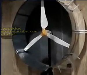

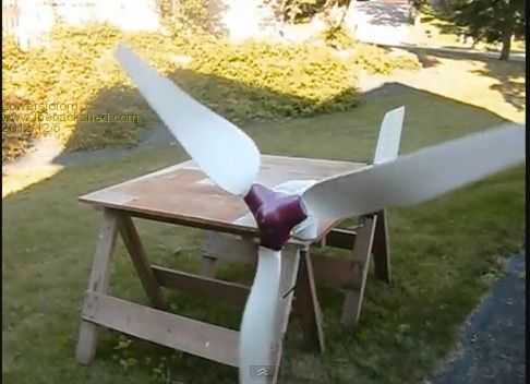

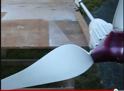

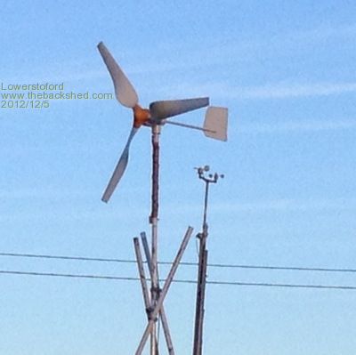

Lowerstoford
Joined: 30/11/2012
Posts: 29
Posted: 07:50am 05 Dec 2012
SPOT THE DIFFERENCE
Example 1
Example 2
Example 3
Mine
Some Energy is Some Energy
Posted: 09:19am 05 Dec 2012
Well it looks like you need to take that turbine down after all.
Yep, blades on backwards, and yep, that would kill the output power. And we've all done silly things in the past, join the club.

Lowerstoford
Joined: 30/11/2012
Posts: 29
Posted: 07:34am 10 Dec 2012
Hi Everyone
Firstly, thank you for all your suggestions, ideas and comments.
I have now managed to changed each of the blades around so they face the correct direction
WOW! what a difference!
The turbine now spins at least 10 times as fast!
We had nice light winds this weekend 3-5m/s with gusts of 6m/s
The turbine charged the batteries and ran the dump load for most of Saturday night and all of Sunday
I have not taken any measurements yet, but I will post these as soon as I can
I am just happy that my battery voltage is going up instead of down!
I have another problem to deal this now, the tower. At low speeds, under 4m/s it wobbles, this creates a wave down the tower that increases and continues until the wind speed.
I am currently bracing the tower to stop this. This is a interesting lesson in structural engineering.
So my journey continues..........
But at least I am creating energy, at last.
Lee

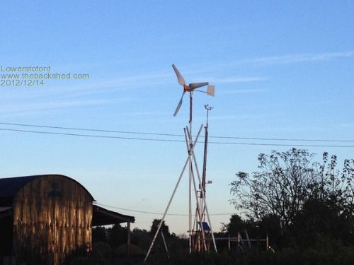

Lowerstoford
Joined: 30/11/2012
Posts: 29
Posted: 10:49am 14 Dec 2012
Turbine and tower MK1
Pre correcting the blades and adding bracing
Lowerstoford
Joined: 30/11/2012
Posts: 29
Posted: 11:03am 14 Dec 2012
Hi Guys
My original controller had built in "electro-magnetic brake control" or shorting of the 3-phase using transistors by the look of the board
I changed the controller for a Tristar45, before I discovered the blade error, thinking it was faulty.
We are having wind speeds of 12-14m/s and gusts of 20-22m/s at the moment.
I am using this controller in load diversion mode, the turbine has "aerodynamic braking blades", I am using the original dump load.
Is this enough to keep it from over speeding?
Do I need to add a braking circuit?
or should I use the old controller
I like the live read out of the Tristar and this setup gives me the ability to add cap mods, boost, logging or whatever I want in the future
The old controller has no logging and adding it would be a pain.
Any ideas? I don't want to wake up one morning to a broken turbine and possible other damage.
