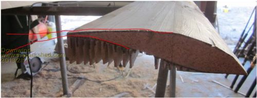

Thanks for the offers to buy blades , and I will probably do this if I end up building a better mill , but for this one am going the DIY route , keeping my mind and body active , and keeping me out of the pub
Anyway had a play with the abs blades , tried to get the GOE222 profile into them as everyone keeps saying this is the gun profile
Took about half an hour to rough out the shape , but as downwind said it is just to soft and bendy , so scrapped that idea .
Next bright idea , am making some timber ones , I have a nice pile of shavings starting , and have got three blades roughed out , have to see if I can borrow a decent plane and sander now to go any further

for starters i would try to carve a taper tip blade, the GOE222 profile is great as a mass produced length blade, but it simply works too well, to the point you cant stop the buggers in strong winds.
A better profile will give the same torque but better control as the blade will reach a stall point in rpm to power, so hence control.
If you intend to carve your own blades then you may as well adjust the design to be better suited.
There is a hell of a lot to understand in a simple blade design, but it can be basic if you have some understanding.
I just seen Glenns post and in many ways i agree, the profile dont need to be perfect to work, even cricket bats will work if the wind is good enough.
A lesson i learnt is to view the air flow over the blade as splitting the air on the leading edge and joining it back together on the trailing edge, its the whole function of the blade, now if you get this wrong as i did, what happens is the next blade coming into the dirty air has turbulent air to pass through. (think F1 aerodynamic problems)
This give a blade whistle noise at the tip and over all effects the blade performance , and from what i see in the photos you are also doing the same mistake as i did with the profile of the top side (concave)
Please excuse my lack of drawing skills to try to show the problem in air flow across the blade profile.
Also feel free to carry on with the current profile as it will work, just not as good as it can be.
A belt sander is a better tool for the next stage than planers etc.
With a course 60 grit belt you will tear it down to shape easy from there and at a controllable rate.
Balance will be your biggest problem and its the number 1 thing you will need to get right, so weigh the blades every so often to see which blade needs material removed to adjust the weight, up to 50 grams difference can be adjusted later, but a few 100 grams will cause problems.
