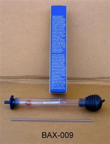

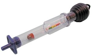

Posted: 07:03pm 02 Jan 2013
I wish I could find someone that sells these.
I dont want the little brother
It is a Gefo hydrometer, I know someone imports them but I have trouble finding a retailer, I have seen a marine supply place that stocks them, but cant find it in my bookmarks.
If you need to check the calibration of a hydrometer, you can weigh a known quantity of distilled water (or acid from a flattish battery) and take a SG reading then the same quantity of fresh or charged acid, weigh it and compare the ratio's between the weights and SG readings.
The beer guys do it with sugar dissolved in water, I have tried it with brine (salting meat).
Then plot the two points on a graph, draw a line through it, do the same with the weights and there you have a little chart for calculating out any error.Edited by yahoo2 2013-01-04
