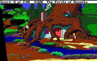

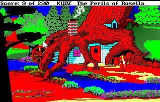

Nick
Joined: 09/06/2011
Posts: 512
Posted: 03:25pm 20 Feb 2013
I agree. As it is, it's fine.
... but that extra 8 colours will make games look better!
Here is a 16 colour (RGBI) image taken from the graphics adventure game off the PC called "Kings Quest"...
And here is the same image in Maximite 8 Colours...
The question is, is 16 colours really worth the effort?
