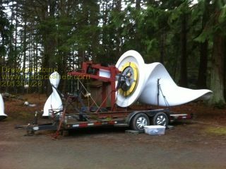

I'm taking the turbine into Victoria (B.C. Canada) to show at a conference on sustainability. Thought you guys might get a kick out of seeing it ready to ship. I'm sure it'll gets some interested looks on the highway! You also can see the Alt, yellow ring is the lower magnet array, gray inner ring is the mounting plate for the coils.
Soon I'll be removing it all, to install a proper lower bearing. Was a botch up in the way it's put together, right now the bearing arrangement is a bit ugly. When I have it apart I'll be changing the magnets from the 1x1x4 ceramic to 1/2x 1/2x 3" rare earth. This will also allow the winding to be a bit shorter.

Posted: 07:52pm 27 Nov 2013
Hi Drew;
I must say, That is a great looking piece of art.
I have another suggestion for you about the choice of magnets.
Several articles I have read in the past point out the desire to have the magnets wide enough to cover the coil face and also to almost bridge the gap between coil pairs or overlap slightly.
Attention to this detail will improve the wave form.
1/2 mags. don't give much room for coil winding.
Its Looking Good.
-------Cheers, Roe
Posted: 09:14pm 27 Nov 2013
How much power do you expect to make from that machine?
Just looking at the size of it, the area facing the wind isn't that big. Since we can work out how much energy can be extracted from a cross section of the wind, its pretty easy to work out how much power a windmill, be it vertical or horizontal, can be expected to make.
If you know the height and width of your turbine, work out its area, probably using area of a triangle maths.
I'm guessing 2 to 3 square meters facing the wind.
