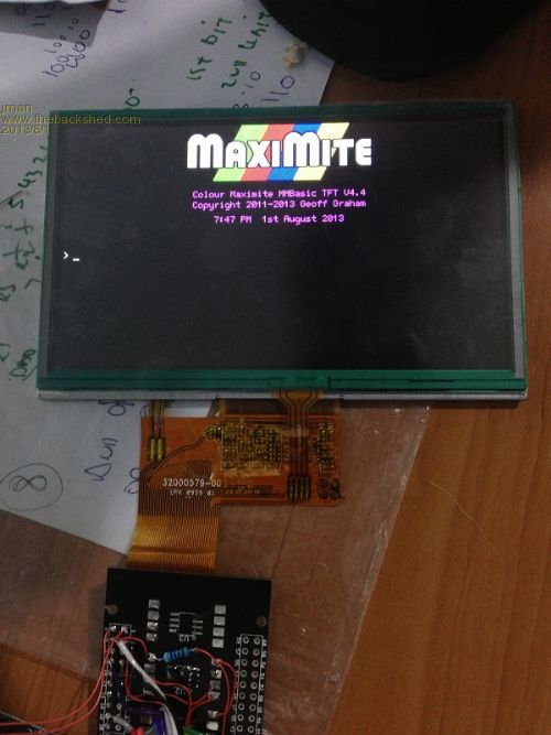

Posted: 10:03pm 31 Jul 2013
Hi
I have managed to get my TFT 5" screen to work as it has the same resolution as the 4.3" screen
It is connected to a UBW32
I cannot seem to get the touch to work
Looking at the source code I see the following
#define TOUCH_OFS_X 63 // on our screen 63, measured by ADC
#define TOUCH_MAX_X 955 // on our screen 955, measured by ADC
#define TOUCH_OFS_Y 115 // on our screen 115, measured by ADC
#define TOUCH_MAX_Y 860 // on our screen 860, measured by ADC
Do I need to measure my touch panel as it is 5" not 4.3" and use the measured vaules?
If so what would the procedure be to do this ?
Any help would be greatly appreciated
OA47
Joined: 11/04/2012
Posts: 1051
Posted: 12:16am 01 Aug 2013
By the jottings behind the TFT it looks like some heavy thinking was required, good work . Sorry I cannot help with the touchscreen.

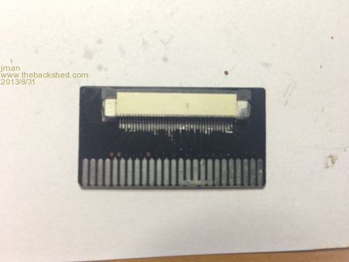

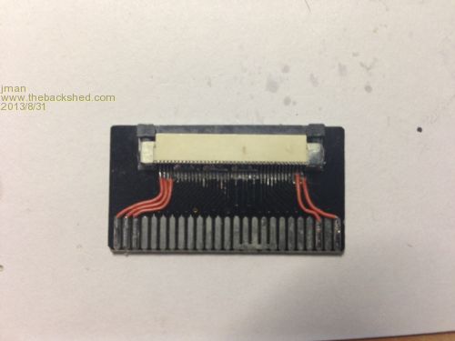

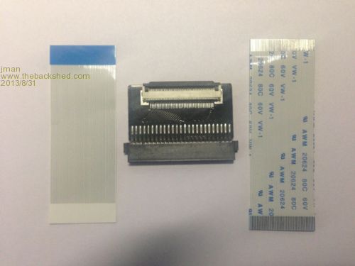

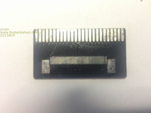

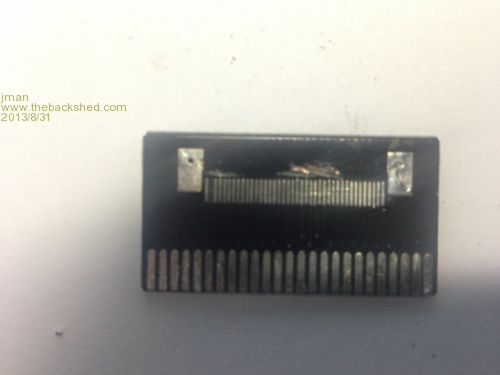

40 Pin Connector Adaptor
I bought some of these from DX ZIF Adaptor thinking they would make a great cheap adaptor for the FFC connector on the LCD.
This turned out to be a much bigger task than I first imagined
Step 1
Strip the PCB
Step 2
Cut the traces under the FFC connector
Step 3
Solder the FFC back onto the PCB
Completed Adaptor
Add wires to complete the pins that have no traces and solder the colour pins together
on the FFC connector
I have since found these on Ebay FFC Adaptor
Only thing the edges of the FFC don't seem to have any copper to solder the ends of the FFC connector to !
Hope this helps any others that are looking for cheap FFC adaptor
