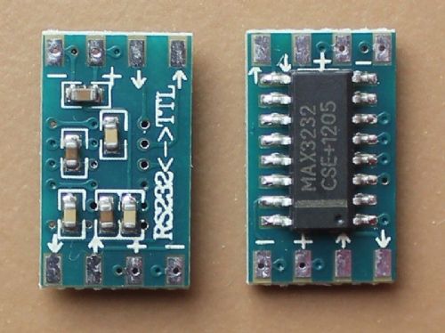

All is not lost. RS232 to TTL converter
At 9.4mm x 15.9mm they appear to be not much bigger than the MAX3232CSE chip. The soldering looks a bit rough. Edited by BobD 2013-11-21

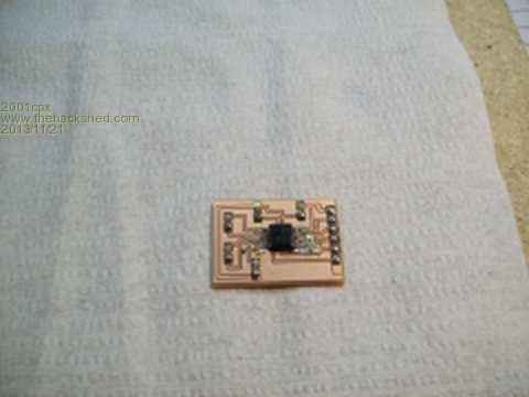

buy on ebay,check previous post from other members or build your own(if you have chip in stock,like a have) you will never having problem in the future
cost here for max3232 ssop w/Pcb made with my CNC no more than .50 cents
(buyed max3232 ssop in china (100 for 7$)
(No rts/cts on this cheap pcb,only RX TX)
on CGcolormax max232 is not wired,you can wire it to 14-16(or another port) on DIL

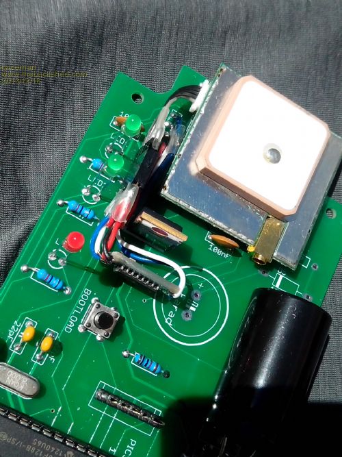

Info for those using the $15 EM408 GPS unit with RS232 output from DX.com.
I've just finished building the GPS Tracker from Geoff Graham's article in the Nov 2013 Silicon Chip magazine. I used one of the $1.60, RS232 to TTL converters as per Bob's link above and it's working well. As he notes they're tiny and can fit within a lot of projects. Here's a photo of them.
There are 16 pads on these converters but it's not as bad as it sounds. The + and - markings are obviously the power supply (3.0 to 5v) but the supply and ground are all connected to each other so that uses up eight of them. The other pads are the two pairs of RS232 and TTL send/receive connections and are clearly marked on the bottom (cap side). One set of TTL/RS232's I/O's are on the chip (MAX3232) side and the other set are on the bottom. Note that the supply and ground pads are plated through but the I/O pads are not.

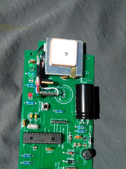

Here's a photo of the GPS module area of the Tracker with the converter installed. That's it on the other side of the TO220 mosfet - it's smaller than the 5 pin male/female connector I added so that I could remove the GPS module.
Here's another shot of it.
