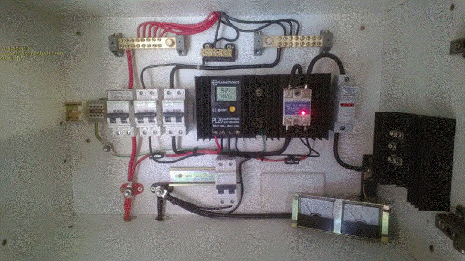

So I connected it all up today while the weather was overcast...IMO a good time to give things a bit of a pre connection test while current is low.
I think there is an error, actually, I know there is an error...om the SSR side of things.
PL20 Settings.
PROGRAM - 4, LSET - 10, PWM - 3.
Problem.
Volatage reading on the PL20 was 14V and on BOOST to charge to 15V, with one panel (200W 12v)connected showing 11A.
Connected another 200W 12V panel to the - bus feeding the SSR S-, ammeter reads 10A still at 14V....then I measured the voltage on the main positive bus and the SSR - bus and the voltage went to 17V...a bit high I would think. Turning the SSR feed off this reading went to 21V...unconnected open voltage, so it seems as though it is connecting. Then I connected another panel to the main positive bus and the SSR S- bus and the SSR stayed at 11A and the voltage went up to 19V. Then it stopped completely.
Do I need a reverse blocking diode on the Solar Negative feeding the SSR...Plasmatronics literature says I "will need a reverse blocking diode on extra connected solar arrays"...do I put one in the negative feed in?

Good to see a Neat wiring Job!
You have the G - Set on 3 this is PWM , I would say the batteries were charged and the PL20 was Regulating the Batt V then it switched out of boost to Absorb .
You could try setting G-Set to 0 or 1 as this will slow things down to see what is going on , you can also manually switch the Boost cycle back By long presses when reading Batt V..
You should have a reverse current protection diode on the SSR control.
I would think Blocking diodes would be fitted to the Solar Panels.
Also check current is passing through the SSR correctly , it appears you are correct,Edited by fillm 2014-01-07

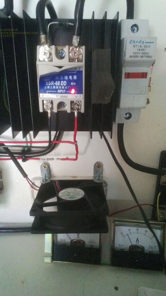

Wally,
The catch diode is on the wrong side of the SSR , it is shown in the PL Wind it should be accross the load terminal and B+ . It is best fitted at the PL or can be accross 3 and 4 on the SSR . Bar on Diode goes to B+ or 3.
You might need to try set LSET to 11 ( YOU MUST NOT USE PWM 2 or 3 WITH 11) as I think you set up is working in Reverse , when your B voltage reaches the Volt setpoint the solar on the pl is regulating and then the SSR turns on this will increase battery Volts with the external and regulate on the PL , one is fighting the other.
Check if this is the case , apply a load and drop below Bat V set point the PL will show amps in and the ext PV will turn off .
Test first before any changes and fit the catch diode.
I ALSO MIXED L SET TO G SET IN THE PREVIOUS, sorry I mixed them as you are not using Gset.

I honestly thought something was not right with the catch diode. The download from Plasmatronics which was written by RPC states "a catch diode should be placed across the output of the SSR (band of diode to the battery negative side)". Now if you go to the RPC website and look at their literature now it doesn't even make mention of a catch diode.

SUCCESS!!!
Thanks for that Phill. Twas the catch diode I reckon... and I put in my good SSR too so it was one of the other. Left the settings at LSET = 11 and PWM = 3. Odd that on the literature it said to put the catch diode across 3 & 4..I thought it seemed unusual.
I don't think the idea here is to "divert" as you would with wind and to use the SSR to shift current but rather use the SSR to duplicate the actions of the PL20. So LSET is off when a function wants to disconnect the diversion load...
Well...I have 1 x 120W 12V panel connected to the PL20 and 3 x 120W 12V and 2 x 200W 12V panels connected via the SSR.......had 9.7A at the PL20 and 40A at the SSR at 4pm...not bad...beat the 10 - 20A I was getting.
I cant quite tell but I was at 13.9V when I did these readings so in all it would be 135.8W (from a 120W panel?..it is pretty good sun today I guess and windy) and 556W from the rest...the 2 x 200W are not in prime position though so it's understandable.

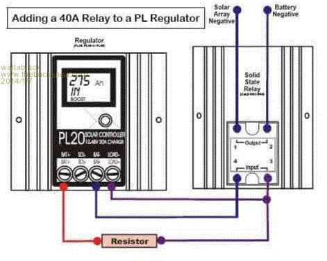

Below is a copy/paste of the download available from the Plasmatronics website...
This is exactly how I have it set up (excluding the usual PL20 wiring which is not shown in this diagram)but at the bottom of the text is states to put the catch diode on the SSR 1 & 2 terminals.
BELOW IS THE DOCUMENT FROM THE PLASMATRONICS WEBSITE.
Phill, on your test did you have it wired different than how I have...I think this is causing the confusion.
Increasing the Charging Capability of Your Plasmatronics PL Regulator
This configuration is used to handle currents higher than your existing regulator’s maximum rating without having to replace your regulator with a larger one. It is also used to increase the capability of large systems already equipped with the PL60. Extra strings of panels (up to 40 amps per relay) are connected to the battery bank as follows:
The battery negative wire is connected to terminal ‘2+’ on the relay, and terminal ‘1’ is connected to the extra solar array negative (assuming the initial solar array is being regulated directly by the PL regulator). The normal operation of the regulator is thus duplicated at the relay.
The regulator program settings and the value of the resistor are as
follows:
(Regulator is set to REG: 4, LSET: 10, PWM: 3)
(Resistor values are; 220. for 12v, 440. for 24v etc.)
Note: If you wish the regulator to measure the current going through the relay, then a Plasmatronics shunt adapter and external shunt will be required.
Part used in example above = Crydom D1D40 SS relay (needs large heatsink, 80W @ 40amps!).
12V systems can use a lower cost Jaycar relay = SY4086 (needs a lot smaller heatsink).
Also Note: Extra connected solar arrays will need reverse blocking diodes (unless the solid state relay used is a reverse blocking design) and a ‘catch’ protection diode should be placed across the output of the Solid State Relay (band of catch diode to the Battery Negative side).

fillm
Joined: 10/02/2007
Posts: 730
Posted: 06:48pm 06 Jan 2014
Take the resistor out, B+ goes to T3+ on ssr , then T4 - goes to the load term ( the SSR shoud be 3~32VDC ), Lset 11 PWM 1 and it will work .

  fillm said   Take the resistor out, B+ goes to T3+ on ssr , then T4 - goes to the load term ( the SSR shoud be 3~32VDC ), Lset 11 PWM 1 and it will work .
I don't know why it has to be so complicated , the RPC way still uses the L term so there is no benefit to free up a terminal, So you don't get PWM on that array .... So What.... The added array is for Bulk Charge,the PL can still regulate PWM with 20A which is more than enough to do Absorb and float .
If you want to go the RPC way then do what they say .
PERFECT....BIG THANKS PHIL
So simple....I do not understand why the other way was even documented to be honest.
