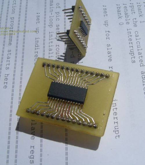

@ TZAdvantage,
I have got one each of the data expander and PIC1503 you sent fitted to an adapter board so that I can plug into a bread board for testing. Photos show I was a bit heavy on the tin paste but at least there won't be any cracks in the tracks.
I'll start with the data expander first run off the MM I2C bus and then work on the translation of the F88 to F1503. It is going to be 40C+ for the next couple of days and too hot now to work outside although the back shed is double leaf masonry and a lot cooler than outside.
Anyway, it will be a chance to sit back and relax a bit and see if I can get the grey neurons working.
Thanks again Downwind for the SMD vise tool.Edited by MOBI 2014-01-15

Handy little adapter boards, they look good, and a bit extra tin doesn't hurt.
Even with some source code as a background. :)
Here it is 'winter' and about 25C. I am working like crazy to get the MakerSpace ready, as Wednesday evening we will have our first meeting. Lower temperature and humidity is a blessing.

Posted: 02:31pm 14 Jan 2014
Drat!
I made the data expander adapter board one row of holes too wide so it will plug into the bread board but I can't access one row of pins. Never mind, I have plenty of MM, MF and FF jumper leads. It just makes the set up a bit messier. I should be used to that by now
I think I have the I2C PIC16F1503 code done. It compiles (assembles) but doesn't mean that I have got it right. Suck it and see? Need to get the expander going first.

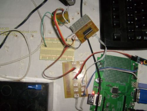

The MM i2c is connected to a two row i2c bus which is connected to peripherals. The bus is connected to the bread board which is connected to the expander adapter board. It is all a bit fuzzy (focus and explanation), but it is working. The LED display was for getting the bus working and connected right as I knew it worked.
There seems to be a million and one instructions for this 16 bit expander. I'll work on getting a basic "blink a led" first.

The logic analyser and MM.I2C all say it is working and in fact most of the commands do what they are supposed to except for reading the input pin data.
There are two 8 bit ports that can be configured (software) as individual or combined dependent on a bank select bit. Things get tricky here because the 22 or so internal registers all get different addresses if you change between bank 1 or 2. I must admit, this is the first i2c device that has me "temporarily" stumped.
The protocol description looks normal but outcome is not. It seems to be reading the register address and not the contents of the register, nor is it stable. Another example of Microchip data sheet ambiguity.
I keep plugging on...not ready to quit just yet.

Browsing the web shows that many others have had problems with the Microchip data expander data sheet.
Anyway, the I/o pins do what they are supposed to on output but I don't think the unit likes floating input pins even though it has switchable weak pull ups fitted.
Half way there. I have a led flashing. Wow
Bread board starting to get a bit cluttered.
David M.
