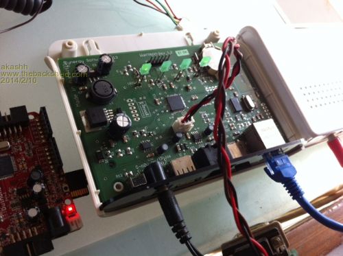

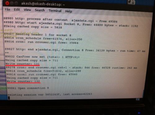

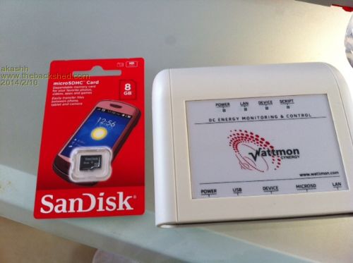

Alright, I have set up a script to open a file, read a counter value, increment and write it back once a second. I have included a couple of pictures of the setup, and the code I am using. This should give us results pretty rapidly, within a couple of days I would guess since this modified the fat and the file 86400 times a day.
This is the Wattmon device I am using and the SanDisk 8GB brand new SD Card
This is the setup (I had to open the cover to get to the serial console)
Here is a view of the console with the output of the script underlined in red, counting once a second.
Here is the code I used:

akashh

Akash, it would be good to know the exact product you are using. I use SD cards in my camera and it would be useful to have one with staying power like you have just demonstrated. You must be using only part capacity to be able to use wear levelling?
Bob
akashh
Joined: 19/01/2014
Location: India
Posts: 115
Posted: 10:03pm 12 Feb 2014
I am in fact repeatedly writing a file, it may or may not be using the same sector - hard to tell (I suppose I could trace the MDD code and figure it out) - but the FAT is definitely being written to multiple times. From what I understand, the wear leveling algorithm for SanDisk products will take blocks within the same area and spread out the writes (transparently). So writing to a particular sector will in fact use a different area of the SD card each time. However, there seems to be a limit to the amount of space that is used by each block, it does not span the entire card but only a small part of it - this means that you would have a finite amount of writes allowed to the FAT sector. I'll let it go for some more time and see what it counts to.
It's a Sandisk 8GB class 4 card.
