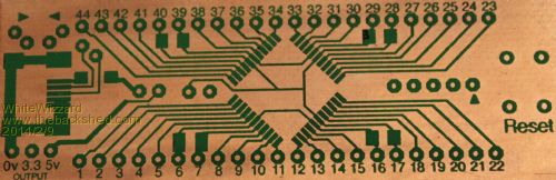

If you can make it a 3 pin header for power, yes that is even better.
However you may have to move the LEDs together, or something similar to make room for the header.
I'll assume there will be a small assembly text file, and schematic to go with the files, so I would make it voltages out only, and mention it could be used as voltages in, if the USB input isn't used. Mind you, I would expect that the user would be familiar enough with the board and schematic to be able to configure what he wants/needs for development, or the final application.
Re the 6 pin header, sorry I should have enlarged the question enough to make it fully understandable.
PICkit 2, and 3 is a 6 pin header, (as are the clones) so I felt there would be less confusion if you placed a 6 pin header there, even if the 6th pin isn't used.
Which bring me to my final point:
Text. Will you have a text overlay?
It needs a "1" near pin 1 of the 44 pin DIP socket, and "1" near pin 1 of the ICSP socket.
When it is being manufactured by a factory, or an individual, it is only built once, so other text such as LED polarity will generally be obsolete after being manufactured.
If you find room for text, then place as much as you can on either side of the board.
Even if it just says "+", "G", "5", "3". It will all help.
Cheers Don...

Posted: 11:09am 09 Feb 2014
Hi all,
Based on Don's feedback I have slightly modified the top PCB.
This is a pre-etch photo to show the following:
* Pin numbers (equate to PIC pin numbers)
* Group of three power output pins labeled 0v, 3.3, 5v (lower left corner)
* Pin 1 identity on ICSP
* Date flow direction 'arrows' next to coms LEDs (Rather than say Tx & Rx which can get confusing depending upon from PC of from MicroMite's perspective)
The numbers are about the same size as the small numbers found on a breadboard. I don't want them too big - just big enough so you can go straight to 'pin x' without having to (mis)count pins.
I will etch this in the morning as it's too late now.
In the meantime please let me know about any more suggestions you may have!

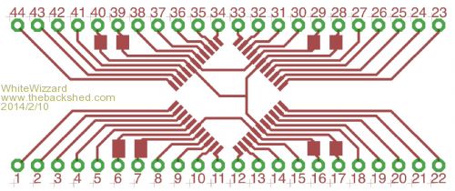

Posted: 02:45pm 09 Feb 2014
Hi All,
In a rush to get something available to you all, please find below the file required to allow you to create your own PCB for the 44pin MicroMite.
2014-02-10_004139_MicroMiteDIPv2.brd.zip
It will create a 44 pin DIP allowing you to use it in a breadboard in a similar way you would use a 28pin PIC (but obviously with all the extra I/O pins).
To clarify, this isn't the file to create the more advanced Eval PCB/Module which I am now finalising the design.
So for those of you who don't currently have the ability to test Geoff's software for the 44pin MicroMite; i.e. if you don't currently have any TQFP adaptor board, or you are still awaiting delivery, then why not have a go at building this simple PCB!
This is an EAGLE .brd file from which you can print out the artwork for the single sided PCB. If you don't have EAGLE you can download a light version for free from the following link:
Free EAGLE download
Hoping this will prove useful to some of you.
Phil
