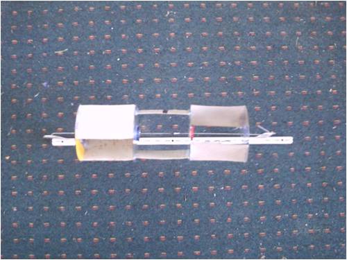

what a really simple vawt. I wacked one together in about 10 mins with a bike wheel and plastic panels cut out of 20l drum, and it works! quite torquey too.
It just "doesnt look" like it should work but it does. Great stuff.

To bring a little balance to this topic, I jammed one together too and mine just sat there and mocked me; never turned! I'll leave it for some heavier wind before turning it into a paper weight.

The Miller should start up easily in light winds. Did you add the little bend at one end of each wing?

I think maybe I have the rotors too close together. I used a circular aluminum platform I'd already spun up on the lathe for another project and it was kinda small. It came with a 5/16" hole and set screw already installed, so I grabbed it.
I haven't trashed it yet; and yes, I put the little bend at the end of each blade, but my bend is flat and now that I look, the ones made by others are slightly curved. Don't know if that matters.
I'm okay with all this though. I only built it to get it out of my system. I've "officially" sworn off VAWTs in favor of HAWTs. Even as I sit here at my computer, the leaves in the trees are more or less motionless, yet my 1-meter 3-blade HAWT spins lazily (no load) out by the greenhouse. That's what I mean; HAWTs just work better.

There's absolutely no wind, but I strolled out to the greenhouse to check my maters and it hits me square in the face: I put the rotors on backwards! I had the little bent ends facing each other on the inside!!!!
Makes a dandy wind vane that way, by the way! I'll give it a second go before I turn it into another fancy paper weight.

I am going to build a 1.2 metre square tin miller next. Probably use a car wheel and front bearing hub.
my little plastic test miller spins about 140 rpm @ 20 k winds, but its very roughly built.
