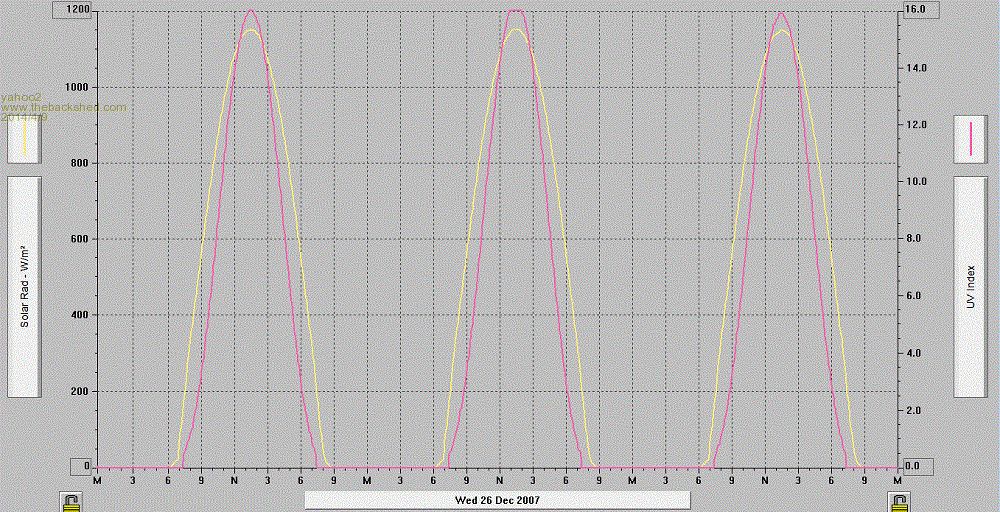

yahoo2
Joined: 05/04/2011
Posts: 1166
Posted: 11:39pm 08 Apr 2014
Uv is only good for frying bundy drinkers! visible spectrum is what we are after.
Infra Red and UV dont have enough kick to dislodge an electron.
Here is one I prepared earlier! Christmas 2007 temp was low 30's Celsius.
visible radiation on the left (yellow) UV on the right (appropriately pink)
