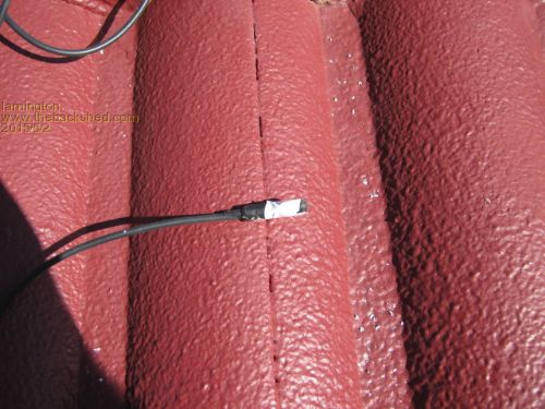

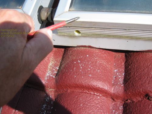

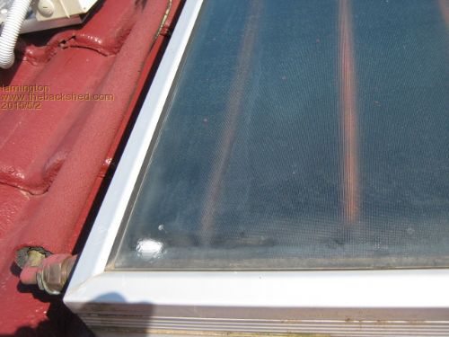

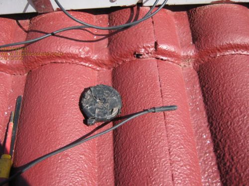

Posted: 07:45pm 01 May 2015

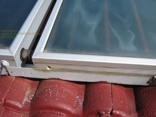

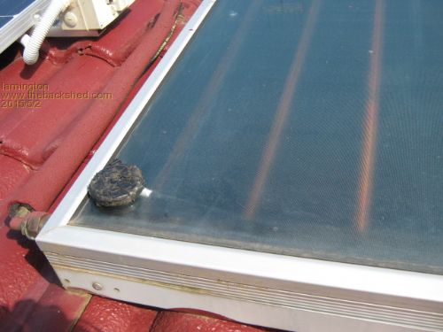

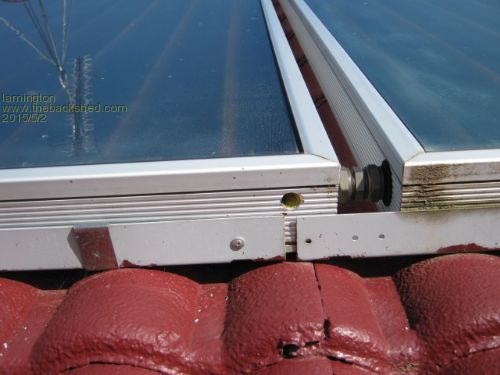

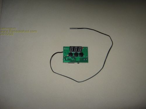

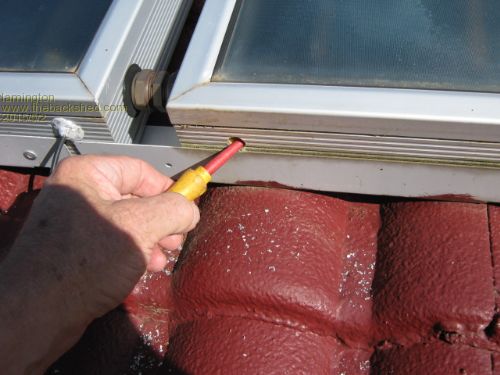

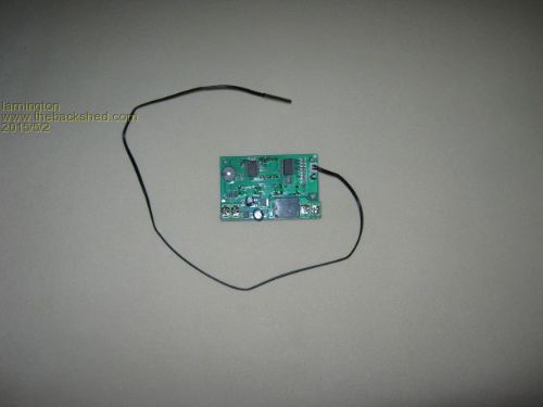

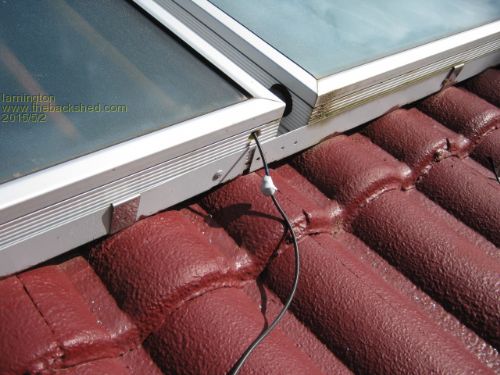

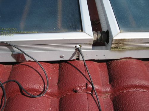

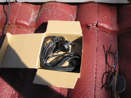

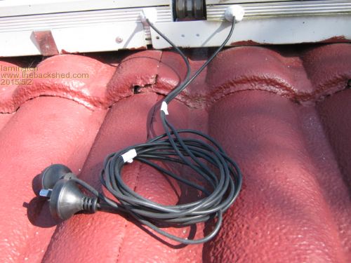

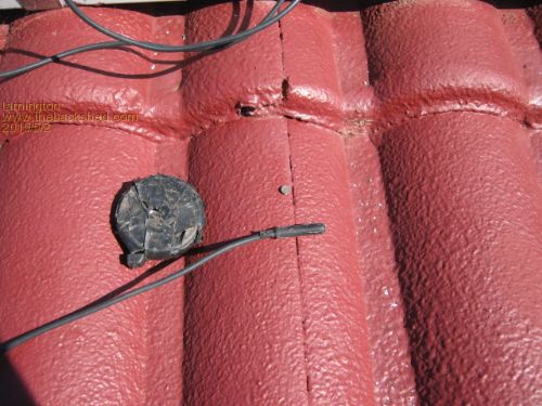

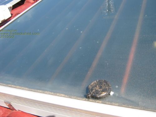

Hi Folks
Well I did it I installed 2x15 watt reptile heaters in my hot water panels and I am in the process of wiring up a thermostat for them.
The reptile cord heaters cost me around $40 including postage from Sydney and are of the waterproof type and run on 240v and have a controlled temperature so not to burn themselves out.
Plus the thermostat cost me a princely sum of $15 from guess where (e-bay)
Anyway I have enclosed some pics of the installation, if you are interested please leave some comments as I would gladly receive accolades and constructive criticisms.
A few pics out of sequence my apologies so enjoy

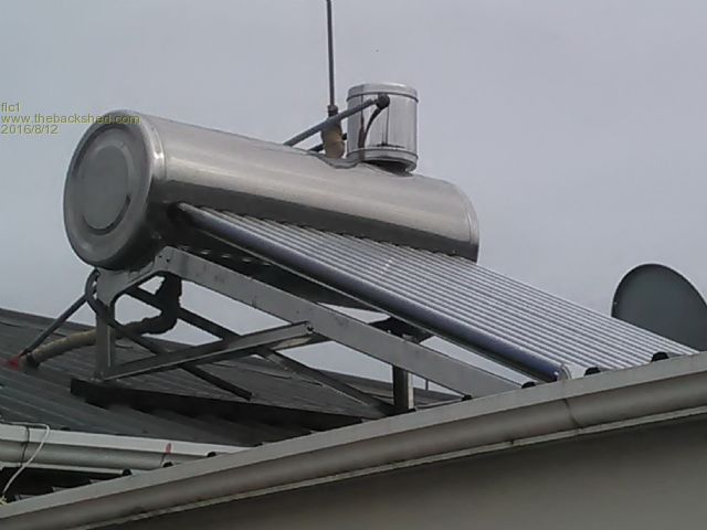

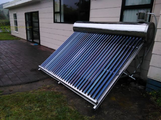

flc1
Joined: 20/11/2011
Posts: 242
Posted: 09:14pm 11 Aug 2016
solar vacum tubes in a -4c frost
Edited by flc1 2016-08-13

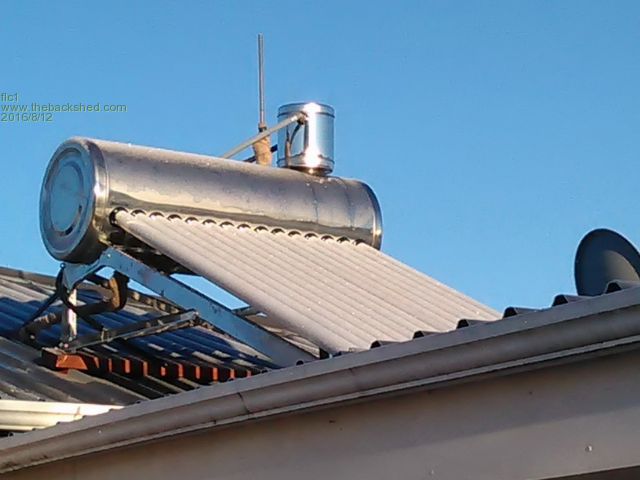

flc1
Joined: 20/11/2011
Posts: 242
Posted: 01:48pm 12 Aug 2016
just glass n stainless steele, no copper tubes,, simple but works wellEdited by flc1 2016-08-14
flc1
Joined: 20/11/2011
Posts: 242
Posted: 04:11pm 13 Aug 2016
Our 300ltr solar water heater with a copper tube in each glass vacum tube. Too heavy to put up on our roof, would have to strengthen the roof. prev photo shows 150 ltr with frost on tubes on our roof,half the weight,

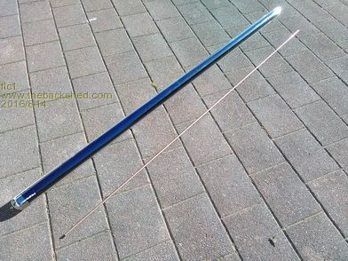

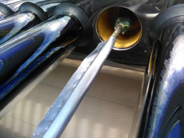

flc1
Joined: 20/11/2011
Posts: 242
Posted: 04:13pm 13 Aug 2016
photo showing copper tube insert into water tank, you can see the 2 inch thick insulation between inner water tank and outer tank, the 150ltr solar water heater on our roof has no copper tubes in vacum tubes,water is in the vacum tubes and heats buy thermosyphin, and from what I have seen with our systems here at home, the type with only water in the vacum tubes seems to be the most efficiant of the glass tube type.Edited by flc1 2016-08-15
flc1

flc1
Joined: 20/11/2011
Posts: 242
Posted: 09:19pm 13 Aug 2016
In my opinion, the copper heating tube is just another part that can fail, But with just the water in the glass tubes ,it can't fail unless you break a tube, and that rarely happens and they are cheap and easy to replace.Edited by flc1 2016-08-15

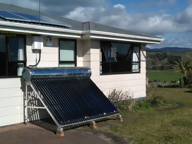

flc1
Joined: 20/11/2011
Posts: 242
Posted: 08:28pm 26 Nov 2016
new solar water heater, glass tubes are filled with water, which heats water in tank and there is a copper coil inside tank which has the water for shower,bath etc flowing through it, cold water in one end and hot coming out the other , heat transferr to coil from hot water in tank. this one is alot more efficent than the other one that had the copper rods in the glass tubes.
