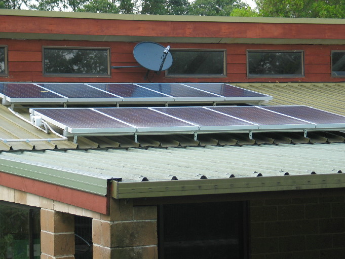

Hi guys a couple of pics of my 1.55KW system. 10x BP155 w panels connected 5 in series then two sets in parralel. Inverter is a Sunnyboy 1700w unit. So far it has rained for the whole two months since installation. We have still managed over 260KW hours, with a maximum of about 8.6 KWh in a day. Max output seen is 1770 W so the rumor that BP is down rating its panels to ensure compliance with their 12 year 90% performance guarantee seems true.
regards Robert

Hi Robert,
can you please edit your photo. This problem still seems to occur, and the solution has been posted many times.
cheers.
