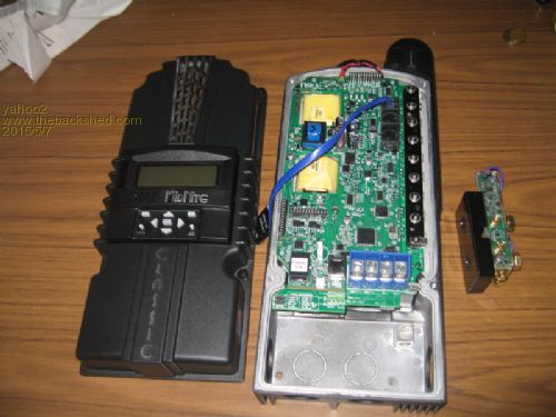

The last few bits and pieces are turning up for the permanent install. We have splashed a bit of money out on a couple of items but it has saved a few bucks in gear that we do not have to fit and gives us some extra simplicity and flexibility.
the solar controller is a midnite solar classic 150,
it is overkill for this situation as a controller but it has two handy features that I am hoping will justify the expense. the first is a a function called opportunity low on the aux1 output, this should let us switch the second bank of solar panels with a solid state relay at a voltage setting that is set slightly lower than the charge voltage settings on the classic itself.
This will give us a two stage power down so that we are not driving the batteries close to the end volts with everything that the sun is throwing at us. likewise the float settings can be staggered as well.
the second feature is the software to drive this

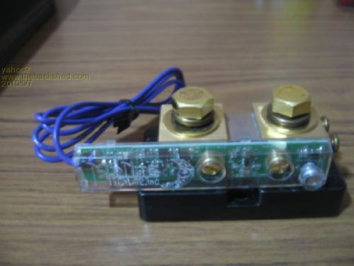

the whizbang jr
this is basically a 500A shunt that is connected to the negative battery terminal, the sensor sends the data to the classic.
this gives us a couple of things
- logging of the total power in and out of the system
- state of charge calculations that the controller can use
- calculation of battery health
- and most importantly, the ability to end the absorption charge on an end amps setting, not just time. This gets us around the problem of the batteries charging differently when they are deep or shallow cycled.
Without this bit of kit the classic controller can only see its own data, not the system as a whole.

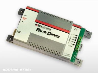

The last item is a morningstar RD-1 relay driver,
this will be primarily used to switch loads in and out depending on battery voltage but I can use one of the 4 outputs to drive two SSR's as backup charge control. This is just in case the classic 150 needs to be removed and sent away for some reason.
With some conservative voltage settings the batteries should run quite happily on the relay driver without balance charge voltages for a couple of months. If it becomes necessary to balance the batteries a pair of 12 volt chargers can be clipped to half a pack each and a manual balance can be done.
That's a lot easier than finding a replacement controller at short notice or running a generator 24/7. This is one of the benefits of the LFP bank and the independent Battery Management System I did not foresee, the fact that they can be cycled in the 40% to 90% State Of Charge range for long periods with little or no damage to the cells and no danger to the pack from over or under voltage is a real bonus.Edited by yahoo2 2015-05-08

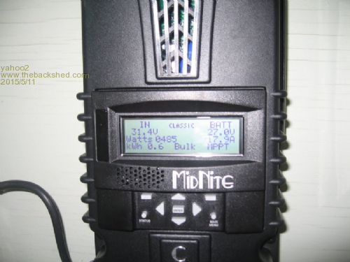

I have taken the opportunity on a cold and miserable day to swap the old PWM solar controllers out and replace them with the Classic 150 and whizbang junior. the higher voltages with the cold weather was making me nervous. I figure disabling the temperature compensation on them is just not worth the effort.
It was a good day because the cloud and intermittent sun meant I could sit and watch and tweak things under a variety of conditions.
A pretty trouble free install, replaced a few cable lugs and lengths of heavy wire that was not long enough to reach where it was supposed to. I rolled through the settings menus in about 5 minutes, disabled the temperature compensation, enabled the external shunt monitoring. I got slightly caught finding where to set the battery size and charge efficiency, there is a screen hidden behind the whizbang shunt status screen called setup, it is not in the main menu tree....and I had to look up the manual to get and explanation of how to set the "return to charge from float" (called rebulk).
I switched a bank of north facing panels on, the controller come out of resting mode and straight into absorb, I think I looked away to zero my clamp meter and when I looked back it was in float. Oops! well the batteries are full so I switched the panels off, fired the inverter back up and switched a heap of things on in the house to make a bit of room in the batteries to have a play with the voltage settings.
The first thing I found when I connected the north facing panels and the east / west panels at the same time, I was getting some backfeeding through the east/west panels. I didn't leave it running and have a poke around to see exactly where it was going because it was upsetting the classic 150, the charging amps were cycling up and down and dropping to zero and restarting every ten seconds or so. I had a bit of a think about it and probably the easiest fix is to solder in some diodes where the wires from the separate banks of panels come together at the PV circuit breaker enclosures.
So after some testing the volt settings are now
Absorb 27.9 (3.4875 per cell) timer 2 hours or 4 amps endpoint on the whizbang shunt.
float 26.8 (3.35 per cell)
rebulk 26.0 volts
Just before I left this afternoon we got a bit of decent sun and I got a complete cycle from bulk to float on the data logger. The voltage rose very rapidly above 27.55 volts so it looks like the Absorb volts could go lower, somewhere in the 3.44 - 3.45 V per cell range could give me the margin below 100% SOC that I am looking for.
The 4 amp end point is well below the recommended 20 amps (0.05C) that the EV guys use but it reaches this point in less than a minute after the charge controller starts limiting voltage. I guess I will tweak it again if I lower the charge voltage.
I watched it in float for 15 minutes after the volts drifted down and there was no charge or discharge on the battery bank, all the loads were supplied directly from the panels so I am very happy with that setting ATM.
I haven't programed a balance cycle on the EQ settings, we have decided to manual balance for the time being, the next one is in two months when the BMS and contactors are next due to be cycled and checked.
So there you have it! Not as exciting as watching paint dry but it had its fleeting moments I guess. Edited by yahoo2 2015-05-12
