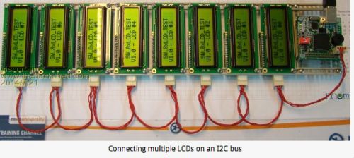

Hi BigMik and all,
Here is a cool pic of a few i2c lcds running together. How is your board coming?

Hi Jim, All,
WOW!! Love it... I thought, for about 4.3uSec that it was being driven by one of my MuPs...
