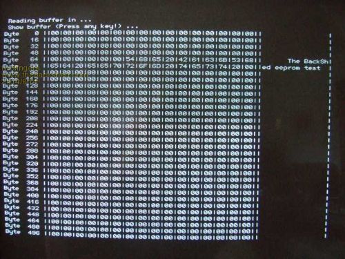

On my Duinomite the output from eeDump looks like this:
Perhaps this will work on your µmite also (needs no format$-function)?

  twofingers said   @Grogster
I think you'll confirm that for Byte Write, as in my code, no problems should be expected? Page Write has some advantage but it maks things more complicated. The Microchip datasheet says a 24C32 has a page size of 8 bytes.
Confirmed - and exactly right.
Byte writing is not a problem, page-writing IS.
...IF you page write, which is what I was doing in my application, then you can easily get yourself into a hell of a mix, which is what happened to me, until the guys over at the PICAXE forums explained pages to me, so I just did not want anyone here having that same issue.
The reason your screen-dump works fine, is cos you have the pause 5 after every byte write to the I2C bus, which gives the EEPROM time to commit it, so with that delay in place within the loop, you should have no problems at all byte-by-byte writing across the page boundry.
Try doing that as a page write WITHOUT the 5ms delay.

Sub eedump
Local i, j, y, L, RTCBUFF(4096)
I2CADDR=&H57 ' 24C32-DS3231
For I = 0 To 4095
RTCBUFF(I)=&H0
Next I
Print " Reading buffer in ..."
I2C open 100,100 'ENABLE I2C
For J=&H0 To &HF
For I=&h0 To &hFF
L=(j*256+I)
I2C write I2CADDR, 0,2,J,I
I2C read I2CADDR, 0,1,RTCBUFF(L)
If MM.I2C <>0 Then Print "ERROR! 1=NAK 2=TIMEOUT"; MM.I2C,j,i:End:EndIf
Next I
Next J
I2C close
Print " Show buffer (Press any key!) ..."
For I=0 To 4095 Step 16
Print "Byte ";Format$(I,"%4g");" ||";
For y = 0 To 15
Print Right$("0"+Hex$(RTCBUFF(I+y)),2);"|";
Next y
Print "|";
For y = 0 To 15
If RTCBUFF(I+y) >=32 And RTCBUFF(I+y)<=126 Then ' show ascii only
C$=Chr$(RTCBUFF(I+y))
Else
C$=" "
EndIf
Print C$;
Next y
Print "|"
wait
Next I
End Sub
