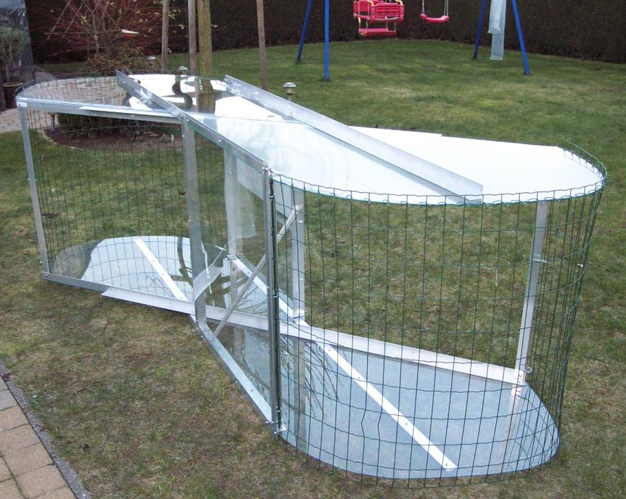

I've just joined this forum. I've made a couple of days ago a savonius (90cm high, 3m long). It's my first attempt... It's turning in the wind already at my parents house, because my garden is not big enough (not windy enough). There's no alternator attached, and now I'm experimenting with the blades. I'm covering the blades with plastic. I've already noticed that the blade design is not realy correct. Because when covering 3/4 of the blade, the results are better. In heavy wind it takes 3 sec/turn. In slow wind is takes 7 sec/turn.
I detached the savonius when there's heavy wind.
I want to test the following in the near future : I want to put little flaps in the little holes on the wings. Flaps that only opening in one direction. So the flaps are closing when the wind is blowing on it, and they open in the other way... I think it's possible because the windmill is not making a lot of turns/minute. So the flaps have time to open and to close. Something I don't know is what noise the flaps are going to make.
It's not that I need the electricity, it's just for fun.

Welcome to the forum and thank you for sharing your project so far with us. Your English is very good so no need to worry, it is easy to understand.
That is quite a large construction you have there. I like the idea of stacking another on top but at 90deg rotation. I imagine a more even applied power when turning a generator, but it makes the structure more complex.
I have a few questions if you don't mind,
What are the little holes in the wings you are going to cover with flaps?
At 20 rpm what type of generator do you plan to use?
Will it need gearing to higher rpm?
With these large diameter, high torque low revving drivers such as savonius and water wheels, I think they would suit a very large diameter homegrown generator. Perhaps using low quality but many magnets and small but many coils. I have not seen any reports of this being done though I feel sure someone will have tried it by now. I wonder what the results were?
Look forward to an update on your wind generator as it develops further.

In Belgium a lot of people are living in a relatively small country. HAWT Urban windmills can't be used because of noise and danger. In fact there're as good as no urban windmills in Belgium. I've choosen to test a windmill who makes not much turns/minute because people don't like to see fast rotating devices in their garden (or neighborhood). And something that makes no noise, even with high windspeeds. I know that this type of windmill does not produce a lot of power compaired to a VAWT. But a VAWT is out of discussion because of the mentioned reasons. The first thing I need to do is attach the Savonius on a strong concrete plate because even with 60Kg of stones, the wind blows the windmill on his side. After that is done, I'm going to use a little software to count the turns/minute and the windspeed. Before I want to make (or think about) generating electricity, I'm gonna test, play and measure (statistics) the performance after modifications on the original design.
This is a hobby, so this will take some time. I think that I can make the concrete plate in a couple of weeks.
In my parents garden the device is already turning, so that motivates me take the next steps.

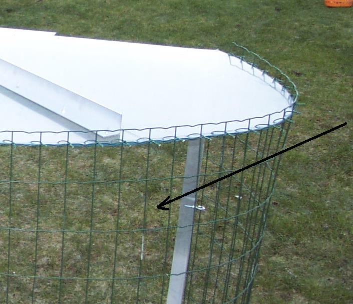

In the picture below I show you the 'holes' I was talking about. (A couple of hundreds holes...). I've found some sheap rubber thin elastic plastic. I need to cut some hundreds little flaps out of the plastic and attach them to the green wire.

Like most of us, time is not such an issue.
I can understand that 60kg of stone is not enough to anchor that to the ground and the higher you go with it, the more secure it will need to be. I'm thinking for safety at least 2 meters to be clear of children and people? And for wind as high as possible yet this will not be simple.
Would it not be better to sheet over all the holes rather than do each one individually? Or is the flaps an idea to reduce drag as the wing rotates up-wind? I don't know the dynamics involved so it's too difficult for me to guess the benefits if any. No doubt your prototype will give a good indication.
You may be aware that free-running will be vastly different to the running under generator loads especially if step-up gearing is to be used.
For your sensors, there are several ways of doing it. I like the simplicity of several small magnets on a disc rotating past a magnetic reed switch. What method do you like best? Are you using Linux as your operating system? It seems like you are all organized in that area.
Good luck with your project.
Cheers Gill _Cairns, FNQ

Exactly, the flaps are an idea to reduce drag as the wing rotates upwind. But the blowing wind inside the windmill is affecte too, so maybe I'll have to cover only the upper side of the wing full of flaps. And let the wind only pass through the lower side of the wing to get out of the S-shape windmill. I can't wait to see the results, if any
At this moment the savonius is mounted and turning on an inefficient recuperated axis. I do not care about this because it's causing some resistance like a little generator would do.
