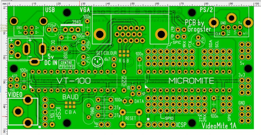

Hi Grogster,
Are those two links above the 5V DC IN text? If so, you need to label which one does the USB power which one is external power.
Posts: 10048
Posted: 12:52pm 18 Nov 2014
They were diodes, but I have changed them to a 3-way jumper link arrangement.
Annoyingly, you were right about the schotkky diodes' forward voltage-drop.
I was assured that Schottky diodes only have a 0.1v voltage-drop, but when I actually looked up the datasheet for the diodes I have been using, the forward voltage-drop is actually 0.45v.
That's still better then the 0.6v drop of 40xx diodes, but it is not the 0.1v I was told was the case with Schottky's.
So, the onus is on the user to make sure the polarity is correct with the 5v DC connection.Edited by Grogster 2014-11-19

Hi Grogster,
  Grogster said   They were diodes, but I have changed them to a 3-way jumper link arrangement. Annoyingly, you were right about the schotkky diodes' forward voltage-drop.
I think links are better, I believe that the 1N5817 is actually closer to the 0.1v drop (according the the specs) but I have not tested them. I have only had experience with the more common 1N5819.
As to polarity of 5VDC in, providing the way your design is for +ve on the `pin' and -ve on the barrel you should be OK as I have never seen a 5Vdc supply that is the other way round... (other voltages definitely...but not 5v).
The T-Block or header yes they have to be careful of polarity, which is another point, your overlay doesnt (yet) show the polarity for those power input options.
PS..
Very nice work Grogs, I will have to get one from you.

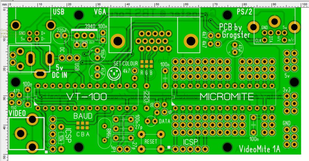

Posts: 10048
Posted: 03:05pm 18 Nov 2014
@ viscomjim & Mick - thanks.
I will be getting a batch of PCB's done very soon, once I am happy with the final layout. As there are no SMD parts on this one, ALL components should be easy for anyone to source.
@ Mick - yes, centre-positive DC connection - pretty standard. I will add text to that effect beside the socket and markings for the T-block and header.
EDIT: Here we are then.....

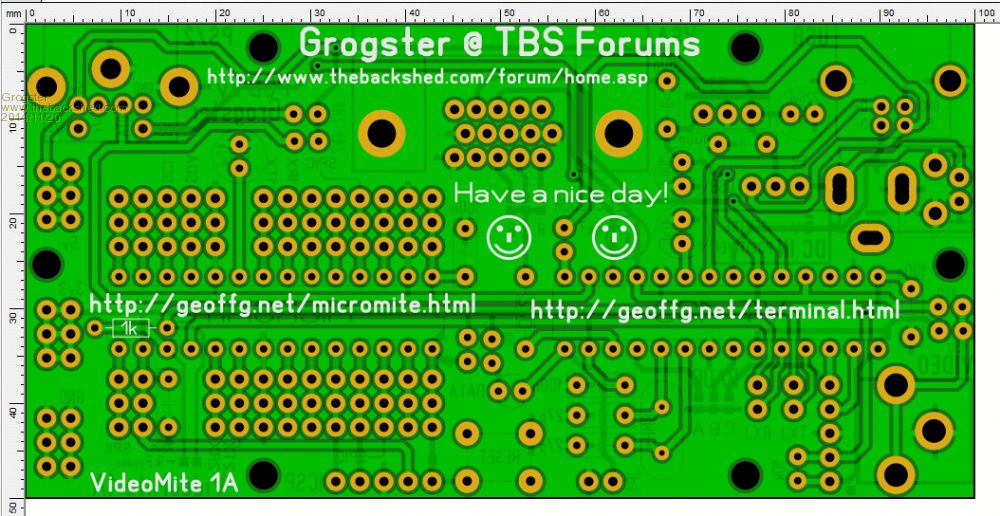

Top side:
Bottom side:
Edited by Grogster 2014-11-20

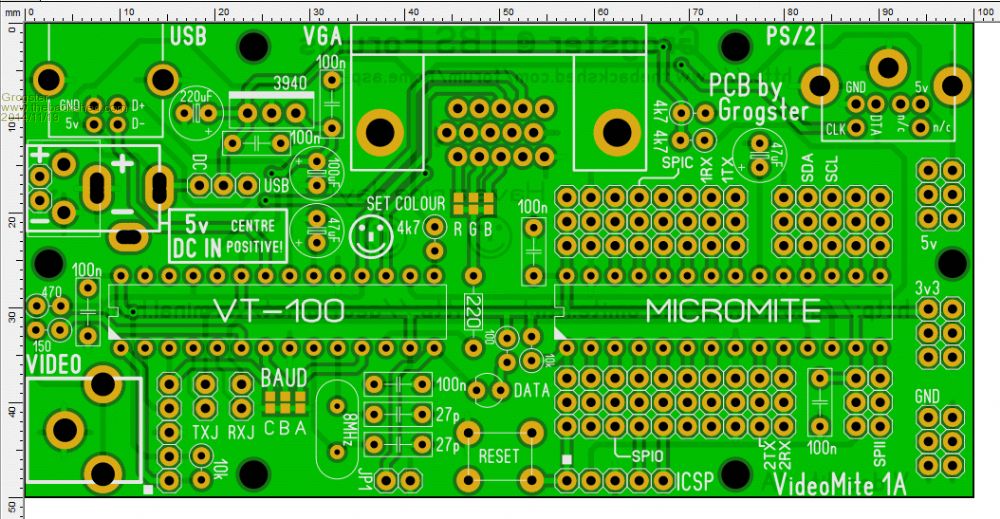

Hey Grogs is that left hand smiley face on the `back side' ME?
Minor Criticisms.
If you can make the + and - a bit bigger font for power input it would be better.
If you can move the USB from the jumper up and maybe r/a (with a line pointing to the pin if needed) then the CENTRE POSITIVE message can be level with 5vDC IN and the entire message enclosed in the BOX.

  bigmik said   Hey Grogs is that left hand smiley face on the `back side' ME?
It can be you, if you want it to be.
  Mick said  If you can make the + and - a bit bigger font for power input it would be better.
Yep, I can do that - will post updated image soon.

Here is the image with the changes you suggested:
EDIT: I have added two jumpers - TXJ and RXJ. With these jumpers in place, the uM is routed to the VT100. If you remove them, you can then use lower pins of those jumpers, and the GND from the adjacent ICSP, as a serial connection to the VT100 if you want to use it separate from the on-board Micromite in testing other hook-ups.
Likewise, you can remove these same jumpers, and then tap into the Micromite console, without the VT100 upsetting the mix by being permanently connected.
The normal arrangement, would be jumpers on these two points(and transfer code to the Micromite via the VT100's USB interface), but it gives you the flexibility to alter things depending on what you happen to be doing.

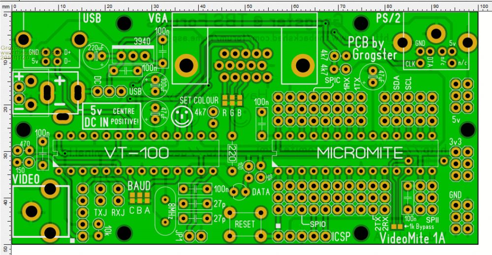

Posted: 01:21am 19 Nov 2014
Grogs - if you turn that TXJ jumper around 90 deg you might have room for the 5v adapter protection resistor if someone plugs into the Micromite direct, i.e. with the jumper out. (I assume that's the Rx into the Micromite).
Greg
Posts: 10048
Posted: 01:38am 19 Nov 2014
What value is that? 10k?
In series with the uM RXD, correct?
EDIT: I have assumed this resistor is 10k, but it can be anything. I have it installed on the bottom copper layer. Standard resistor. In series with the uM RXD.Edited by Grogster 2014-11-20

Posted: 02:23am 19 Nov 2014
No, 1K not 10K. Yep, in series to uMite RX. It might save a few puzzled, disgruntled users in future!

Posts: 10048
Posted: 02:28am 19 Nov 2014
OK, 1k. It shall be so labelled.
Is the 1k in series with the uM RXD still OK to be there for 3v3 operation?
I would prefer to be able to leave it there permanently...

Posted: 02:41am 19 Nov 2014
I use the 1K permanently in with a 3.3v adapter and it works fine. I just checked Mick's MUP V2 and he has a jumper to remove it you want to, when using a 3.3v one. I don't think you need to do that but it might be best to check with him.

Posts: 2981
Posted: 07:52pm 19 Nov 2014
Hi Greg,
I have found the same, that it still works at 3v3 with the resistor in but I suppose that there is no guarantee that all USB-TTL converters will work with the resistor there.
Posts: 10048
Posted: 08:23pm 19 Nov 2014
@ Greg & Mick - I will include the resistor by default, and add solder blob pads to allow you to short it out if you need to. That should cover both possibilities.

Posts: 10048
Posted: 08:57pm 19 Nov 2014

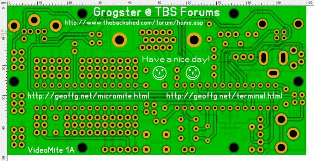

OK, here you are then. This is the board I will be ordering tomorrow.
TOP LAYER:
BOTTOM LAYER:
