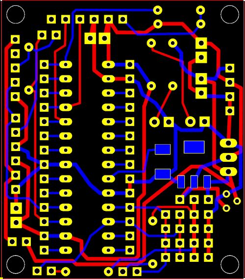

Lads,

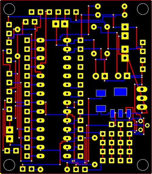

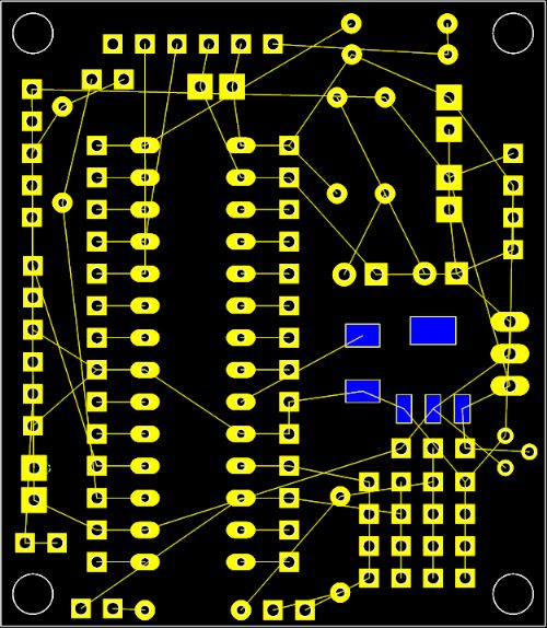

Just as an example of the internal router I have used my first effort of doing a PCB using AUTOTRAX DEX (ok 2nd as this is my Ver 2 MuP) I have removed the copper pours for clarity.
Here is the board unrouted and showing the nets loaded.
Here is how DEX routed the PCB
After maybe 2 hours of work I have cleared it up a fair bit and this is what I ended up with.. No vias at all.
I now try to make every track on a 45 or 90 degree angle and avoid 90 degree bends, but this was my earlier efforts.

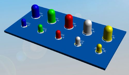

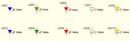

Posted: 11:17pm 02 Feb 2015

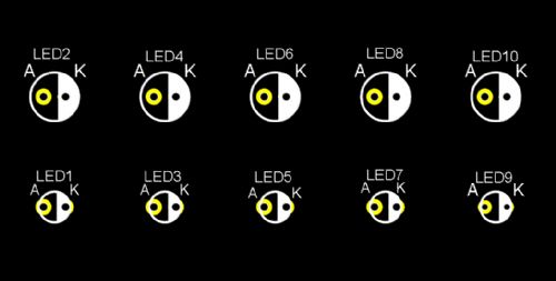

Hi All,
I have been reconsidering my thoughts on 3D and decided to create my parts with 3D models.
I have started with LEDs and have created (editted from existing parts to suit my requirements) these if anyone is interested.
2015-02-03_091452_LEDs.zip
The following are examples of the LEDs,
5 colours (Blue Green Red White Yellow) and 3mm and 5mm packages
3D Examples
Overlay Examples
Schematic
ENJOY!!
EDIT***
If anyone knows how to put a flat on the cathode in the 3D drawing please let me know how and I will add them.

Posts: 2991
Posted: 12:08am 03 Feb 2015
I'm going to have to buy a multicolour 3-D printer now
Zonker
Joined: 18/08/2012
Posts: 772
Posted: 12:51am 03 Feb 2015
Nice Mick..!
Where is a good place to get the 3-D models you are using..? Looks good... This is one more thing I cant seem to find enough time for... Keep up the excellent work..!
Posts: 2981
Posted: 01:18am 03 Feb 2015
Thanks Zonker,
I intend to redo my library of parts to add the 3d images..
You can download images but aparrently these add a fair bit of size (Kb) to the parts... These ones are generated by three geometric parts , a sphere, tall cylinder and a short cylinder .
The images and schematic are on parts that are already in the library but I hated the overlays and the colour of the 3d was translucent which, albeit sort of like the real parts, I didn't like so I edited them. They were also for 3mm LEDs so I also editted them to create 5mm ones.. If there is interest I can also do 8mm and 10mm ones.

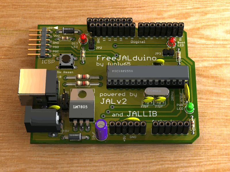

Posted: 11:08am 06 Feb 2015
  bigmik said  ...
Mik
He he, nice to have, right?
3D board in DipTrace with KiCAD 3D objects - the advantage of a common file format - maybe is the same for AutoTRAX, can someone check this?
And strictly artistic, IMO nothing beats Eagle+Eagle3D+POVray team regarding the rendering result:
The disadvantage is that it lacks the integration and is difficult to use it. And to be honest, is not an attribute of Eagle as is for AutoTRAX, KiCAD, DipTrace, etc.
Anyway, nice to have the 3D object of any components you use.

Posts: 2981
Posted: 12:48pm 06 Feb 2015
Hi Vasi,
Some of those examples are certainly brilliant WOW..
I really couldn't have cared less for 3D when I started with DEX but I am slowly coming around to it..
DEX can import 3D files in .STL format but there is no colour the preferred format is .XGL which has colour.
DEX can export 3D to .STL, Collada and Active3D formats.
The LEDs shown in my example I created from a short cylinder (for the base) a larger cylinder for the body and a sphere and adjusted them till they sat on top of each other.
PS. Playing with 3D models (creating/editting them) is a right royal pain in the A$$..
I really dont find DEX very user friendly when it comes to 3D manipulation but once the 3D model is there it is just an automatic process the 3D is there, use it or not.

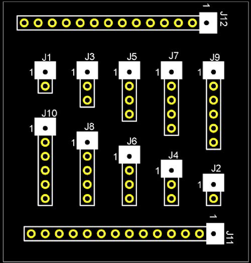

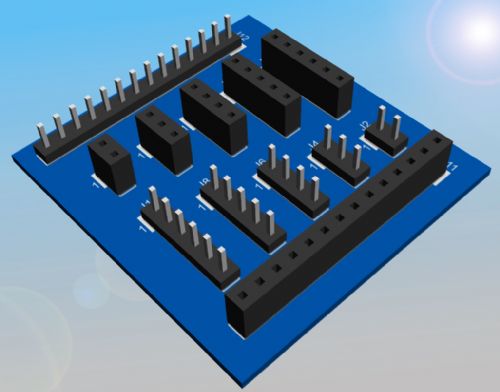

Posted: 03:52pm 13 Feb 2015
Lads,

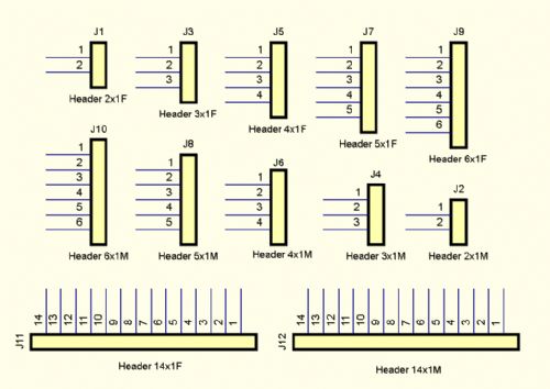

I have redone Some SIP headers for DEX to include 3D objects. As per usual these were done to suit my needs and preferences so they may not suit yours..
I have included in this pack 2pin, 3pin, 4pin, 5pin, 6pin and 14pin both Male and Female. I will add more as time permits and I will do dual row headers as well but at this stage it is only the headers that I use on my boards that I have redone.
2015-02-14_015033_Headers_SIP.zip
All of the Pin1's are actually a square pad (can't be seen under the white silkscreen) but of course you can change these on the fly if you don't want that.
viscomjim
Joined: 08/01/2014
Posts: 925
Posted: 03:29am 14 Feb 2015
Thanks Mik, these are great. The ones in DEX have small holes and this almost bit me in the A$$. These are a welcome addition!!!!!
