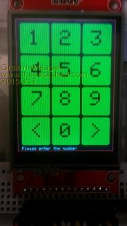

Have a couple of pieces of code for Peters great Cfunctions for the 2.4" touchscreens:
NumberPad
Sub NumberPad
I9341.fillscreen(black)
I9341.drect(0, 0, 240, 320, red)
I9341.frndrect(10, 10, 70, 70, 5, green)
I9341.pstring (30, 25, "1", 5, 0 , black, green)
I9341.frndrect(85, 10, 70 ,70, 5,green)
I9341.pstring (105, 25, "2", 5, 0 , black, green)
I9341.frndrect(160, 10, 70, 70, 5, green)
I9341.pstring (180, 25, "3", 5, 0 , black, green)
I9341.frndrect(10, 85, 70, 70, 5, green)
I9341.pstring (35, 100, "4", 5, 0 , black, green)
I9341.frndrect(85, 85, 70, 70, 5,green)
I9341.pstring (105, 100, "5", 5, 0 , black, green)
I9341.frndrect(160,85, 70, 70, 5,green)
I9341.pstring (180, 100, "6", 5, 0 , black, green)
I9341.frndrect(10, 160, 70, 70, 5,green)
I9341.pstring (35, 170, "7", 5, 0 , black, green)
I9341.frndrect(85, 160, 70, 70, 5,green)
I9341.pstring (105, 170, "8", 5, 0 , black, green)
I9341.frndrect(160, 160, 70, 70, 5,green)
I9341.pstring (180, 170, "9", 5, 0 , black, green)
I9341.frndrect(10, 235, 70, 70, 5,green)
I9341.pstring (30, 250, "<", 5, 0 , black, green)
I9341.frndrect(85, 235, 70, 70, 5,green)
I9341.pstring (105, 250, "0", 5, 0 , black, green)
I9341.frndrect(160, 235, 70, 70, 5, green)
I9341.pstring (180, 250, ">", 5, 0 , black, green)
I9341.pstring (10,310, "Please enter the number",1,0,cyan,black)
End Sub
'* Sub to identify which Number Pad Button has been pressed *
' test for 1, 2 & 3
If 150 < y0 And y0 < 550 Then 'Row 1
If 1300 < x0 And x0 < 1800 Then 'Column 1
I9341.frndrect(10, 10, 70, 70, 5, black)
I9341.frndrect(10, 10, 65, 65, 5, green)
I9341.pstring (30, 25, "1", 5, 0 , yellow, green)
Pause 200
'USE DIGIT 1
Pause 200
x0=0:y0=0
EndIf
If 800 < x0 And x0 < 1300 Then 'Column 2
I9341.frndrect(85, 10, 70, 70, 5, black)
I9341.frndrect(85, 10, 65, 65, 5, green)
I9341.pstring (105, 25, "2", 5, 0 , yellow, green)
Pause 200
'USE DIGIT 2
Pause 200
x0=0:y0=0
EndIf
If 100 < x0 And x0 < 750 Then 'Column 3
I9341.frndrect(160, 10, 70, 70, 5, black)
I9341.frndrect(160, 10, 65, 65, 5, green)
I9341.pstring (180, 25, "3", 5, 0 , yellow, green)
Pause 200
'USE DIGIT 3
Pause 200
x0=0:y0=0
EndIf
EndIf
' test for 4, 5 & 6
If 550 < y0 And y0 < 950 Then 'Row 2
I9341.frndrect(10, 85, 70, 70, 5, black)
I9341.frndrect(10, 85, 65, 65, 5, green)
I9341.pstring (35, 100, "4", 5, 0 , yellow, green)
Pause 200
'USE DIGIT 4
Pause 200
x0=0:y0=0
EndIf
I9341.frndrect(85, 85, 70, 70, 5, black)
I9341.frndrect(85, 85, 65, 65, 5, green)
I9341.pstring (105, 100, "5", 5, 0 , yellow, green)
Pause 200
'USE DIGIT 5
Pause 200
x0=0:y0=0
EndIf
I9341.frndrect(160,85, 70, 70, 5, black)
I9341.frndrect(160,85, 65, 65, 5, green)
I9341.pstring (180, 100, "6", 5, 0 , yellow, green)
Pause 200
' Use DIGIT 6
Pause 200
x0=0:y0=0
EndIf
EndIf
' test for 7, 8 & 9
If 950 < y0 And y0 < 1350 Then 'Row 3
I9341.frndrect(10, 160, 70, 70, 5, black)
I9341.frndrect(10, 160, 65, 65, 5, green)
I9341.pstring (35, 170, "7", 5, 0 , yellow, green)
Pause 200
'Use DIGIT 7
Pause 200
x0=0:y0=0
EndIf
I9341.frndrect(85, 160, 70, 70, 5, black)
I9341.frndrect(85, 160, 65, 65, 5,green)
I9341.pstring (105, 170, "8", 5, 0 , yellow, green)
Pause 200
' Use DIGIT 8
Pause 200
x0=0:y0=0
EndIf
I9341.frndrect(160, 160, 70, 70, 5, black)
I9341.frndrect(160, 160, 65, 65, 5, green)
I9341.pstring (180, 170, "9", 5, 0 , yellow, green)
Pause 200
'Use DIGIT 9
Pause 200
x0=0:y0=0
EndIf
EndIf
'Test for Last row
If 1350 < y0 And y0 < 1750 Then 'Row 4
I9341.frndrect(10, 235, 70, 70, 5, black)
I9341.frndrect(10, 235, 65, 65, 5, green)
I9341.pstring (30, 250, "<", 5, 0 , yellow, green)
Pause 200
' Use Back Symbol
Pause 200
x0=0:y0=0
EndIf
I9341.frndrect(85, 235, 70, 70, 5, black)
I9341.frndrect(85, 235, 65, 65, 5, green)
I9341.pstring (105, 250, "0", 5, 0 , yellow, green)
Pause 200
'Use 0
Pause 200
x0=0:y0=0
EndIf
I9341.frndrect(160, 235, 70, 70, 5, black)
I9341.frndrect(160, 235, 65, 65, 5, green)
I9341.pstring (180, 250, ">", 5, 0 , yellow, green)
Pause 200
'Use Enter
Pause 200
x0=0:y0=0
EndIf
EndIf 'Row 4

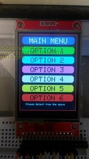

Sub MainMenu
I9341.frndrect(10, 10, 220, 30, 10, blue)
I9341.pstring(40, 15, "MAIN MENU", 3, 0, white, blue)
I9341.frndrect(10, 50, 220, 30, 10, green)
I9341.pstring(45, 55, "OPTION 1", 3, 0, black, green)
I9341.frndrect(10, 90, 220, 30, 10, cyan)
I9341.pstring(45, 95, "OPTION 2", 3, 0, black, cyan)
I9341.frndrect(10, 130, 220, 30, 10, magenta)
I9341.pstring(45, 135, "OPTION 3", 3, 0, black, magenta)
I9341.frndrect(10, 170, 220, 30, 10, white)
I9341.pstring(45, 175, "OPTION 4", 3, 0, black, white)
I9341.frndrect(10, 210, 220, 30, 10, yellow)
I9341.pstring(45, 215, "OPTION 5", 3, 0, black, yellow)
I9341.frndrect(10, 250, 220, 30, 10, red)
I9341.pstring(45, 255, "OPTION 6", 3, 0, black, red)
I9341.pstring(26, 290, "Please Select from the above", 1, 0, cyan, black)
End Sub
' Test Touch for MainMenu
If mm=1 Then
If 200 < x0 And x0 < 1820 Then
If 320 < y0 And y0 < 580 Then
I9341.pstring(26, 290,"OPTION 1",1,0,green,black)
EndIf
If 590 < y0 And y0 < 790 Then
I9341.pstring(26, 290,"OPTION 2",1,0,cyan,black)
EndIf
If 800 < y0 And y0 < 1000 Then
I9341.pstring(26, 290,"OPTION 3",1,0,magenta,black)
EndIf
If 1010 < y0 And y0 < 1210 Then
I9341.pstring(26, 290,"OPTION 4",1,0,white,black)
EndIf
If 1220 < y0 And y0 < 1430 Then
I9341.pstring(26, 290,"OPTION 5",1,0,yellow,black)
EndIf
If 1440 < y0 And y0 < 1640 Then
I9341.pstring(26, 290,"OPTION 6",1,0,red,black)
EndIf
EndIf
EndIf

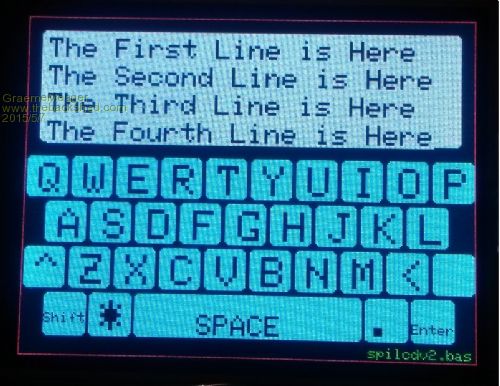

QWERTY KEYPAD (use of a pointer may be necessary)
Unlike the previous pads instead of animating the key pressed, I wanted an audio beep when each key was pressed but found that all the PWM 1 ports were in use for the LCD and the PWM 2A is being used for the backlight control. Decided to use the PWM 2B output for the beep by putting a pietzo transducer on it with the added conformation of the backlight flashing for 50mS on each pad touched. ("That's a feature not a fault !!)
Sub QwertyPad
Local integer J
Local String Q$
Q$="QWERTYUIOPASDFGHJKL^ZXCVBNM< * ."
' Q$="qwertyuiopasdfghjkl zxcvbnm< * ."
I9341.setrot(I9341_rt_left)
I9341.drect(0, 0, 320, 240, red)
For J = 1 To 10
I9341.frndrect((J*32)-30,100,29,29,3,cyan)
I9341.pstring((J*32)-22,105,Mid$(Q$,J,1),3,0,black,cyan)
Next J
For J = 1 To 9
I9341.frndrect((J*32)-16,132,29,29,3,cyan)
I9341.pstring((J*32)-7,137,Mid$(Q$,J+10,1),3,0,black,cyan)
Next J
For J = 1 To 10
I9341.frndrect((J*32)-30,164,29,29,3,cyan)
I9341.pstring((J*32)-22,169,Mid$(Q$,J+19,1),3,0,black,cyan)
Next J
For J = 1 To 2
I9341.frndrect((J*32)-15,196,30,30,3,cyan)
I9341.pstring((J*32)-7,201,Mid$(Q$,J+29,1),3,0,black,cyan)
Next J
I9341.pstring(17,210,"Shift",1,0,black,cyan)
I9341.frndrect(81,196,160,30,3,cyan)
I9341.pstring(125,210,"SPACE",2,0,black,cyan)
For J = 8 To 9
I9341.frndrect((J*32)-13,196,30,30,3,cyan)
Next J
I9341.pstring(243,201,".",3,0,black,cyan)
I9341.pstring(275,211,"Enter",1,0,black,cyan)
I9341.pstring(245,230,"spilcdv2.bas",1,0,green,black)
I9341.frndrect(10,10,300,80,3,white)
I9341.pstring(15,15,"The First Line is Here",2,0,Black,White)
I9341.pstring(15,35,"The Second Line is Here",2,0,Black,White)
I9341.pstring(15,55,"The Third Line is Here",2,0,Black,White)
I9341.pstring(15,75,"The Fourth Line is Here",2,0,Black,White)
End Sub

Hope a TBSer may find some use.

Thanks for posting that GM - really useful

Nice job Graeme - another good one for the collection.

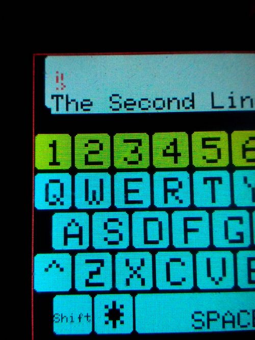

I've been 'playing' with Graeme's Qwerty pad code on the I9341 serial 2.4" screen (MX170 and MMBasic V4.6b) and added a number line. With or without the added number line though I'm getting an artifact character displaying in the first top left print position (of the "First line is here") when the T.getxy routine times out - in 'SUB QwertyTest' down near the bottom of this 2015-05-15_071924_QwertPadTest.zip file.
The shot below shows the artifact (in red) - it's always the same. Has anyone else seen this or have I missed something?

Greg, I haven't seen this sort of thing before. Interesting that it is in red as the only red I used was on the border. Could you post all of your code for perusal?

It is because after a timeout you are printing an empty string in this line:
I9341.pstring(15,15,L1$,2,0,red,white)
My code doesn't cater for null strings
To fix it change I9341.pstring as below:
[code]
SUB I9341.pstring(xx0 AS INTEGER, yy0 AS INTEGER, text$, sz AS INTEGER, orientation AS INTEGER, fontcolour AS INTEGER, backgroundcolour AS INTEGER) 'x, y coordinates of top left of first character, text string, size, orientation
if text$<>"" then
LOCAL INTEGER i=I9341draw(I9341.fpstring,I9341_AddrOfFont,xx0,yy0,sz,orientation,fontcolour,backgroundcolour,I9341_params(),text$)
endif
END SUB
[/code]

Sorry Greg, I will put that one down to grey hair rather than the grey cells. I missed the link to the code all together.
Glad Peter is on the ball

Thanks Peter, I'll give that a go. I knew it was printing an empty string but couldn't see the problem!
