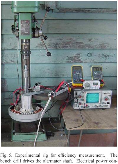

I see the CRO output voltage waveform on the last pic and Digital RMS meters. Not a bad sine wave, not real good to try and put into a battery though. The only time current can flow is when mill volts > batt volts. If you are measuring RMS V and A then you are seriously under-estimating the real peak V & A. I can not begin to predict the outcome with cheaper metering.
I also notice the use of a SparOmeter power meter. I have one of these. They under or over estimate depending on the power factor of the load.
Has anyone looked at the current waveform with a CRO for a Cap v non Cap system into a battery.

HI All I would suggest the picture of Glens F and P in a drill press has not got caps on it. Therefore get a 80s F and P , do the standard rewire 80sp put the caps on exactly as shown and then criticize.

Hi Dennis,
to be fair on Gizmo, the photo was lifted from a research paper and is not his mill. The gen is another mod of a F&P, 100S with half of the stator fingers removed. This leaves 3 phases with 7 coils in series.
My reading of the article would suggest that the 3.3uF caps across each phase and the 713rpm would equate to a cap > 100uF for an 80SP operating at half the rpm.
The paper clearly concludes that power output can be expected to increase by as much as 200% with caps, but at the expense of generator efficiency.
My conclusion is similar to gizmo, that caps change the characteristics of a mill, similar to rewiring, but simpler, but at the expense of causing a higher current to flow. The power densitity of the mill increases at the same rpm, but at the expense of a lower generator efficiency, as was stated in the article.
