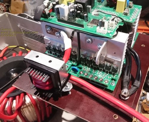

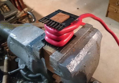

Posted: 02:23am 28 Aug 2015
A quick update. Will put together a post with more detail at a later date.

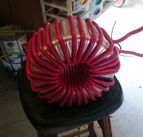

Transformer with its new primary. Red wire is 25mm square. Its heavy, thats a bar stool its sitting on so you can get an idea of the size.
The ferrite coil halves and former arrived a few days ago, this is the choke I wound. I made a hardwood timber jig to support the former so I could wind the 25mm wire, its not easy to bend.

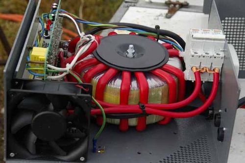

The partly assembled inverter.

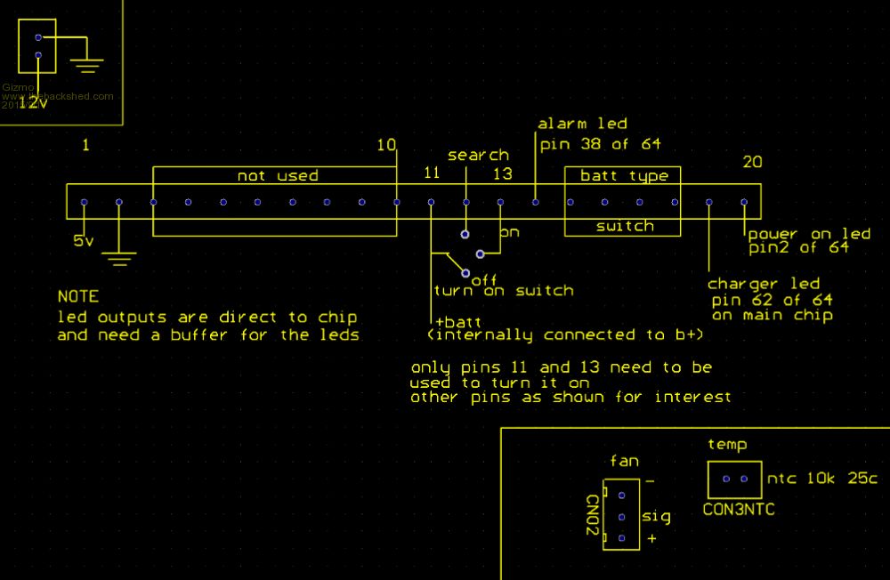

Oztules sent this to me, its the pin connections needed to get the control card to start up. I used a couple of transistors to buffer the alarm and power led outputs, will draw a circuit at a later date, but basically a 15k resistor to the base of a C548 transistor, Emitter to ground, Collector to a led via a 680ohm resistor, to +12v.

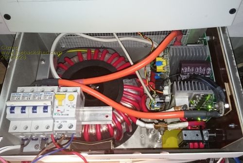

Almost finished.

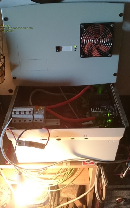

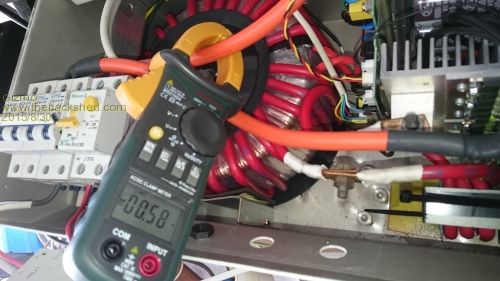

First test run. Used a 16amp breaker on the 50V input as a precaution. Had to reset it a few times as the big capacitors charged up. Inverter fired up no problem, here's its powering a 60watt bulb.
More to come in a day or two.
Edited by Gizmo 2015-09-12
Posts: 5199
Posted: 07:48pm 29 Aug 2015

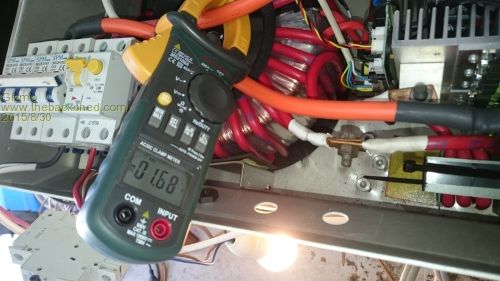

Done a little testing. During the first tests the inverter drew 1.3 amps idle ( no load on the 230vac output ), at the time the battery voltage was 58, so thats 75 watts. After reading the posts on Fieldlines, Another Power and Energy Matters, I knew I could get this value down.
Oringinally I had fitted plastic spacers between the ferrite cores, took these out and retested. Idle current dropped to .59amps at 54 volts, 32 watts
That's comparable to my expensive Latronics inverter, it draws .49 amps at idle.
Connnected up the 60watt bulb and battery current was 1.68, or 90watts. Taking into account the 30 odd watts to run the inverter, it looks like its pretty efficient under light loads, which is important.
Have to say I'm pretty happy with the results. All up the inverter owes me about $650, and should supply 3kw to 4kw continuous.
Next up is some housekeeping, tidy up a few things and add an additional fan to circulate air within the case. Then I'll wire it up with some heavy cable to the battery bank and give it a good load test.
This is the transistor LED driver I used to drive the Power and Alarm LED's.

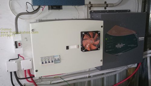

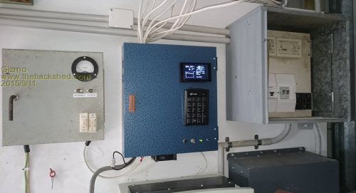

Posted: 08:05pm 10 Sep 2015
Inverter is finished. Here's a couple of pictures of my "power wall".
We have the windmill rectifier and control, the solar controller and the 240VAC power board.
And here is the 50v common connectors, new "Frankenstein" inverter and the Latronics inverter.
I've had the new inverter running off and on over the last couple of days. Only issues were a over voltage alarm when the batteries were boosted to 60v, and a shutdown due to a faulty cooling fan, the fans tac output needed a pull up resistor to give the correct signal.
The new inverter makes less noise than the Latronics, the toroidal is dead quiet, all I hear is a dull squeal from the ferrite choke.
I've updated the pin out diagram in the post further up the page. It showed pins 1 and 2 as 12v, not the case, they are 5v and should not be used as this is the same bus as the CPU. There is a 12v feed on the little 2 pin connector at the opposite end of the control board to the fan/temp connectors.

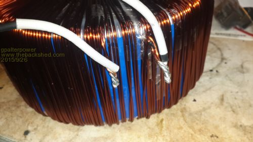

Posted: 12:13am 26 Sep 2015
Well after seeing Glenns and Bobs projects completed I truly was "inspired" ( no pun intended) . What a great job by both of you guys. I can only hope my project will turn out just as good .

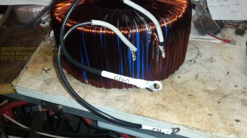

I travelled to Brizzy on the weekend and picked up the ebay 2.5 inverter for $100 along with some solar panels. Man..she..is..heavy. Couldn't wait to get it home and open it up. Even the guys at work said "That is a massive toroidal".
After removing insulation I noticed it wasn't the same as in your pics Glenn. The outer layer was only 2 in hand. Not the 4 in hand as I hoped for. Mmmm. Not an ah-ha moment... more like an OOOOH moment!. Could there be 2 types of toroidals ?Wound in reverse maybe ? Somehow I think I have a larger job ahead of me as the pics show. Any ideas? Marcus
Posts: 5199
Posted: 11:58am 26 Sep 2015
Hi Marcus
Sounds like there may be a few different transformers out there, and I got lucky.
How big is the hole in the centre? If its big enough to fit the 30 or so turns of 25mm wire ( about 9.5mm diameter including insulation ), then you could leave the existing coils in place and just wind over the top. Not as pretty, but it would work fine as far as I know.

Posts: 5199
Posted: 12:02pm 26 Sep 2015
I would also do the voltage ratio test, so you know what exactly you have there. Connect up one coil ( the 2 in hand one ) to 240vac with a 60 watt incandescent light bulb in series. If you dont use the bulb, you will blow the house circuit breakers. Measure the voltage across both coils. Be careful.
