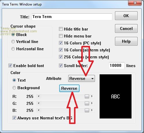

  Chris Roper said   Minor issue with OPTION COLOURCODE ON and the MX170
When in Mark Mode it is difficult to distinguish selected text from normal text.
Colour text reverts to Black but Black text is left unmarked. The differance is so subtle that it is easy to miss what is selected.
Would it be possible to have the selected block change colour, if inverting is no longer possible?
Chris
The micromite is definitely sending the "reverse" attribute.
Assuming you are using TeraTerm, you may have to change Setup/Window..
Select Text Attribute Reverse
Then set to colour to your preference.
Clicking on "reverse" will give you white text on black but you can set it to whatever you prefer.

Thanks Jim,
I had mine set to reverse with Black text on white as, I posted earlier in the thread, but I am beginning to think it is a teraterm bug rather than Micromite. I am getting inconsistent results, and each time I go back into Setup --> Window the attribute has reverted to normal :(
Then when I select text the initial line correctly inverts but reverts to black when I select a second line etc...
If it is working fine on yours could you possibly upload a copy of your TERATERM.INI file so that I can compare settings?
Chris

  Chris Roper said   and each time I go back into Setup --> Window the attribute has reverted to normal :(
Did you remember to 'save setup'?
This is my INI file (with the HOSTS list removed)
It is from a new installation and I have yet to make some tweaks to it.
2015-07-24_073643_TERATERM.zip

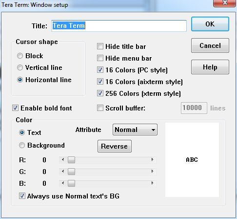

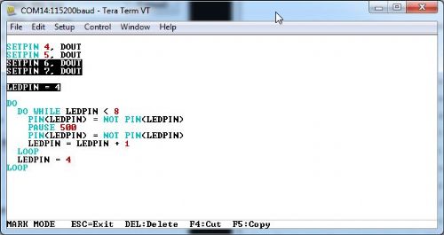

Thanks Jim,
That helped a lot, we differed on this section:
[code]
; for Reverse characters
EnableReverseAttrColor=on
VTReverseColor=255,255,255,0,0,0
; Solarized Dark
[/code]
I copied yours as above to mine, saved, restarted TeraTerm and so far it is working fine with a White Background and Black text and Reverse Highlighting.
There were a couple of other differences but not related to colour so I ignored them.
For others that may have an issue here is my ini file:
2015-07-24_081946_TERATERM.INI.zip
and a screen shot with text Selected:
Note I have Scrolling off, that is a personal preference to stop me reaching for the mouse to scroll through the editor :) old habits die hard, and I also use the Underscore Cursor.
Here is the setup screen:
I suspect the Issue was WIN7 64bit not allowing TeraTerm to update the ini file but not actually reporting an error.A manual edit with Notepad++ solved the problem. Alternatively just copy this INI file.
