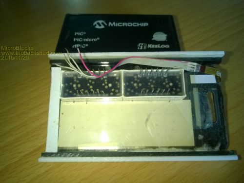

Would it be possible to only use the touch controller, like the one that is used on screens with the ili9341 controller?
I have tried to find the particular chip and only found a reference to a XPT2046 and FT6206?
Is it always the same chip or are there several with the same specs.
Posts: 3368
Posted: 12:32pm 27 Nov 2015
The touch facility can only be used in conjunction with an LCD panel - not on its own.
There are many different part numbers out there but fortunately they all seem to be compatible. I used the data sheet for the XPT2046 as my standard.
Geoff
MicroBlocks
Joined: 12/05/2012
Location: Thailand
Posts: 2209
Posted: 08:09pm 27 Nov 2015
Thanks Geoff, it will make the search for the right controller easier.
I also could do it with a few analog ports.
I asked because there are lots of replacement touchscreens available for 1-2US$.
Making your own touch keyboard can be easily made by printing out a keyboard design and put it under the touchscreen.
Like this (a samsung touch replacement with two four digit 7 segment displays and a printed 'keyboard on a piece of paper):
The sides are acrylic strips. There is enough room for a battery and a small pcb with a umite and usb charging.
It is part of a long long project. :) ( A stepper motor controller that can repeat sequences)
Edited by MicroBlocks 2015-11-29
