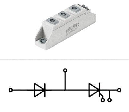

The circuits that were used back in the 60s and 70s consisted of Opto's to reset an R/C circuit and a comparitor circuit that drove the gate driver. A control voltage would be applied to select the phase angle.. This would work ok for generating DC voltages for 3 phase setups that would supply current in only one direction... They would then use Semikron SCR/Diode modules to form the main rectifier assembly...
Nowadays, they use dual SCR modules to form a "6 pulse" system so that the voltage and current can go positive or negative.. When doing battery testing, they wanted to be able to regenerate the discharge current back onto the AC line... This is where it gets tricky working in the third and fourth quadrants...

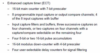

Timer input capture is ideal, because you can program that to work on either edge.
But you are going to need three input capture channels for three phase.
And if you also have three output compare channels, its then dead easy to set up any delay with maybe 1uS resolution, and make the delay the same on all three channels.
Then you are going to need at least one analog input for voltage feedback, and perhaps a second analog input for current limit.
Something like a Motorola 68HC11 or 68HC12 has all that.Edited by Warpspeed 2018-05-26

Agreed.. I would also like a "six pack" of them for the 6 pulse system needed... And it would all be done with hardware and interrupts... If they are 16 bit timers, I think the output voltage could be controlled nicely..
I would also need missing phase detection and rotation correction so that any combination of wiring errors wouldn't cause problems...
I wonder if there as a "basic" firmware core for the 6812 MPU..?? I sure would miss Geoff's working environment..!!
EDIT: Looking at the data sheet... Nice...
With 10 bit A/D's for sensing, this could just do the trick..!
And, I think I found a "Basic" compiler for it... More head scratching needed...

The input captures can be set to respond to either edge, or both edges, and of course generate an interrupt as well.
There is no substitute for starting out with a processor that has sufficient resources to do the job very easily without having to resort to desperate software tricks.

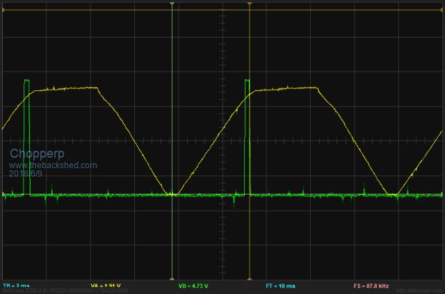

@Geoff. I tried this but could not get the PWM to reset as expected. It just kept free running. I was able to vary the pulse width OK though. (Ver 5.04.08)
I tried using a PWM 1, STOP command before issuing a new PWM command which worked but it would not accept any new parameters unless the program was stopped.
Re further suggestions:-
I found that there was too much jitter in the PULSE command above about 2.9mS. This also applied to the SETTICK commands.
The only way I could get a good steady trigger pulse was to use 4 x PULSE commands, one after the other, keeping the width below 3mS. The only problem here is with maximum delay, there is no time left for the program to do anything else before the next interrupt is due. Interrupt latency was a small issue though.
BTW, you need 100 / 120Hz trigger pulses for 50 / 60Hz single phase mains which makes things more difficult. 3 phase is out of the question I think.

My requirements are simply for a trigger pulse for an SCR generated between ~ 1mS & 10mS after a 10mS trigger interrupt. The pulse delay needs to be proportional to an input voltage from 0 to ~3V.
The photo shows a short pulse being generated triggered after about 3.5mS from the zero point in the rectified AC wave. (We have flat topped Mains here in Aussie land). The pulse was generated using several PULSE commands which is not ideal.
Zonker wants to control 3 phase which probably means 3 pulses every ~8.3mS (60Hz), each shifted 120 deg in phase.
Hope this clarifies things a bit. Thanks for any help you are able to offer.

Posts: 11881
Posted: 02:49pm 09 Jun 2018
In order to make this work there are a couple of pre-requisites. If these work for you let me know and I'll have a play
1. If you are using a MM2 then the code will be incompatible with also using IR input
2. The trigger input must be on a specific pin (15 if 28-pin MM2)
It will make things easier if I can hardcode the trigger pulse pin - let me know, also please confirm which MM you are using.

This is not a trivial exercise.
Some years ago I designed a six pulse three phase dc rectifier using a phase locked loop, but it was all done in hardware.
There are a couple of not so minor points you should be aware of. The individual SCRs may need to be continuously triggered if the dc load current is below the holding current. A single pulse may not work to latch on the SCR if there is a series choke and the dc current is fairly low. Either DC triggering, or more likely burst triggering at a few Khz may be required.
The conduction angle and firing pattern changes below 60 degrees of conduction angle.
The SCRs behave quite independently below sixty degrees. At larger conduction angles the whole thing changes and the current flows overlap. Some actual waveforms of a functioning rectifier will help a lot, but its still a somewhat mind bending exercise to fully understand what is going on.
The main thing about it being bi directional is the absence of the flywheel diode after the SCR bridge, but I am sure you know all about that already.

Posts: 11881
Posted: 10:32am 10 Jun 2018
Cfunction created which should do the job see this thread for detailsEdited by matherp 2018-06-11
