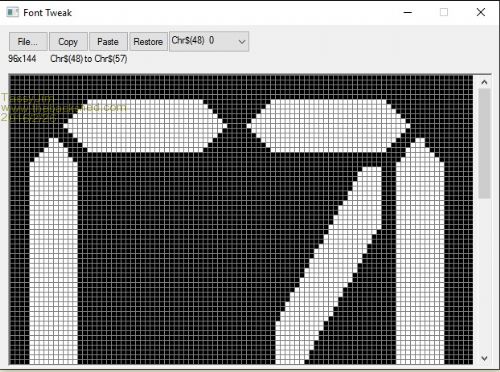

Posts: 6607
Posted: 12:46pm 25 Feb 2016
I have started work on the scrolling area.
Paste will no longer paste if there is nothing to paste.
I will eventually add the ability to add another character to the end of the existing characters
Jim.
Posts: 2991
Posted: 01:46pm 25 Feb 2016
  TassyJim said   I have started work on the scrolling area.
Jim.
Thanks so much for working on these things; I like the simplicity (hence user-friendliness) of this 'app'
You made no mention of the colour version though
WW
Posts: 6607
Posted: 07:43pm 25 Feb 2016
Scrollable area to allow for Phil's grand designs.
Also:
The 'insert' key adds a new character to the end of the set.
'delete' deletes the last character in the set - NOTE not the current displayed character. I will change that to only delete it if it IS the current character.
NEW now starts a blank set ready for 'insert'ing characters.
'insert' and 'delete' work on existing sets, not just new ones.
Please keep trying to destroy it. I don't have a TFT display setup to test the fonts on at the moment.

Posts: 3368
Posted: 11:17am 27 Feb 2016
It would be good if the special functions were also available via a dropdown menu. My Surface Pro 3 keyboard does not have an insert key
Geoff
Posts: 6607
Posted: 06:30pm 27 Feb 2016
Just for Geoff,
This update uses ctrl-X to delete the last character in the set and ctrl-N to add a new character to the end of the set.
Insert and delete still work for those of us with proper keyboards.
There is one other change. If you try to delete a character and you don't currently have the last character active, it is NOT deleted but the last character becomes the active one.
If you still accidentally delete a character, try inserting a new character. You might find that the old character has returned.

Posts: 6607
Posted: 10:49am 28 Feb 2016
The information at 'rinkydink' definitely requires multiples of 8 for the horizontal bits. There is no restriction on height.
I don't know about MMBasic requirements but I expect that you can't split bytes across characters and possibly across rows.
Padding may be required.
As far as WW's other points, I have a few things to fix.
Posts: 6607
Posted: 11:43pm 28 Feb 2016
Today's update fixes a few of WW's last list.
Not sure about item 3. I was unable to reproduce it so I might not have fixed it.
I have added two new functions.
ctrl-W will convert the loaded font into 'Wide' characters. double the width and the same height.
crtl-2 will convert the loaded font into double width and double height.
In both cases there is no attempt to smooth the results.
I will eventually make a proper panel for entering the NEW font details and proper menus.
2016-02-29_094156_FontTweak.zip
