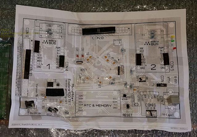

Phil23
Joined: 27/03/2016
Posts: 1667
Posted: 03:15pm 16 Aug 2016
Grog.......
Just had the knock on the front door......
Couple of E100's......
For those who haven't seen how Grog's sending them out, check this out.
I think it's pretty cool.
Thanks for the extra effort.

Posted: 07:08pm 16 Aug 2016
@Phil23
Until you try and get the parts off the paper
Watch out for the orientation of the Reset IC (MCP102G). When looking up the datasheet, on the Microchip website,use the 'G' bonding footprint. It appears that their TO92 packages aren't all equal.
@Grogs
I didn't get any LED's Never mind. I had plenty in stock.
In case anyone else runs into the same problem I experienced the following -
Connected to CON2(USB) with Teraterm and was greeted by a fast, continuously scrolling text dump comprising of the prompt, Geoff's copyright banner, Error and Invalid Character messages. Reverted to using a console connection on CON6(console). Same result. A little thought led me to believe that the problem was probably due to something wrong with the receive connection on either the USB or Console comms ports. The easiest port to fault find, and turned out to be the correct one, was the Console port. Using a multimeter, set to volts, I discovered that the TX and RX pins were both sitting at 1.24 volts. Using a multimeter, set to continuity I discovered that pins 87,88 and 89 were shorted together. Couldn't really see the bride under a magnifying glass but a few scrapes between pins, with a sharp stainless steel dental pick, cured the problem.
Looking forward to actually making the board do something

Posts: 10043
Posted: 07:26pm 16 Aug 2016
RTC module is this one here, which has on-board EEPROM.
[Quote=mikeb]Until you try and get the parts off the paper
Watch out for the orientation of the Reset IC (MCP102G). When looking up the datasheet, on the Microchip website,use the 'G' bonding footprint. It appears that their TO92 packages aren't all equal.[/Quote]
It is best to use a knife to liberate the parts. Trying to peel back the sellotape will probably rip the paper and make a mess. I taped them all on the paper like that, with the intention that you cut the parts free. If you are trying to remove the tape, then yeah - that would cause a problem. Nice to know though. Thanks. I will make sure to put a note in any future kits to that effect.
The MCP120 in TO92 footprint is available in several bondout options, yes.
It is VITAL that you use the G-bondout part for pin-compatibility.
It should be noted that there have already been requests to have this part changed to the H-bondout unit, as they are more easily obtainable apparently. I used the G-bondout part, as I had them in stock.
If there is a 1C version of the E100 board, this will probably be one of the changes made, in order to make part sourcing a bit easier for people.
