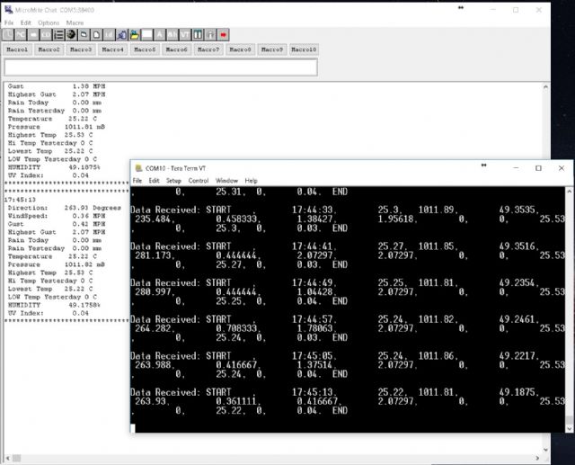

Posted: 03:42am 16 Jul 2016
Back to square 1
After sorting my head out, sorting the connections out, sorting out the broken TTL cable I've got 2 working Micromites again.
Now the tx unit is definitely 100% transmitting data on the HC-12 Wireless link
The receive HC-12 is definitely 100% receiving the data transmitted by Micromite number 1 (tested by putting the receive hc-12 on the TTL cable and reading it on the PC)
However I've got myself so confused now that I cannot display anything coming in on the receive micromite.
Can Anyone tell me "simple code" to display EVERYTHING coming in on com1 please?
As an aside - the data from the transmit unit is only transmitting ONCE every 8 seconds
(I set it so it's transmitting the received weather data)
Posts: 10043
Posted: 03:58am 16 Jul 2016
Run this:
Dim D$
Open "COM1:19200" as #1
DO
If LOC(#1)<>0 then 'If COM1 serial port buffer is NOT empty....
D$=INPUT$(LOC(#1),#1) 'then suck everything in the buffer out and stick it in D$....
Print "Data Received: ";D$ 'and print that data on the screen.
Endif
LOOP 'Do it all again.
Untested, but should work fine so long as things are hooked up right.

lew247
Joined: 23/12/2015
Posts: 1709
Posted: 06:33am 16 Jul 2016
Thank you so much Grogster (and JohnS)
I finally got it working
EDITED:
I'm a bigger idiot than I thought I was
I had the wiring of the com ports on BOTH micromites wrong!!!!!
I totally forgot that while Tx means an output from the Micromite
TX on the HC-12 means data OUT
I had it the other way round, I was connecting tx to tx like a fool and I did the same on both boards
Me thinks it's time for the Chinese to make some more money for new boards!
The white data is what the Transmitting micromite is sending but as a string of just the data
The black data is the receiving micromite working
Edited by lew247 2016-07-17
