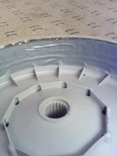

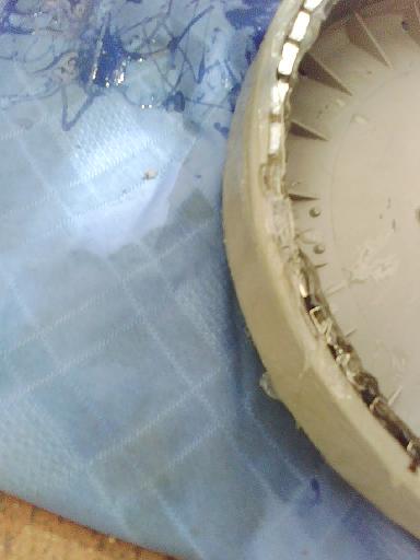

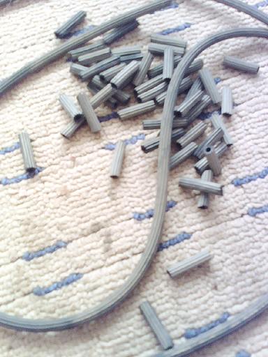

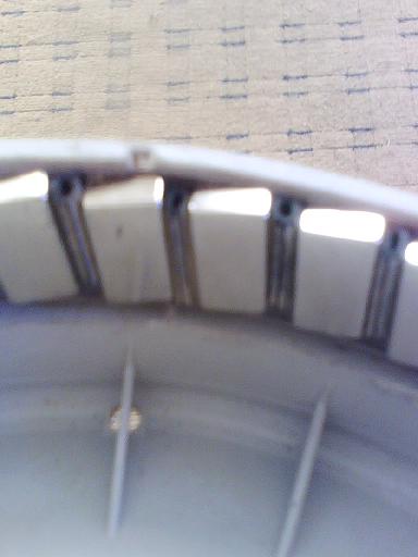

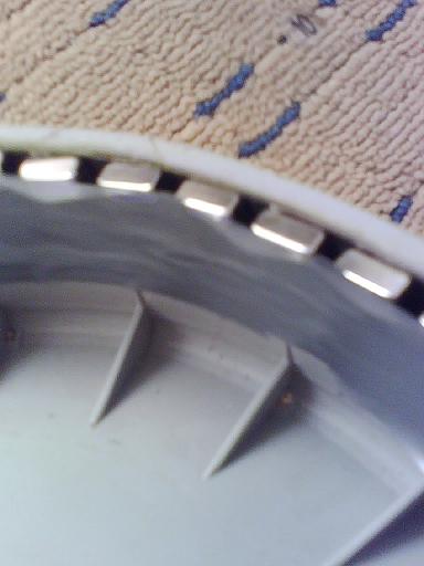

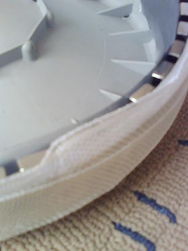

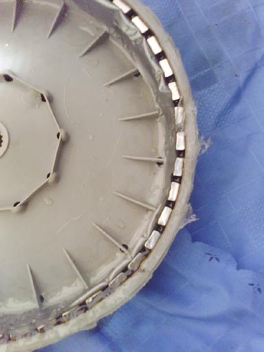

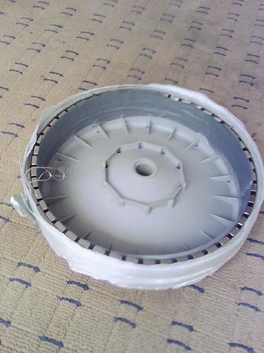

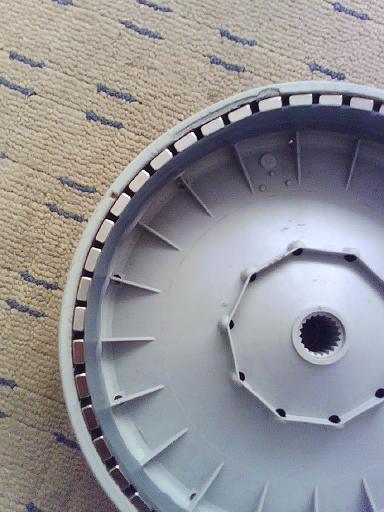

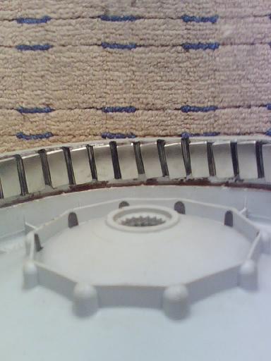

i have finaly been able to get back to my neo mod after a short break for work
i found the old rubber used for retaining the flywire in flyscreens a good size for my mod
i then formed the dam using ducktape
i then poured the resin
i also strenthened the rotor with a wrap of fiberglass cloth
its a bit messy and will need to clean up when dry
i will post a pic of the the completed unit when dry
fingers crossed for the unvieling

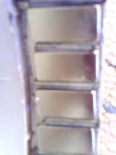

Posted: 10:35am 19 Feb 2008
Martin,
I used duct tape on an earlier project and found it blistered badly from heat and/or chemical reaction and leaked resin everywhere. What a mess. I swore never to use that again. I thought masking tape may be better as the paper would not blister like the plastic does.
Did you have any difficulties in that area? If so, what do think would be better for next time?
Your Magnet spacing looks regular and very neat. I measure the angle on the new F&P hub as 12deg to form the arrow head, so that equals 6deg across the full width. But they round the poles as well for even less cogging so it's difficult to know what will work best. What is the angle you set yours to?
We're all hoping it goes well.
Cheers Gill _Cairns, FNQ

hi guys,
you are right gill,i just removed the duct tape and the duct tape had blistered a bit leaving the finnish a bit irregular, i didnt get any leakage only where i spilt the resin whilst pouring, choice now is whether to clean up the mess or remove the magnets b4 it sets completely.
i have a lathe so if the runnout isnt too much i might just skim it and sand down to smooth.
i realy didnt set the angle i found as i mounted the magnets i could only twist so far and then the magnets rocked so i reduced the angle untill i found the best seating position without being upwright. i think i have about 6 to 8 degrees i will check with the protractor after cleanup.
the job looks good with good resin penetration thro-ought i will also do more strengthening of the outside diameter probably increase it about 5 tp 8 mm. i read someware the metal laminations are to reduce the "flux" affect from rotation magnetic field. im not sure what that is but as i am using much more stronger magnets
would extra metal bands help ballance the rotor in an electronic term not wieght/vibration?

Hi Guys
I made 3 Neo conversions some time back. The first one failed due to an out of round rotor. The second one developed problems with cracking from the resin mix .
The third one worked okay but our mills at the time were not torquey enough . It also developed a out of round fault. Anyhow some HOW TO SUGGESTIONS
1 Find some MDF/CUSTOMWOOD and use it for spacers. Make them longer than the magnets and remove after the duct tape but before the resin.
2 Cut small angled pieces of wide duct tape and put them down in line withe magnets You will need about 12 of them
3 Once you have mixed you resin put it in a sauce bottle then blow it in and you will not get any mess.

Posted: 12:53pm 19 Feb 2008
  martinjsto said   as i am using much more stronger magnets
martin
Hi Martin,
A simple way to see if extra iron is needed, is to check for a residual magnetic field on the outside of the rotor. If the field from the neo magnet is contained by the iron band in the rotor, then a thin piece of iron will not be attracted to the outside of the rotor. This can be done on a rotor OFF the splined shaft.
Any iron ring etc, may be of little electrical benefit placed on the outside of the fibreglass cloth you have laminated to the rotor.
Did other members who have done a conversion notice any external magnetic field? It is possible that the small size and thickness of the neo magnets used in the conversion results in minimal field exiting the original iron band in the rotor anyway.
I noticed with my mill, [axial flux], that the 44 x 5mm high tensile cap screws [one behind each 1" square x 0.5" thick Neo magnet], that hold the iron rings and magnets to the 0.5" thick aluminium plate rotor housing, had a slight magnetic attraction when the generator was disassembled. Upon assembly the magnetic fields strengthened and became fully contained within the rotor and no residual external field appeared on the above screws.
no external field is a good thing.
cheers, Gordon.Edited by GWatPE 2008-02-20
become more energy aware
Posted: 01:56pm 19 Feb 2008
  martinjsto said
im going to realy re-enforce the rotor on the outside I also thought of turning a bowl out of hardwood to tightly fit over the outside circumference then bonding together.
martin
Hi Martin,
The hardwood bowl is a novel idea but I think the wood grain is not oriented favourably all around to resist centrifugal forces. It might also crack from weather influences.
If I were faced with this reinforcing task I would use what the armature winders were using to restrain the wiring on large rotors. They wound a tight spiral of piano wire around, with the ends locked in place by bent over metal strip ends. The strips were placed before the wire was wound over it. The wire could then additionally be covered with glass tape and resin if you so wish.
Whatever you use, keep in mind that keeping the thing balanced is importand to minimise eccentric loading.

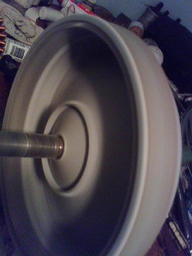

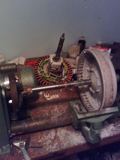

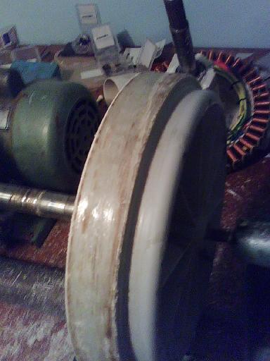

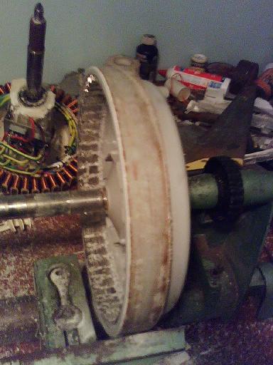

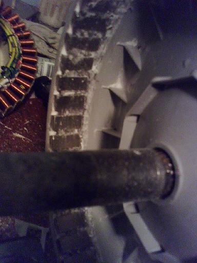

Posted: 03:11pm 20 Feb 2008
thanks for all the help guys,
i have started the priliminary machining to clean up the rotor.
i will be applying more resin and matting to the outside after cleanup and build up between machining.
setup in lathe and check for runnout, looks within 0.5mm at this stage
need to apply more resin inside as i didnt get even fill
hard to see but very little runnout or vibration at this stage

Posted: 01:31pm 21 Feb 2008
i have found that there is a definate warpage when i assemble the stator and rotor.
once about 1/3 on the unit grabs and binds up i tryed to decogg the stator to reduce adhersion but it didnt help.
i reserched the brake drums, the ones used on the 5 bolt or 6 bolt landcrusiers are 11 inch inside diameter this is 279.4 mm the rotor has an external diameter of 277mm so im going to try resining the rotor to the drum.
i will also drill pins through the complete assembly for added strenght, will post pics once i recieve the drum in about 1 week.
