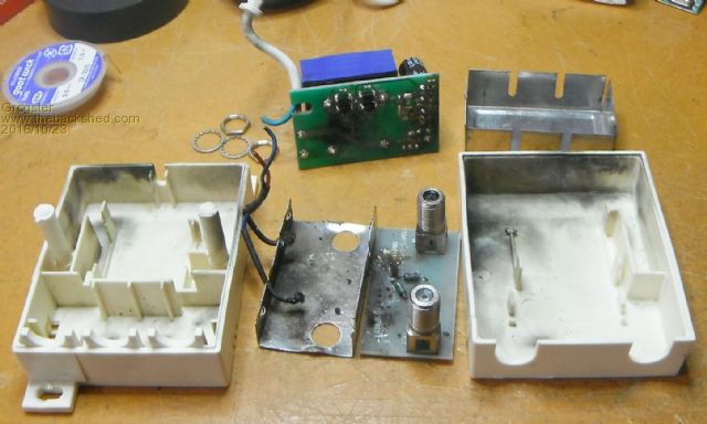

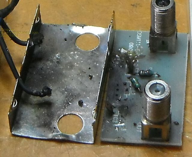

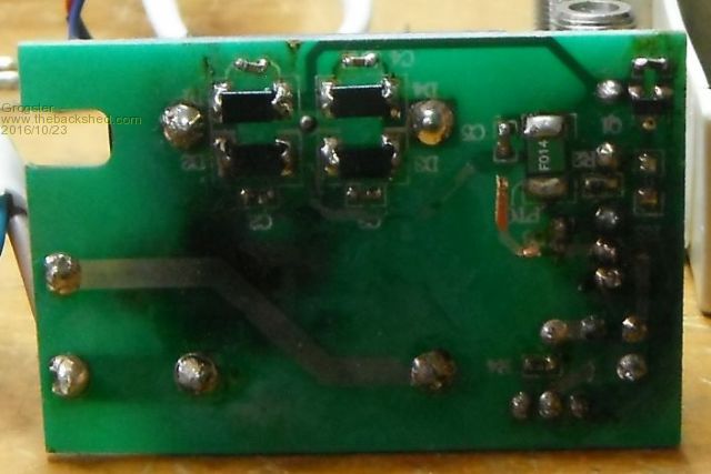

Yet another electronic device makes it's way up to silicon heaven:
That used to be a TV distribution amplifier, and this was out in the field, not even in the main complex that was hit, so the lightning has come screaming down the underground cable-TV feeds too, and did that to this amp in a completely separate building from the main one.
Wow.
I expect I will be finding new faults and replacing parts up to Christmas and probably beyond at this rate. Edited by Grogster 2016-10-24

At least you can see where the faults are.
When you are left with the intermittent faults in a few months time, you will be wondering if you can still blame the lightning.

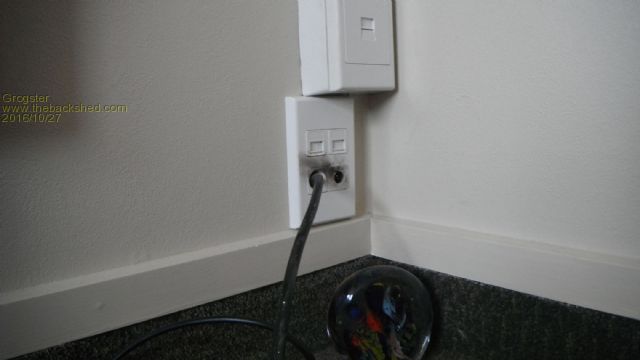

@ Phil: I was about thirty meters away from the main strike, and outside at the time, but under a car canopy outside a reception. Receptionist inside insists she saw a big blue lightning bolt shoot over the top of my head, but still under the canopy. I do not recall seeing that, and certainly did not feel any kind of contact with the discharge at all, so I am not sure if she was imagining that or not. I said it was probably my electric personality.
The main strike about thirty meters away was GIGANTIC - the biggest lightning strike I have ever seen in my life thus far. .....and it was EXTREMELY loud. Lots of people thought it was a bomb. It shook most of buildings in the area, and made windows rattle etc - it was a huge discharge.

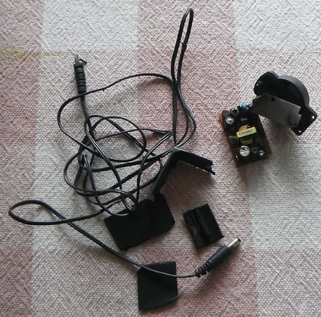

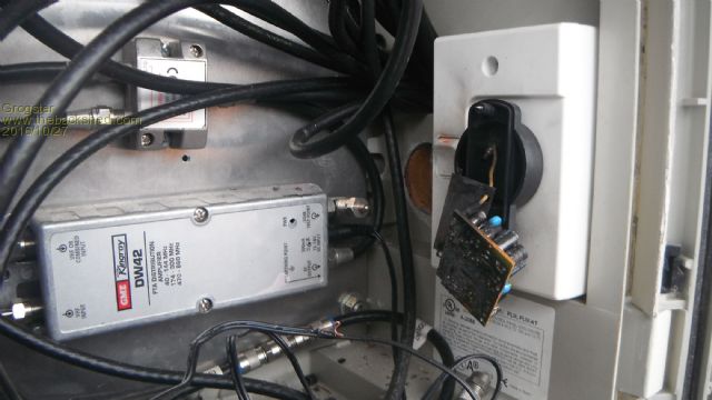

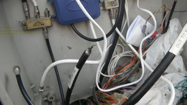

Some more carnage photos for you then:
End blown off RG11 cable-TV feed cable - this was one block of buildings over from where the main strike was.
An outlet in one of the rooms:
Another TV distribution box out in the field:
Another shot of the amp PSU carnage:

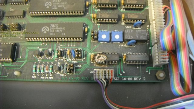

Nursecall system mainboard:
If these photos are of any interest to people, I will keep posting them as I discover damage, but I guess after a few photos, they all start to look the same eh?
MicroBlocks
Joined: 12/05/2012
Location: Thailand
Posts: 2209
Posted: 06:49am 27 Oct 2016
I am curious what kind of board is on the last picture. Are those Z80 SIO chips?
