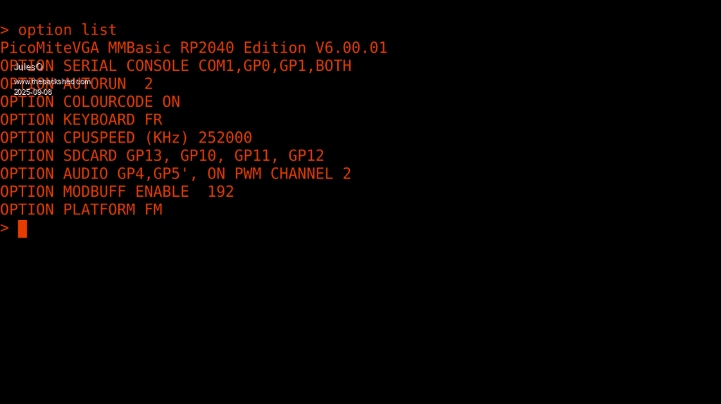

Is this of any use?
   Latest Manual said  OPTION SERIAL CONSOLE uartapin, uartbpin [,B]
Specify that the console be accessed via a hardware serial port (instead of virtual serial over USB).
‘uartapin’ and ‘uartbpin’ can be any valid pair of rx and tx pins for either COM1 or COM2. The order that they are specified is not important.
The speed defaults to 115200 baud but can be changed with OPTION BAUDRATE.
Adding the "B" parameter means output will go to "B"oth the serial port and the USB.

  phil99 said  Is this of any use?

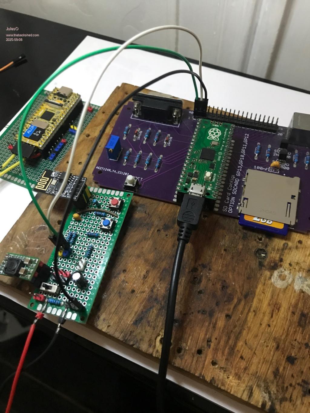

That was exactly it, thank you... I must have missed it in the manual. I was focusing on the appendix A while I was trying to talk and read the MilkVduo.
That’s what I love about the PicoMite—you can do almost anything quite easily. The feedback on ESPTerm is decent, but mmedit doesn’t really work : espterm doesn't allow you to scroll through the lines of a program.
Still, you can launch programs remotely and get feedback. Thanks again!
