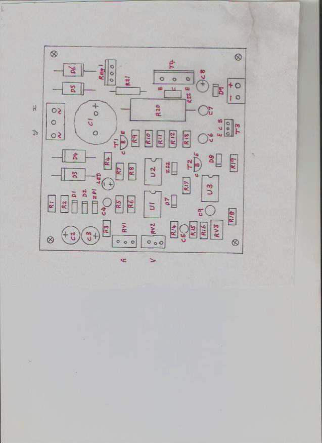

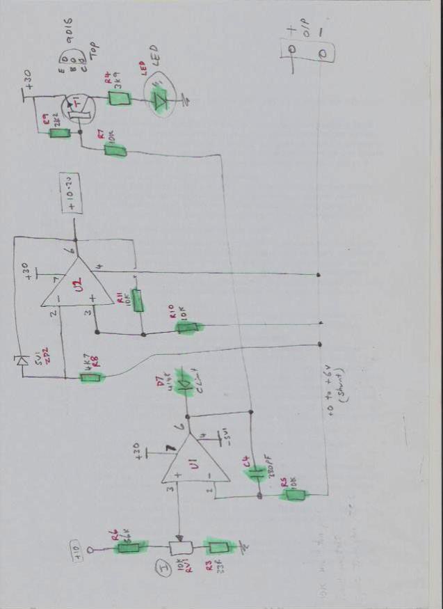

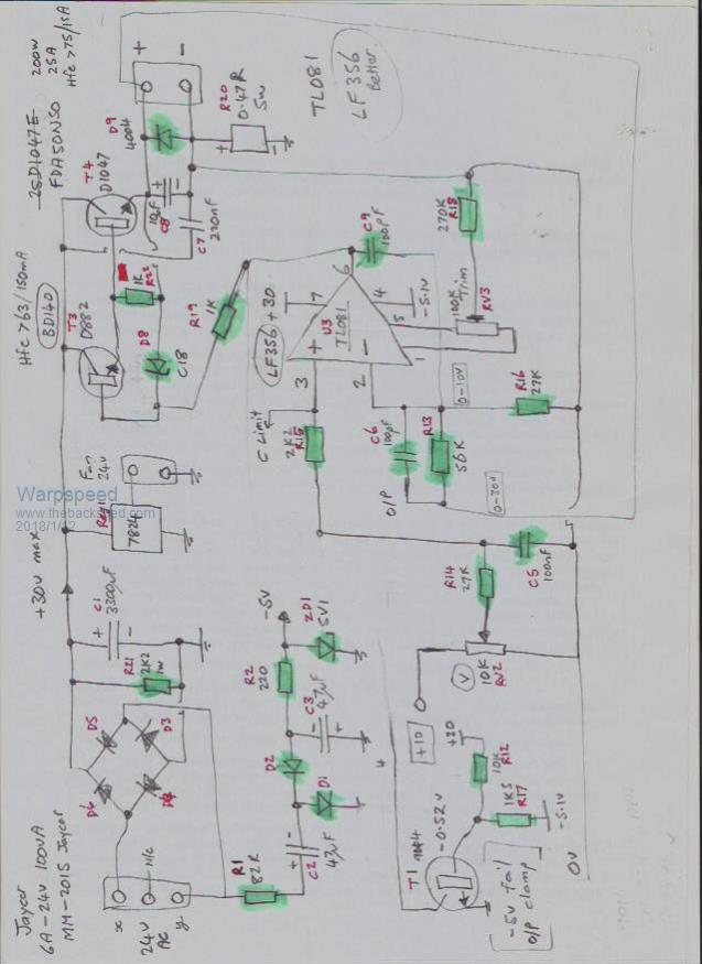

Klaus has just PM'd me asking if I have a circuit diagram for that e-bay bench power supply kit.
All I have are some nasty rough pencil sketches that I traced out the hard way.
As images cannot be attached to PMs, I will post them here, it may be of some assistance to others. I hope to eventually draw the circuit properly, but its on my fairly long to do list.
The circuit board only has component values on it, no component designators. So I had to invent my own component designators so parts on the schematic can be located on the board.
A few observations and changes that I have made to my own power supply.
The rather curious circuit round T1 is to clamp the output of U3 hard to ground if either of two things happens.
Its rather faint on my schematic, but the collector of T1 is tied solidly to U3 pin 6 output of the op amp.
If the 5.1v negative supply fails or if the 30v incoming supply is excessive.
Resistors R12 and R17 have been chosen to bias T1 off when both power rails are up and correct. If something is wrong pin 6 of U3 gets clamped to ground by T1 reducing the output from the supply to zero.
If your supply appears dead when you first power it up, check that the 30v dc rail is not too high. This could cause a lot of anxiety during the initial first test if you are not expecting it. Its actually quite clever protection.
Another thing I discovered, the 5.1 volt zeners that come in the kit are not very accurate. ZD1 does not matter, but ZD2 is fairly important, otherwise your 10.2v dc reference could be a long way out which can cause the potentiometer ranges to be out.
You will get something other than 0-30v and 0-3A if the internal 10.2v voltage reference is too far out.

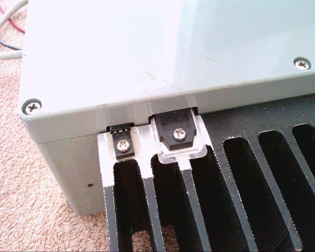

A couple of extra 22pF capacitors came in each of the five kits I now have, they are not used, and were included by mistake.
The 2SD1047E bipolar output transistor is running right on its safe operating area limit, even with an infinite heatsink. Throw it away and replace it with a nice beefy mosfet. Amazingly, that can be done without any other significant changes to the circuit.
Hint... Don't be to concerned about voltage rating or Rds on. In linear operation, Rds on has no real meaning anyway.
What you want is a real monster fet with the largest possible silicon die inside. A clue to that will be the rated power dissipation on the data sheet. The mosfet I used (simply because I had some) was an FDA50N50. Available on E-bay.
These are rated at 500v and 48 Amps, ridiculous for this, but it has a very nice juicy 625 watt power rating (at an unrealistic 25C junction temperature).
http://html.alldatasheet.com/html-pdf/90595/FAIRCHILD/FDA50N50/407/1/FDA50N50.html
That must be de-rated of course, for actual operating junction temperature, but its still a mighty big chunk of silicon inside there, which is exactly what we are looking for.
Its all about efficient heat transfer....
And that is much more important than specified voltage and current maximums for this type of application.
If you short the output, with three amps set, there will be something like 90+ watts dissipated. The original D1047 supplied in the kit will not stand that for very long.
If its just a "whoops" and you remove the output short on the power supply it will probably work fine. If you run three amps into a dead short with a big mosfet it will run like that continuously forever, as long as the heatsink and fan are large enough for 90 watts continuous dissipation.
If you do the big mosfet trick, the original base driver T3 then has almost nothing to do, and you can leave off the small heatsink.
I now have two of these supplies built and working wonderfully well, and have almost completed building three more! Just need boxes and transformers to finish these last three off, but there is no hurry.
Ten turn pots are highly recommended. Altogether pretty good value and its all been pretty well thought out by someone. The original output transistor is a bit wimpy for really heavy duty idiot proof use though.

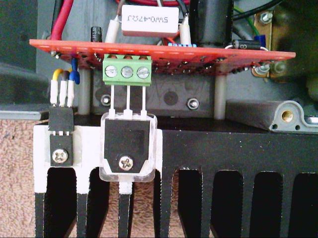

I mounted my mosfet into a three way screw terminal block. It makes replacement dead simple if it ever spits the dummy.
Ah! one detail I almost forgot.
D8 as supplied in the kit is a diode, its purpose is to discharge any capacitance on the output so that you can adjust the output up and down without any load or a bleed resistor on the power supply output. I replaced D8 with an 18 volt zener diode.
In the diode direction it performs the exact same function as the original diode.
But this new zener now also protects the mosfet gate from possibly seeing the full 30 volts under some fault conditions. If the power supply output is dead shorted, this 18v zener and resistor R19 pretty much guarantee the mosfet gate can never see more than 18v.

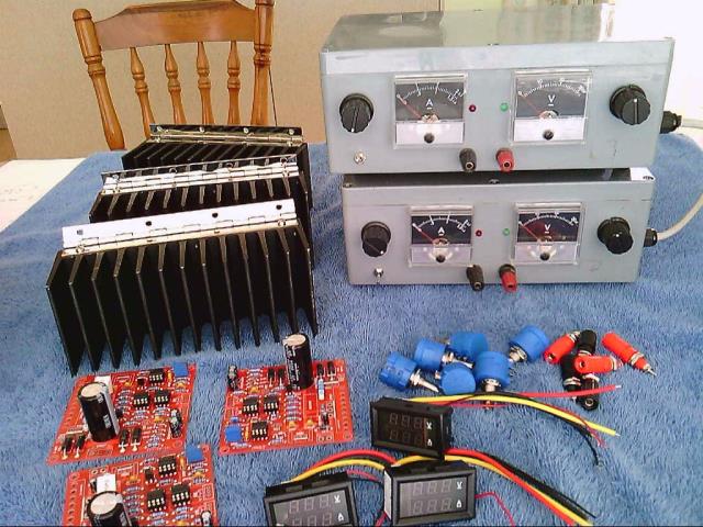

Posted: 10:36pm 12 Jan 2018
Have two going and most parts to build three more.
I wanted these to be REALLY accessible inside, and REALLY easy to fix, so the heat sinks are mounted on a hinge and fold right back exposing all the guts.
The plastic boxes are the largest size from Jaycar HB-6134 (240 x 160 x 80) and the kit PCB just mounts vertically inside exactly with zero wiggle room.
These particular boxes have been recycled and have a few extra holes here and there.
Panel meters were salvaged from a dead power supply, so the next three will have digital panel meters.
Transformer also comes from Jaycar, its MM-2015 (24v/30v 100Va).
I did try another 24v transformer I already had here, but the output voltage under no load was a bit high and the power supply over input voltage protection kicked in.
That may be a problem, but the Jaycar transformer works fine, and the exact equivalent from Altronics should work just as well.
Heatsinks are Inspire grid tie heat sinks cut down to 80mm height. An 80mm computer fan will go onto that eventually, maybe even two.

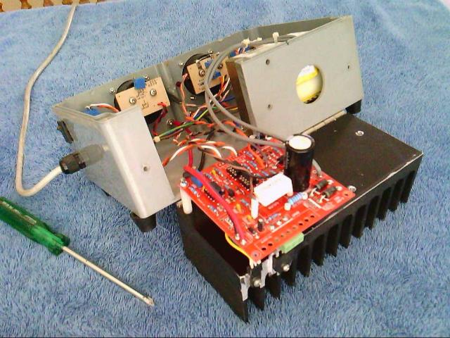

Posted: 01:56am 13 Jan 2018
  Ralph2k6 said   Very tidy! I see the IC's are on sockets too, nice.
Would you consider using spare old DC plugpacks for supply instead of transformers?
That should work, but the current may be a bit limited.
The great thing about these kits is that you can make a few changes here and there to suit your own needs.
Yes definitely IC sockets, and screw terminal block for the big mosfet. I mounted the driver transistor on the main heat sink as well, also into a socket. That was before I decided to go to a mosfet.
The next three will just have the driver transistor soldered onto the main board without its own small heatsink.
There are two resistors that can get pretty hot. R21 the 2K2 1 watt dc bleeder resistor, and of course R20 the five watt current shunt. That really suffers at three amps. I spaced both off the board on ceramic spacers.
The mosfet legs hold the top of the circuit board, two long 3mm screws with plastic spacers at the bottom can quickly release the whole board if you need to solder underneath. Its an absolutre joy to work on !
One final tip. If you decide to use these plastic boxes, the inside is studded with projecting bosses which usually just get in the way. I used to grind these away with a dremmel, but that is an awful job. One hit with a hammer and a sharp wood chisel knocks those suckers clean off. Magic, and it only takes one second to do.

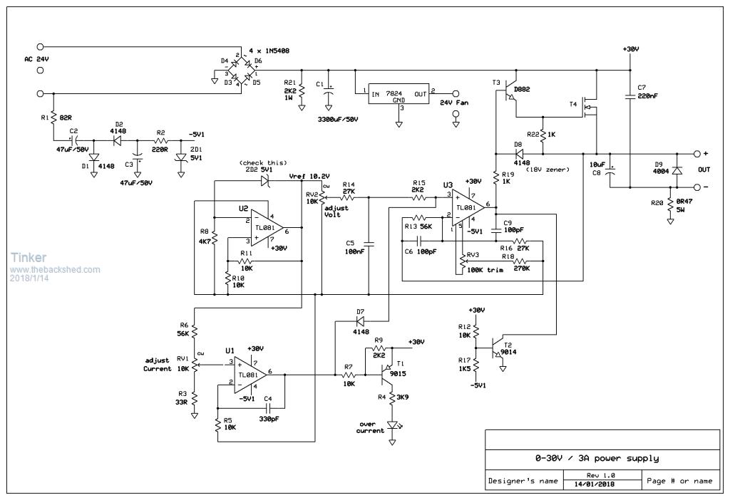

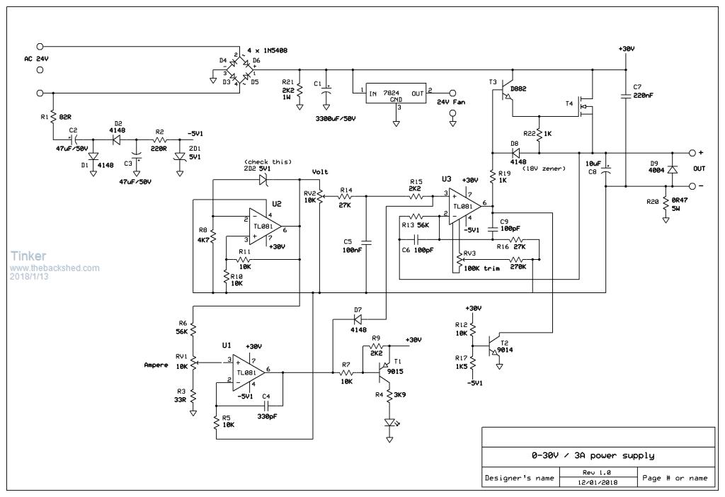

OK here is the promised drawn schematic, construed from Warpspeed's sketches.
Can you please double check it and tell me of any mistakes so I can update that schematic. Also, if you feel any other info that should be shown too.
This should make it easier to work on this board.
Posted: 07:58am 13 Jan 2018
Perfect Klaus !
And a very neat job too.
Just a reminder for everyone, this needs to be used in conjunction with the board layout sketch, because there are no component designators on the PCB itself.
Without that, it would be much more difficult to navigate, because there are many components of identical type which rather confuses things.
Posted: 09:28am 13 Jan 2018
Tony, are you telling me that you found no mistakes? That would do my ego no good at all .
The little trimpot, set it for zero output with both pots at minimum?
Posted: 08:58pm 13 Jan 2018
That trim pot RV3 does not appear to have any effect at all that I can see, even with the voltage pot set at minimum. I have not investigated that any further.
What does effect the voltage and current maximums is the 10.2v internal voltage reference (U2 pin 6) which can vary rather a lot because the 5.1v zeners supplied in the kit are not particularly accurate.
The other thing is that R20 is just a standard wire wound resistor, not a precision current shunt. The combination of a not too certain 10.2v reference and a not too certain 0.47 ohm R20 means the maximum achievable current may end up being quite a bit more or less than 3.0 exact amps.
But despite all of that, it behaves very well at startup and shut down, and the dynamic response to step load changes is pretty good.

Posted: 09:38am 14 Jan 2018
Ha, apparently none of you bothered to check this schematic! There is a glaring error on the above drawing, which I copied from warpspeed's sketch, unfortunately.
Can you spot it?
So, please disregard the above schematic, I'll attach the corrected one below.
Madness, sorry, can't do PDF. Irfanview, which I use to convert the original bitmap, refuses to save in .pdf format.
What's wrong with the .gif file anyway? Can't you just print it out?
A couple of other items relating to the component designations warpspeed posted. I did a *very* thorough check by comparing my schematic to the PCB tracks and found the following:
T3, ECB should be flipped to read BCE if this transistor is mounted on top of the PCB as per silk screen.
RV1 & RV2, label the pot leg opposite the silkscreen A & V as cw (clockwise) to get the pot rotation correct if the plug in extension wires are used.

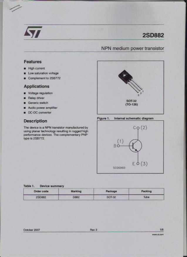

Posted: 10:23am 14 Jan 2018
Well this is something I have never seen before, its quite unique.
Klaus is quite right, but would you believe the 2SD882 data sheet I was using is wrong.
They have numbered their pins backwards, 321 instead of the usual 123.
If you cannot believe a data sheet, what can you believe ?
http://www.st.com/content/ccc/resource/technical/document/datasheet/94/f8/66/07/d9/c8/40/55/CD00062867.pdf/files/CD00062 867.pdf/jcr:content/translations/en.CD00062867.pdf
I looked at this circuit for a long time, printed out the transistor data sheets and tried to reverse engineer the whole thing. So I just assumed the data sheet had the right connections.
As for the safe operating area of the 2SD1047 output transistor, see Figure 2 in the data sheet:
http://www.st.com/content/ccc/resource/technical/document/datasheet/b3/86/80/4e/89/45/4b/6d/DM00026462.pdf/files/DM00026 462.pdf/jcr:content/translations/en.DM00026462.pdf
Thirty volts and three amps takes us right up to the maximum for dc operation.
Its not a safe design.
It has its toes hanging right over the abyss.

Posted: 12:48pm 14 Jan 2018
Tony, I looked up that datasheet too but see nothing wrong there with the pins.
Perhaps the confusion lies with the transistor orientation, it has the heat sink surface toward the PCB edge, not facing in as the datasheet picture shows.
Gary, perhaps you are not familiar with the Express PCB schematic program I use to draw this.
It lets me print to my printer and does that automatically as soon as I hit the 'print' button. There is no file I could access (AFAIK)ready for me with that process.
The only way I can save the document other than a .sch file is exporting it as a bitmap. Edited by Tinker 2018-01-15
