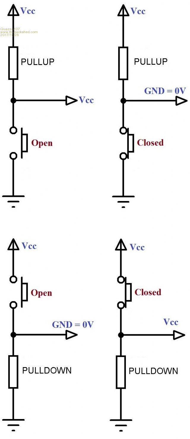

Just a thought can you go the other way
do PULLDOWN and have the switch goto 3.3v
and look for a high or Interrupt on low input
to high.

  Quazee137 said   Just a thought can you go the other way do PULLDOWN and have the switch goto 3.3v and look for a high or Interrupt on low input to high.
Sure, that would work, sort of. But, in the big picture, none of these "Fixes" to a flawed circuit will cut it in the long run.

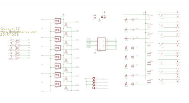

Sometimes you need to look for a high as
in this
rallyman's problem
they talked about using the pulldown of the pin and look for a low to high.
and one more
dipswitch
Edited by Quazee137 2017-10-29

I used to use pulldown resistors, and have the switch(sensor or otherwise) pull the input high to trip it, but I swapped and went the other way a few years ago because of a PICAXE project that would false-trip with that arrangement, as that was a system that used 4-core security wire as a 12v bus and a trip line, and it was discoivered that inductive coupling from neaby mains cables under load in the roofspace, coupled into the cable and was causing the input to see that induced voltage as a high, and would respond in kind.
...so I changed to grounding the input pins, as induced voltage is not a problem in that arrangement(generally). Here we go again......

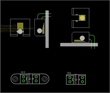

Posted: 12:25am 29 Oct 2017
May be trying a sealed version will work keeping all else the same.
tilt sw
or
tilt sw 2
the problem may be only in the switch being unsealed.
