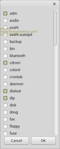

I am in the same boat as Palcal - learning to utilise Mint as my platform to talk to my 'mite family.
I can successfully talk to them all on their relevant USB or ACM ports with no problems using putty.
I have wine installed and can get MMedit up and running - can load and save files OK.
I am a member of the dialout group.
I have created the symlinks in .wine/dosdevices to connect com3 to ttyACM0 (I can talk to ttyACM0 with putty just fine)
However, when I click on the MMChat menu icon, the Chat screen comes up but also brings up a "Cannot Connect to COM port" error.
Any suggestions anyone?

Thanks for the reply Jim, everything is actually working with putty and in fact MMedit loads up and I can load and save programs no problem. The only problem I have is connecting to the 'mites from MMChat (or MMfile).

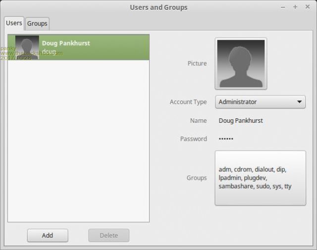

I have set up the symlinks in dosdevices and am a member of dialout and sys groups.

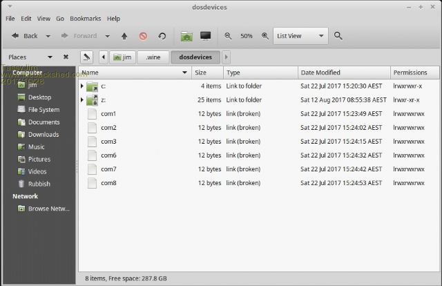

Posts: 6606
Posted: 03:32pm 27 Oct 2017
At the risk of leading you further astray, this is what I see in my dosdevices folder with NOTHING plugged in.
All links are listed as 'broken'
When I plug in one 'mite and refresh the display, the first port becomes active.
The device I plugged in uses a standard USB port so com1 is linked to /dev/ttyUSB0
If I had used a 'mite that comes up as ttyACM0, it would have been com6 that became active.
Until you can see a link to character device in the dosdevices folder, it is no use trying MMEdit.
Comparing the permissions for broken and linked might help too.
I don't pretend to know much about Linux, especially the GUI stuff.

BINGO - up and running MMedit with all features!
Some notes on my experience - some of these "suggestions" may offend/concern Linux purists and may not be considered "best practice" but they worked for me. Note that I am using Mint 17 as a workshop machine with myself as the only user.
A number of my issues eventually came down to permissions. In true "bull in a china shop" I took to Mint with a sledgehammer!
For putty, as well as being a member of the group dialout I start the program with
doug@dougMint17 ~ $sudo putty
I found the sudo is necessary in order to save configurations - again there is a permissions issue that I have yet to find but the above works as a "workaround" until I figure out what permissions need changing to save configs. You shrink the terminal screen so you dont see all the GLib error messages which I have no idea what they are about but don't seem to affect operation.
A cleaner solution is to create a launcher on the desktop which will hide the startup terminal.
Putty is now working fully with both ACM and USB devices. I have saved a number of configurations and by using the Ctrl Right Mouse button to bring up the Settings menu, I can either modify the existing settings or start another session such that I can have two putty sessions side by side to talk to two different 'mites.

Posts: 6606
Posted: 04:05pm 27 Oct 2017
  panky said
doug@dougMint17 ~ $ ln -s /dev/ttyACM0 ~/.wine/dosdevices/com7
doug@dougMint17 ~ $ ln -s /dev/ttyUSB0 ~/.wine/dosdevices/com8
doug@dougMint17 ~ $ ls -a -l ~/.wine/dosdevices
total 8
drwxrwxrwx 2 doug doug 4096 Oct 28 12:15 .
drwxrwxrwx 4 doug doug 4096 Oct 28 10:49 ..
lrwxrwxrwx 1 doug doug 10 Oct 25 12:37 c: -> ../drive_c
lrwxrwxrwx 1 doug doug 10 Oct 28 10:48 com1 -> /dev/ttyS0
lrwxrwxrwx 1 doug doug 12 Oct 28 10:44 com11 -> /dev/ttyACM0
lrwxrwxrwx 1 doug doug 10 Oct 28 10:48 com2 -> /dev/ttyS1
lrwxrwxrwx 1 doug doug 12 Oct 28 10:46 com3 -> /dev/ttyUSB0
lrwxrwxrwx 1 doug doug 12 Oct 28 10:46 com4 -> /dev/ttyUSB1
lrwxrwxrwx 1 doug doug 12 Oct 28 10:46 com5 -> /dev/ttyACM0
lrwxrwxrwx 1 doug doug 12 Oct 28 12:14 com7 -> /dev/ttyACM0
lrwxrwxrwx 1 doug doug 12 Oct 28 12:15 com8 -> /dev/ttyUSB0
lrwxrwxrwx 1 doug doug 8 Oct 25 12:38 d:: -> /dev/sr0
lrwxrwxrwx 1 doug doug 21 Oct 28 10:48 e: -> /media/doug/8FE6-2DA1
lrwxrwxrwx 1 doug doug 14 Oct 28 10:11 e:: -> /dev/mmcblk0p1
lrwxrwxrwx 1 doug doug 12 Oct 28 10:11 f:: -> /dev/mmcblk0
lrwxrwxrwx 1 doug doug 1 Oct 25 12:37 z: -> /
doug@dougMint17 ~ $
Any reason for having com11, com5 and com7 all linking to ttyACM0
Likewise com3 and com8 linked to ttyUSB0
JimEdited by TassyJim 2017-10-29

@palcal
Paul,
The best way to add yourself to the dialout group is to open up the Users and Groups window.
Do this by selecting Menu (bottom left of screen) then up to All Applications. Scroll down to Users and Groups. Selecting this will open a window asking for your password. You will then find yourself in the User and Groups window. Click on yourself then select the tab Groups at the top. You will now see a list of groups you belong to on the right of the window.
Click on the list there which will bring up a window of groups you belong to and you can select additional groups as needed. Select dialout and then OK.
You are now a member of dialout. Close Users and Groups.
This was all I needed to do for both putty and MMedit.

@jim
No special reason Jim other than my 144 pin MMX board shows up as COM11 under windows. I thought there may have been something special that required it to be linked in Mint the same however that is not the case. I have just kept it as com11 purely for consistency. I have tested and it could by 5 or 7 or anything else - they all work.
In fact I found you can have multiple com ports sym linked to the same ttyACM port if you choose to.
Doug.

@Panky
Did what you said and added the dialout group but when I open Users and Groups I get my name but the right hand pane is completely blank, no picture, account type, name or anything and Putty still no go.
Paul.
